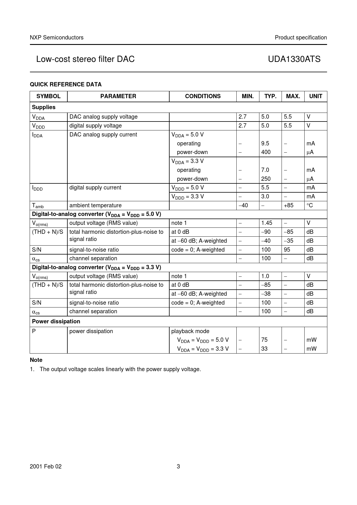

QUICK REFERENCE DATA. SYMBOL. PARAMETER. CONDITIONS. MIN. TYP. MAX. UNIT. Supplies. Digital-to-analog converter (VDDA = VDDD = 5.0 V)
QUICK REFERENCE DATA SYMBOL PARAMETER CONDITIONS MIN TYP MAX UNIT Supplies Digital-to-analog converter (VDDA = VDDD = 5.0 V)
link to page 3 link to page 3 NXP Semiconductors Product specification Low-cost stereo filter DAC UDA1330ATS
QUICK REFERENCE DATA SYMBOL PARAMETER CONDITIONS MIN. TYP. MAX. UNIT Supplies
VDDA DAC analog supply voltage 2.7 5.0 5.5 V VDDD digital supply voltage 2.7 5.0 5.5 V IDDA DAC analog supply current VDDA = 5.0 V operating − 9.5 − mA power-down − 400 − μA VDDA = 3.3 V operating − 7.0 − mA power-down − 250 − μA IDDD digital supply current VDDD = 5.0 V − 5.5 − mA VDDD = 3.3 V − 3.0 − mA Tamb ambient temperature −40 − +85 °C
Vo(rms) output voltage (RMS value) note 1 − 1.45 − V (THD + N)/S total harmonic distortion-plus-noise to at 0 dB − −90 −85 dB signal ratio at −60 dB; A-weighted − −40 −35 dB S/N signal-to-noise ratio code = 0; A-weighted − 100 95 dB αcs channel separation − 100 − dB
Digital-to-analog converter (VDDA = VDDD = 3.3 V)
Vo(rms) output voltage (RMS value) note 1 − 1.0 − V (THD + N)/S total harmonic distortion-plus-noise to at 0 dB − −85 − dB signal ratio at −60 dB; A-weighted − −38 − dB S/N signal-to-noise ratio code = 0; A-weighted − 100 − dB αcs channel separation − 100 − dB
Power dissipation
P power dissipation playback mode VDDA = VDDD = 5.0 V − 75 − mW VDDA = VDDD = 3.3 V − 33 − mW
Note
1. The output voltage scales linearly with the power supply voltage. 2001 Feb 02 3 Document Outline Features General Multiple format input interface DAC digital sound processing Advanced audio configuration Applications General description Ordering information Quick reference data Block diagram Pinning Functional description System clock Application modes Multiple format input interface Interpolation filter (DAC) Noise shaper Filter stream DAC Pin compatibility L3 interface Address mode Data transfer mode Registers Programming the features Limiting values Handling Thermal characteristics Quality specification DC characteristics AC characteristics Timing Application information Package outline Soldering Introduction to soldering surface mount packages Reflow soldering Wave soldering Manual soldering Suitability of surface mount IC packages for wave and reflow soldering methods Data sheet status Disclaimers
