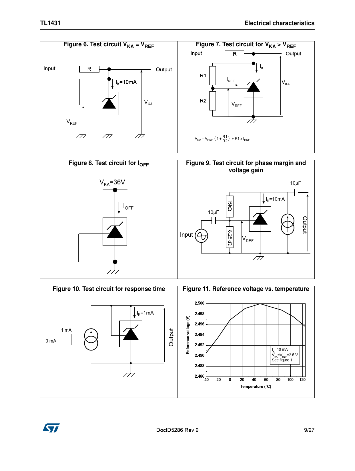

Pages / Page27 / 9 — TL1431. Electrical characteristics. Figure 6. Test circuit VKA = VREF. …
File Format / SizePDF / 710 Kb
TL1431. Electrical characteristics. Figure 6. Test circuit VKA = VREF. Figure 7. Test circuit for VKA > VREF
TL1431 Electrical characteristics Figure 6 Test circuit VKA = VREF Figure 7 Test circuit for VKA > VREF
TL1431 Electrical characteristics Figure 6. Test circuit VKA = VREF Figure 7. Test circuit for VKA > VREF
Input R Output Input R I Output K R1 I IREF K=10mA VKA V R2 KA VREF VREF V   KA = VREF 1 R1 + ---- + R1 x IREF R2
Figure 8. Test circuit for IOFF Figure 9. Test circuit for phase margin and voltage gain
VKA=36V 10F 15 I =10mA K I k OFF 10F Ou tp 8.2 ut Input 5k VREF
Figure 10. Test circuit for response time Figure 11. Reference voltage vs. temperature 2.500
I =1mA K
2.498 ) V e (
t
g 2.496
1 mA u
ta
tp
2.494
0 mA
ce vol
Ou
n re 2.492 fe e
I =10 mA K
R 2.490
V =V =2.5 V KA REF See figure 1
2.488 2.486-40 -20 0 20 40 60 80 100 120 Temperature (°C)
