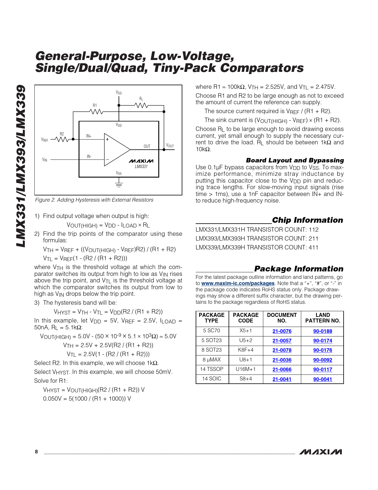

where R1 ≈ 100kΩ, VTH = 2.525V, and VTL = 2.475V. VDD Choose R1 and R2 to be large enough as not to exceed RL the amount of current the reference can supply. R1 The source current required is VREF / (R1 + R2). The sink current is (VOUT(HIGH) - VREF) ✕ (R1 + R2). VDD Choose RL to be large enough to avoid drawing excess R2 IN+ current, yet small enough to supply the necessary cur- VREF rent to drive the load. RL should be between 1kΩ and VOUT OUT 10kΩ. IN- VIN

LMX331 Use 0.1µF bypass capacitors from VDD to VSS. To max- VSS imize performance, minimize stray inductance by putting this capacitor close to the VDD pin and reduc- ing trace lengths. For slow-moving input signals (rise time > 1ms), use a 1nF capacitor between IN+ and IN- Figure 2. Adding Hysteresis with External Resistors to reduce high-frequency noise. 1) Find output voltage when output is high:

VOUT(HIGH) = VDD - ILOAD ✕ RL LMX331/LMX331H TRANSISTOR COUNT: 112 2) Find the trip points of the comparator using these LMX393/LMX393H TRANSISTOR COUNT: 211
LMX331/LMX393/LMX339
formulas: V LMX339/LMX339H TRANSISTOR COUNT: 411 TH = VREF + ((VOUT(HIGH) - VREF)R2) / (R1 + R2) VTL = VREF(1 - (R2 / (R1 + R2))) where VTH is the threshold voltage at which the com-

. Note that a “+”, “#”, or “-” in which the comparator switches its output from low to the package code indicates RoHS status only. Package draw- high as VIN drops below the trip point. ings may show a different suffix character, but the drawing per- 3) The hysteresis band will be: tains to the package regardless of RoHS status. VHYST = VTH - VTL = VDD(R2 / (R1 + R2))

In this example, let VDD = 5V, VREF = 2.5V, ILOAD =

50nA, RL = 5.1kΩ: 5 SC70 X5+1

VOUT(HIGH) = 5.0V - (50 ✕ 10-9 ✕ 5.1 ✕ 103Ω) ≈ 5.0V 5 SOT23 U5+2

VTH = 2.5V + 2.5V(R2 / (R1 + R2)) 8 SOT23 K8F+4

VTL = 2.5V(1 - (R2 / (R1 + R2))) 8 µMAX U8+1

Select R2. In this example, we will choose 1kΩ. Select V 14 TSSOP U16M+1

HYST. In this example, we will choose 50mV. Solve for R1: 14 SOIC S8+4

VHYST = VOUT(HIGH)(R2 / (R1 + R2)) V 0.050V = 5(1000 / (R1 + 1000)) V
