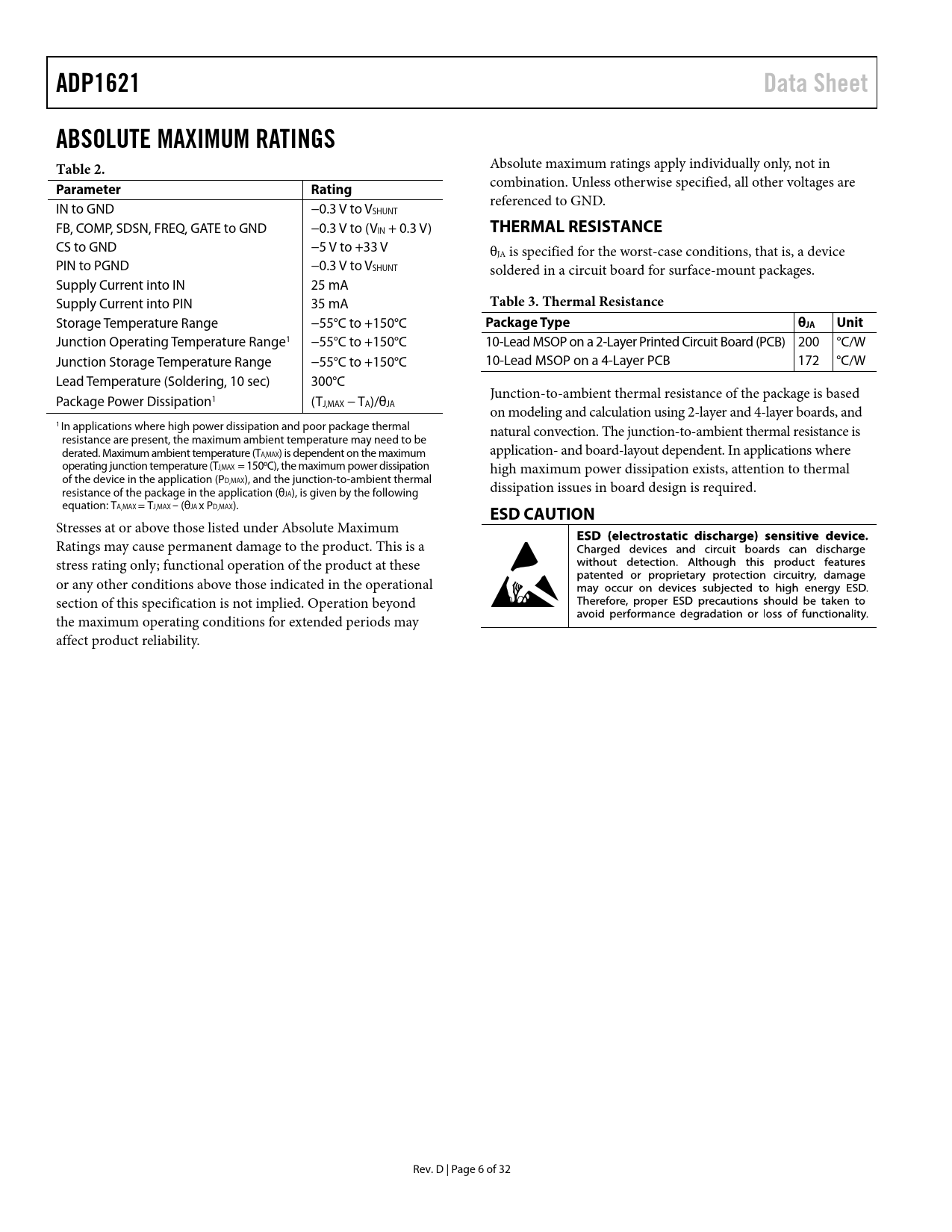

ADP1621. Data Sheet. ABSOLUTE MAXIMUM RATINGS Table 2. Parameter. Rating. THERMAL RESISTANCE. Table 3. Thermal Resistance
ADP1621 Data Sheet ABSOLUTE MAXIMUM RATINGS Table 2 Parameter Rating THERMAL RESISTANCE Table 3 Thermal Resistance
ADP1621 Data Sheet ABSOLUTE MAXIMUM RATINGS Table 2.
Absolute maximum ratings apply individually only, not in
Parameter Rating
combination. Unless otherwise specified, all other voltages are referenced to GND. IN to GND −0.3 V to VSHUNT FB, COMP, SDSN, FREQ, GATE to GND −0.3 V to (VIN + 0.3 V)
THERMAL RESISTANCE
CS to GND −5 V to +33 V θJA is specified for the worst-case conditions, that is, a device PIN to PGND −0.3 V to VSHUNT soldered in a circuit board for surface-mount packages. Supply Current into IN 25 mA Supply Current into PIN 35 mA
Storage Temperature Range −55°C to +150°C
Package Type θJA Unit
Junction Operating Temperature Range1 −55°C to +150°C 10-Lead MSOP on a 2-Layer Printed Circuit Board (PCB) 200 °C/W Junction Storage Temperature Range −55°C to +150°C 10-Lead MSOP on a 4-Layer PCB 172 °C/W Lead Temperature (Soldering, 10 sec) 300°C Package Power Dissipation1 (T Junction-to-ambient thermal resistance of the package is based J,MAX − TA)/θJA on modeling and calculation using 2-layer and 4-layer boards, and 1 In applications where high power dissipation and poor package thermal natural convection. The junction-to-ambient thermal resistance is resistance are present, the maximum ambient temperature may need to be derated. Maximum ambient temperature (TA,MAX) is dependent on the maximum application- and board-layout dependent. In applications where operating junction temperature (TJ,MAX = 150oC), the maximum power dissipation high maximum power dissipation exists, attention to thermal of the device in the application (PD,MAX), and the junction-to-ambient thermal resistance of the package in the application (θ dissipation issues in board design is required. JA), is given by the following equation: TA,MAX = TJ,MAX – (θJA x PD,MAX).
