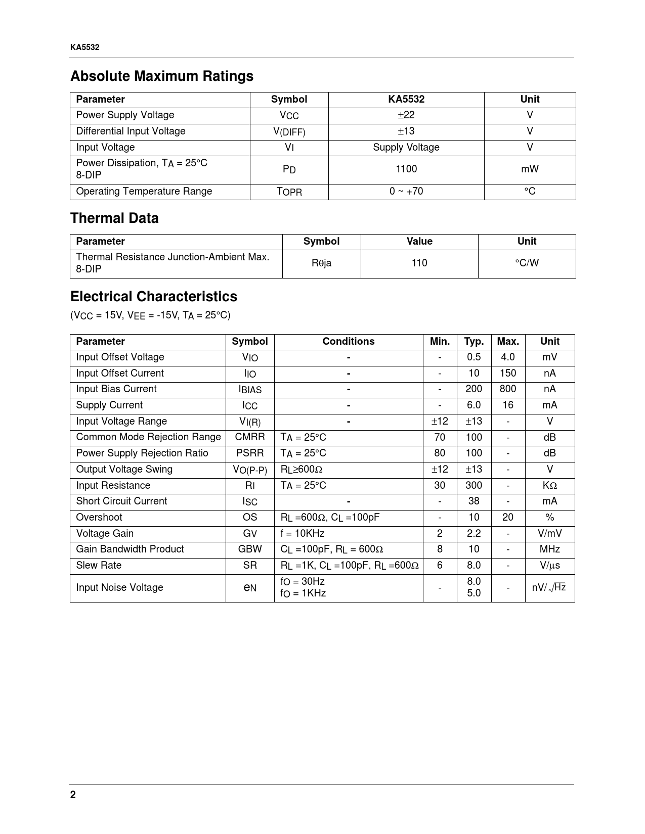

ManufacturerFairchild
DescriptionDual Operational Amplifier
Pages / Page6 / 2 — KA5532. Absolute Maximum Ratings. Parameter. Symbol. Unit. Thermal Data. …
File Format / SizePDF / 87 Kb
KA5532. Absolute Maximum Ratings. Parameter. Symbol. Unit. Thermal Data. Value. Electrical Characteristics. Conditions. Min. Typ. Max
KA5532 Absolute Maximum Ratings Parameter Symbol Unit Thermal Data Value Electrical Characteristics Conditions Min Typ Max
KA5532 Absolute Maximum Ratings Parameter Symbol KA5532 Unit
Power Supply Voltage VCC ±22 V Differential Input Voltage V(DIFF) ±13 V Input Voltage VI Supply Voltage V Power Dissipation, TA = 25°C PD 1100 mW 8-DIP Operating Temperature Range TOPR 0 ~ +70 °C
Thermal Data Parameter Symbol Value Unit
Thermal Resistance Junction-Ambient Max. Rθja 110 °C/W 8-DIP
(VCC = 15V, VEE = -15V, TA = 25°C)
Parameter Symbol Conditions Min. Typ. Max. Unit
Input Offset Voltage VIO
- 0.5 4.0 mV Input Offset Current IIO
- 10 150 nA Input Bias Current IBIAS
- 200 800 nA Supply Current ICC
- 6.0 16 mA Input Voltage Range VI(R)
±12 ±13 - V Common Mode Rejection Range CMRR TA = 25°C 70 100 - dB Power Supply Rejection Ratio PSRR TA = 25°C 80 100 - dB Output Voltage Swing VO(P-P) RL≥600Ω ±12 ±13 - V Input Resistance RI TA = 25°C 30 300 - KΩ Short Circuit Current ISC
- 38 - mA Overshoot OS RL =600Ω, CL =100pF - 10 20 % Voltage Gain GV f = 10KHz 2 2.2 - V/mV Gain Bandwidth Product GBW CL =100pF, RL = 600Ω 8 10 - MHz Slew Rate SR RL =1K, CL =100pF, RL =600Ω 6 8.0 - V/µs fO = 30Hz 8.0 Input Noise Voltage eN - - nV/ Hz fO = 1KHz 5.0
