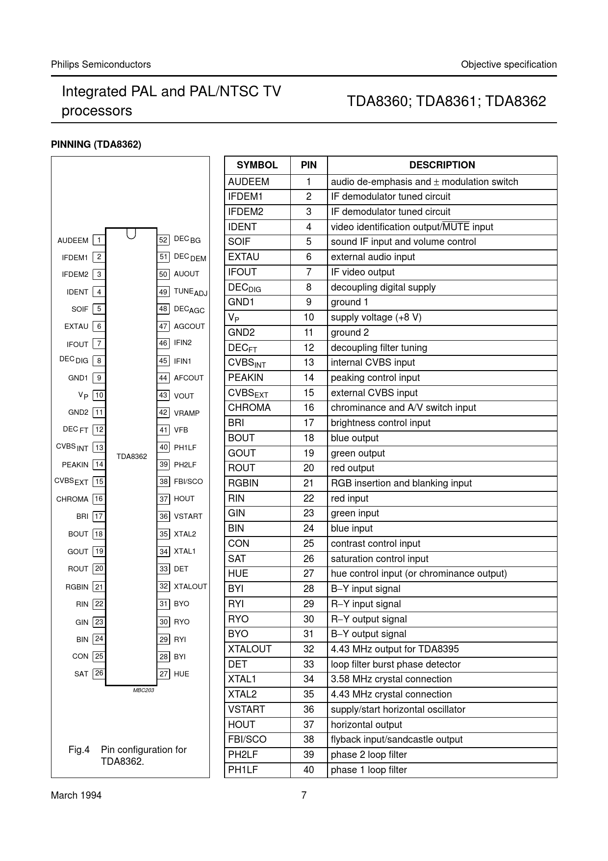

PINNING (TDA8362). SYMBOL. PIN. DESCRIPTION
Philips Semiconductors Objective specification Integrated PAL and PAL/NTSC TV TDA8360; TDA8361; TDA8362 processors
PINNING (TDA8362) SYMBOL PIN DESCRIPTION
AUDEEM 1 audio de-emphasis and ± modulation switch IFDEM1 2 IF demodulator tuned circuit IFDEM2 3 IF demodulator tuned circuit IDENT 4 video identification output/MUTE input AUDEEM 1 52 DEC BG SOIF 5 sound IF input and volume control IFDEM1 2 51 DEC DEM EXTAU 6 external audio input IFDEM2 3 50 AUOUT IFOUT 7 IF video output DEC IDENT 4 49 TUNE DIG 8 decoupling digital supply ADJ GND1 9 ground 1 SOIF 5 48 DECAGC VP 10 supply voltage (+8 V) EXTAU 6 47 AGCOUT GND2 11 ground 2 IFOUT 7 46 IFIN2 DECFT 12 decoupling filter tuning DEC DIG 8 45 IFIN1 CVBSINT 13 internal CVBS input GND1 9 44 AFCOUT PEAKIN 14 peaking control input V 10 43 CVBS P VOUT EXT 15 external CVBS input CHROMA 16 chrominance and A/V switch input GND2 11 42 VRAMP BRI 17 brightness control input DEC FT 12 41 VFB BOUT 18 blue output CVBS INT 13 40 PH1LF GOUT 19 green output TDA8362 PEAKIN 14 39 PH2LF ROUT 20 red output CVBSEXT 15 38 FBI/SCO RGBIN 21 RGB insertion and blanking input CHROMA 16 37 HOUT RIN 22 red input BRI 17 36 VSTART GIN 23 green input BIN 24 blue input BOUT 18 35 XTAL2 CON 25 contrast control input GOUT 19 34 XTAL1 SAT 26 saturation control input ROUT 20 33 DET HUE 27 hue control input (or chrominance output) RGBIN 21 32 XTALOUT BYI 28 B−Y input signal RIN 22 31 BYO RYI 29 R−Y input signal RYO 30 R−Y output signal GIN 23 30 RYO BYO 31 B−Y output signal BIN 24 29 RYI XTALOUT 32 4.43 MHz output for TDA8395 CON 25 28 BYI DET 33 loop filter burst phase detector SAT 26 27 HUE XTAL1 34 3.58 MHz crystal connection MBC203 XTAL2 35 4.43 MHz crystal connection VSTART 36 supply/start horizontal oscillator HOUT 37 horizontal output FBI/SCO 38 flyback input/sandcastle output Fig.4 Pin configuration for PH2LF 39 phase 2 loop filter TDA8362. PH1LF 40 phase 1 loop filter March 1994 7
