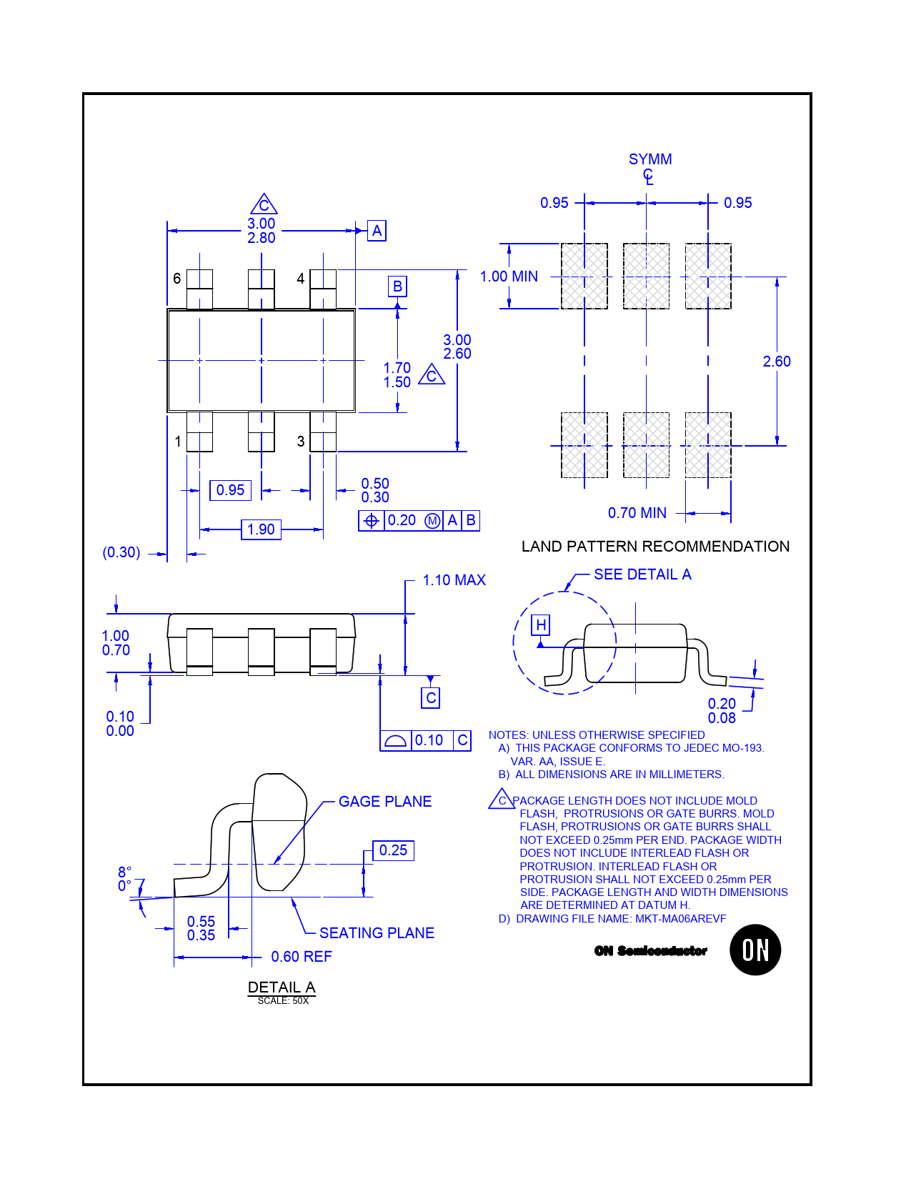

Pages / Page11 / 9 — SYMM. 0.95 C. 3.00. 2.80 A. 4 6 0.95 1.00 MIN B 3.00. 2.60. 1.70. 1.50 1 …
File Format / SizePDF / 672 Kb
SYMM. 0.95 C. 3.00. 2.80 A. 4 6 0.95 1.00 MIN B 3.00. 2.60. 1.70. 1.50 1 2.60 C 3. 0.50
SYMM 0.95 C 3.00 2.80 A 4 6 0.95 1.00 MIN B 3.00 2.60 1.70 1.50 1 2.60 C 3 0.50
SYMM
C
L
0.95 C
3.00
2.80 A
2.60
1.70
1.50 1 2.60 C 3
0.50
0.30 0.95 0.20 1.90 M 0.70 MIN A B LAND PATTERN RECOMMENDATION (0.30) SEE DETAIL A 1.10 MAX
H 1.00
0.70
C
0.10
0.00 0.10 C GAGE PLANE
0.25
0.55
0.35 SEATING PLANE
0.60 REF DETAIL A
SCALE: 50X 0.20
0.08
NOTES: UNLESS OTHERWISE SPECIFIED
A) THIS PACKAGE CONFORMS TO JEDEC MO-193.
VAR. AA, ISSUE E.
B) ALL DIMENSIONS ARE IN MILLIMETERS.
C PACKAGE LENGTH DOES NOT INCLUDE MOLD
FLASH, PROTRUSIONS OR GATE BURRS. MOLD
FLASH, PROTRUSIONS OR GATE BURRS SHALL
NOT EXCEED 0.25mm PER END. PACKAGE WIDTH
DOES NOT INCLUDE INTERLEAD FLASH OR
PROTRUSION. INTERLEAD FLASH OR
PROTRUSION SHALL NOT EXCEED 0.25mm PER
SIDE. PACKAGE LENGTH AND WIDTH DIMENSIONS
ARE DETERMINED AT DATUM H.
D) DRAWING FILE NAME: MKT-MA06AREVF
