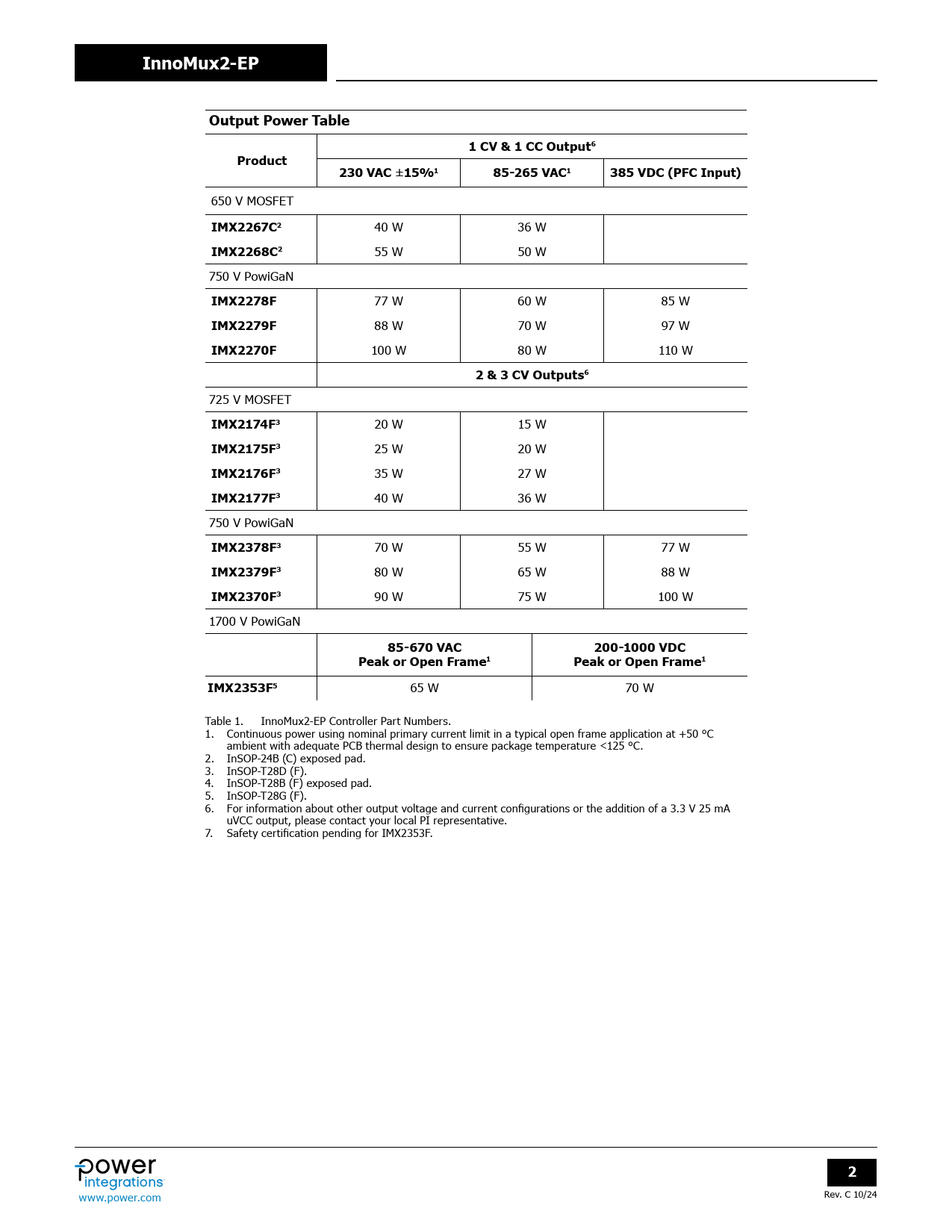

Pages / Page36 / 2 — InnoMux2-EP. Output Power Table. 1 CV & 1 CC Output6. Product. 230 …
InnoMux2-EP. Output Power Table. 1 CV & 1 CC Output6. Product. 230 VAC. 15%1. 85-265 VAC1. 385 VDC (PFC Input). IMX2267C2. IMX2268C2
InnoMux2-EP Output Power Table 1 CV & 1 CC Output6 Product 230 VAC 15%1 85-265 VAC1 385 VDC (PFC Input) IMX2267C2 IMX2268C2
650 V MOSFET
IMX2267C2
40 W 36 W
IMX2268C2
55 W 50 W 750 V PowiGaN
IMX2278F
77 W 60 W 85 W
IMX2279F
88 W 70 W 97 W
IMX2270F
100 W 80 W 110 W
2 & 3 CV Outputs6
725 V MOSFET
IMX2174F3
20 W 15 W
IMX2175F3
25 W 20 W
IMX2176F3
35 W 27 W
IMX2177F3
40 W 36 W 750 V PowiGaN
IMX2378F3
70 W 55 W 77 W
IMX2379F3
80 W 65 W 88 W
IMX2370F3
90 W 75 W 100 W 1700 V PowiGaN
85-670 VAC 200-1000 VDC Peak or Open Frame1 Peak or Open Frame1 IMX2353F5
65 W 70 W Table 1. InnoMux2-EP Control er Part Numbers. 1. Continuous power using nominal primary current limit in a typical open frame application at +50 °C ambient with adequate PCB thermal design to ensure package temperature <125 °C. 2. InSOP-24B (C) exposed pad. 3. InSOP-T28D (F). 4. InSOP-T28B (F) exposed pad. 5. InSOP-T28G (F). 6. For information about other output voltage and current configurations or the addition of a 3.3 V 25 mA uVCC output, please contact your local PI representative. 7. Safety certification pending for IMX2353F.
