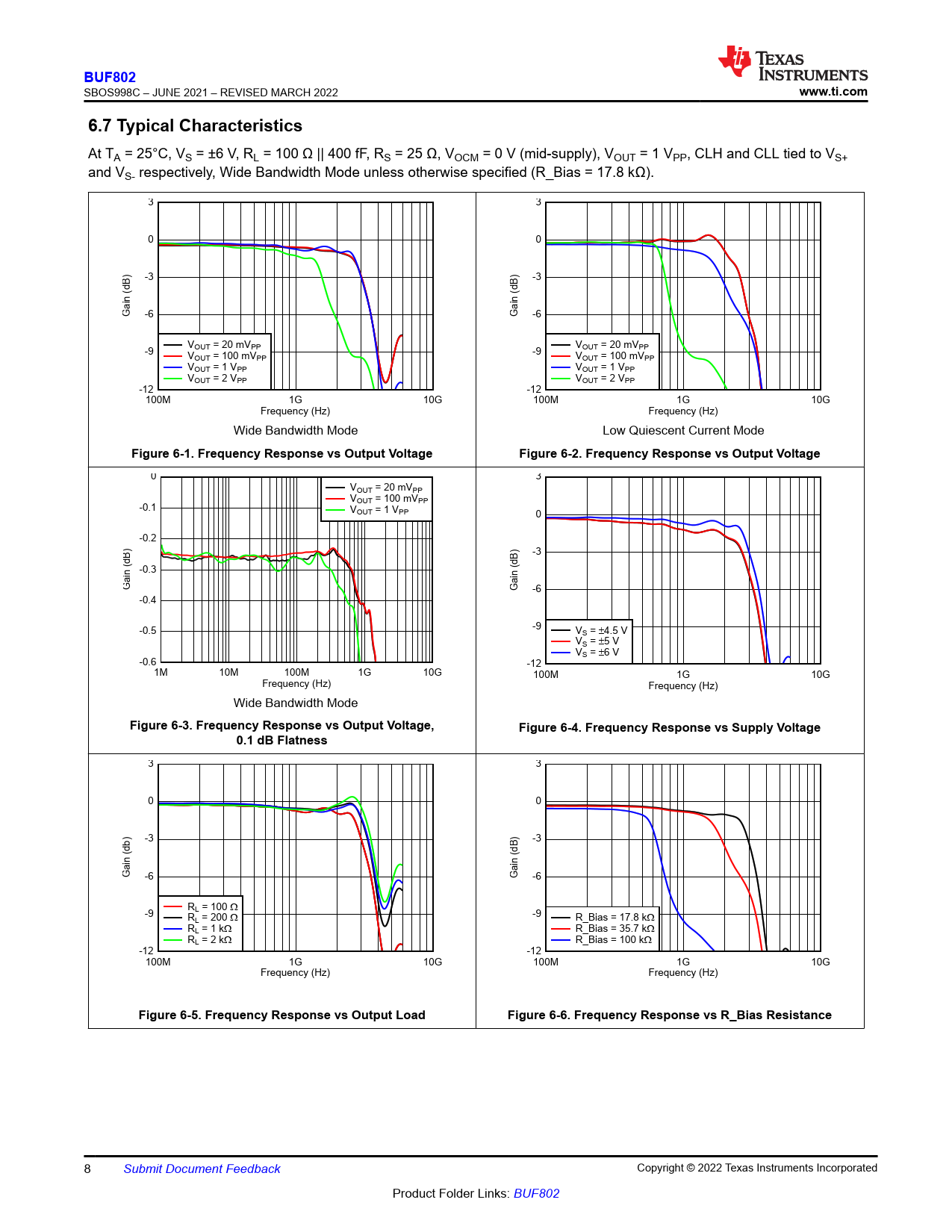

BUF802. www.ti.com. 6.7 Typical Characteristics. Figure 6-1. Frequency Response vs Output Voltage
BUF802 www.ti.com 6.7 Typical Characteristics Figure 6-1 Frequency Response vs Output Voltage
BUF802
SBOS998C – JUNE 2021 – REVISED MARCH 2022
At TA = 25°C, VS = ±6 V, RL = 100 Ω || 400 fF, RS = 25 Ω, VOCM = 0 V (mid-supply), VOUT = 1 VPP, CLH and CLL tied to VS+ and VS- respectively, Wide Bandwidth Mode unless otherwise specified (R_Bias = 17.8 kΩ). 3 3 0 0 -3 -3 n (dB) n (dB) Gai -6 Gai -6 V V -9 OUT = 20 mVPP OUT = 20 mVPP V -9 OUT = 100 mVPP VOUT = 100 mVPP VOUT = 1 VPP VOUT = 1 VPP VOUT = 2 VPP VOUT = 2 VPP -12 -12 100M 1G 10G 100M 1G 10G Frequency (Hz) Frequency (Hz) Wide Bandwidth Mode Low Quiescent Current Mode
Figure 6-1. Frequency Response vs Output Voltage Figure 6-2. Frequency Response vs Output Voltage
0 3 VOUT = 20 mVPP VOUT = 100 mVPP -0.1 VOUT = 1 VPP 0 -0.2 -3 n (dB) -0.3 n (dB) Gai Gai -6 -0.4 -0.5 -9 VS = 4.5 V VS = 5 V VS = 6 V -0.6 -12 1M 10M 100M 1G 10G 100M 1G 10G Frequency (Hz) Frequency (Hz) Wide Bandwidth Mode .
Figure 6-3. Frequency Response vs Output Voltage, Figure 6-4. Frequency Response vs Supply Voltage 0.1 dB Flatness
3 3 0 0 -3 -3 n (db) n (dB) Gai -6 Gai -6 R -9 L = 100 R -9 L = 200 R_Bias = 17.8 k RL = 1 k R_Bias = 35.7 k RL = 2 k R_Bias = 100 k -12 -12 100M 1G 10G 100M 1G 10G Frequency (Hz) Frequency (Hz) . .
Figure 6-5. Frequency Response vs Output Load Figure 6-6. Frequency Response vs R_Bias Resistance
