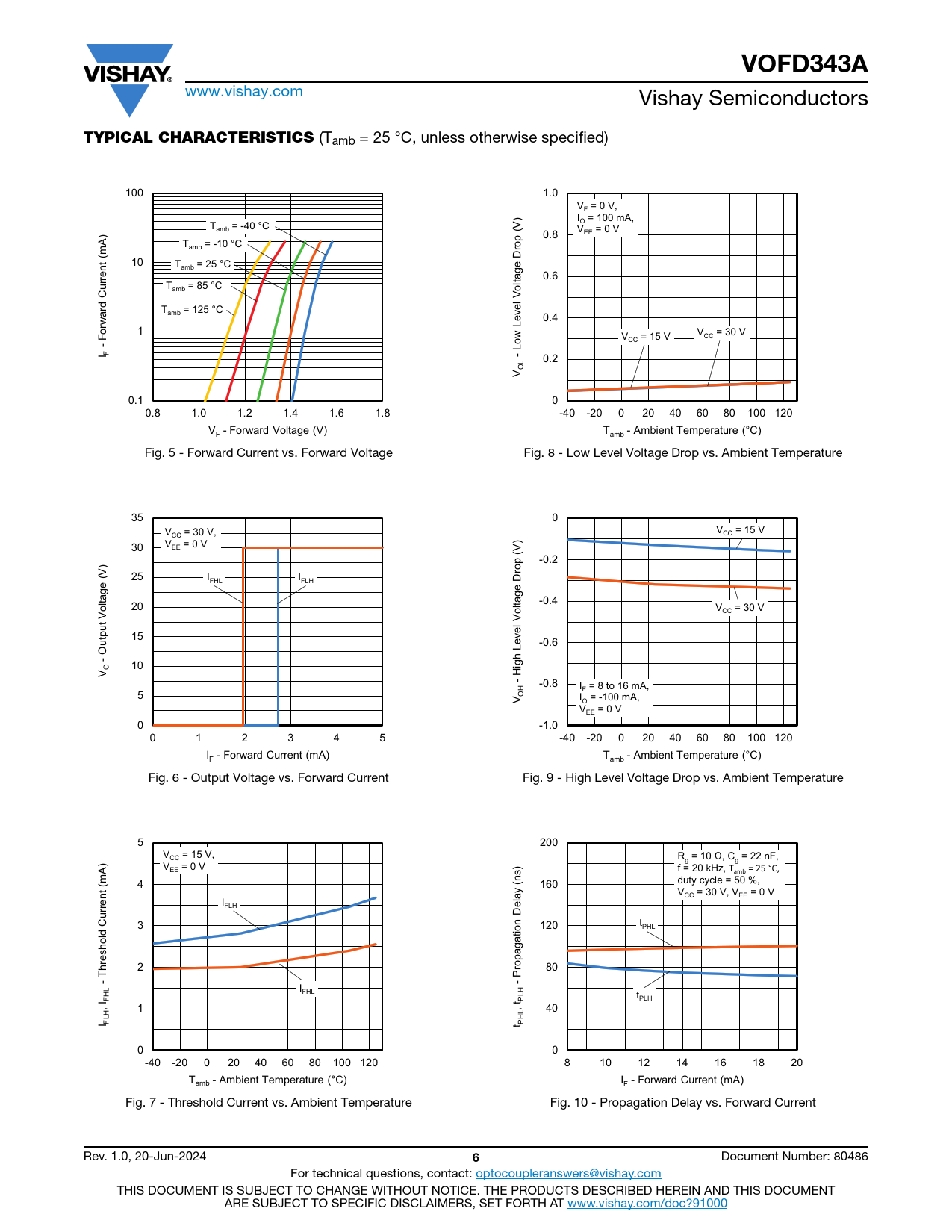

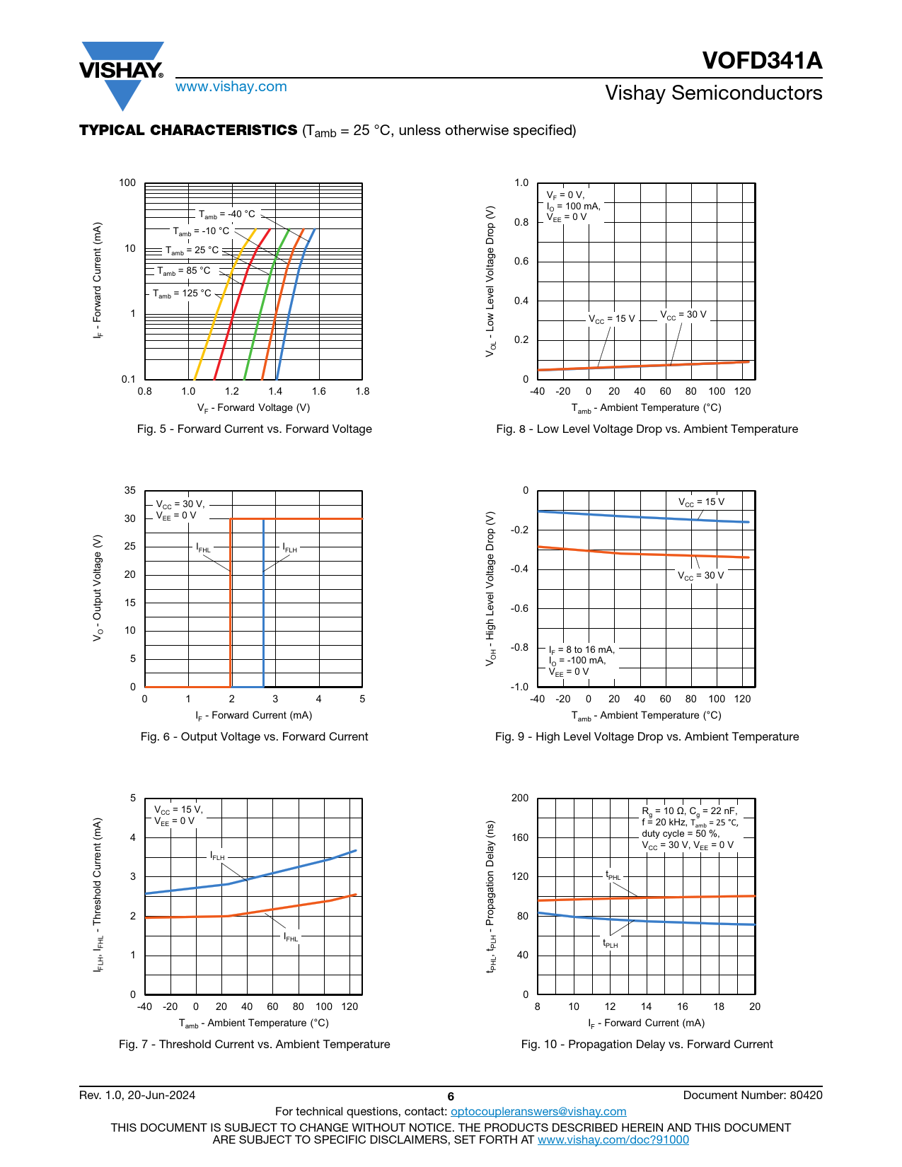

VOFD341A. TYPICAL CHARACTERISTICS
VOFD341A TYPICAL CHARACTERISTICS
VOFD341A
(Tamb = 25 °C, unless otherwise specified) Axis Title Axis Title 100 10000 1.0 10000 V = 0 V, F ) I = 100 mA, O T = -40 °C amb (V V = 0 V ) 0.8 EE A T = -10 °C amb rop (m 10 T = 25 °C 1000 1000 amb rrent 0.6 ltage D ine u T = 85 °C amb ne ne ine o ne ne V 2nd l rd C T = 125 °C amb 1st li a 2nd li 1st li 2nd l 2nd li 0.4 orw 1 100 Level V = 30 V 100 F CC V = 15 V - ow CC L I F - 0.2 OLV 0.1 10 0 10 0.8 1.0 1.2 1.4 1.6 1.8 -40 -20 0 20 40 60 80 100 120 V - Forward Voltage (V) T - Ambient Temperature (°C) F amb Fig. 5 - Forward Current vs. Forward Voltage Fig. 8 - Low Level Voltage Drop vs. Ambient Temperature Axis Title Axis Title 35 10000 0 10000 V = 30 V, V = 15 V CC CC ) 30 V = 0 V EE -0.2 ) rop (V 25 I I FHL FLH 1000 1000 ltage (V -0.4 o 20 ltage D V = 30 V ine ne ne ine o CC ne ne V 2nd l 15 1st li 2nd li 1st li 2nd l 2nd li utput V -0.6 O Level - 100 h 100 O 10 ig V H - -0.8 I = 8 to 16 mA, F 5 OHV I = -100 mA, O V = 0 V EE 0 10 -1.0 10 0 1 2 3 4 5 -40 -20 0 20 40 60 80 100 120 I - Forward Current (mA) T - Ambient Temperature (°C) F amb Fig. 6 - Output Voltage vs. Forward Current Fig. 9 - High Level Voltage Drop vs. Ambient Temperature Axis Title Axis Title 5 10000 200 10000 V = 15 V, CC R = 10 Ω, C = 22 nF, ) g g A V = 0 V EE f = 20 kHz, Tamb = 25 °C, (m 4 (ns) 160 duty cycle = 50 %, y a V = 30 V, V = 0 V CC EE IFLH 1000 1000 3 120 tPHL ine ne ne ine ne ne 2nd l 1st li 2nd li 1st li 2nd l 2nd li hreshold Current 2 ropagation Del 80 T P - 100 - 100 L IFHL H t FH PL PLH , I 1 , t 40 I FLH t PHL 0 10 0 10 -40 -20 0 20 40 60 80 100 120 8 10 12 14 16 18 20 T - Ambient Temperature (°C) I - Forward Current (mA) amb F Fig. 7 - Threshold Current vs. Ambient Temperature Fig. 10 - Propagation Delay vs. Forward Current Rev. 1.0, 20-Jun-2024
