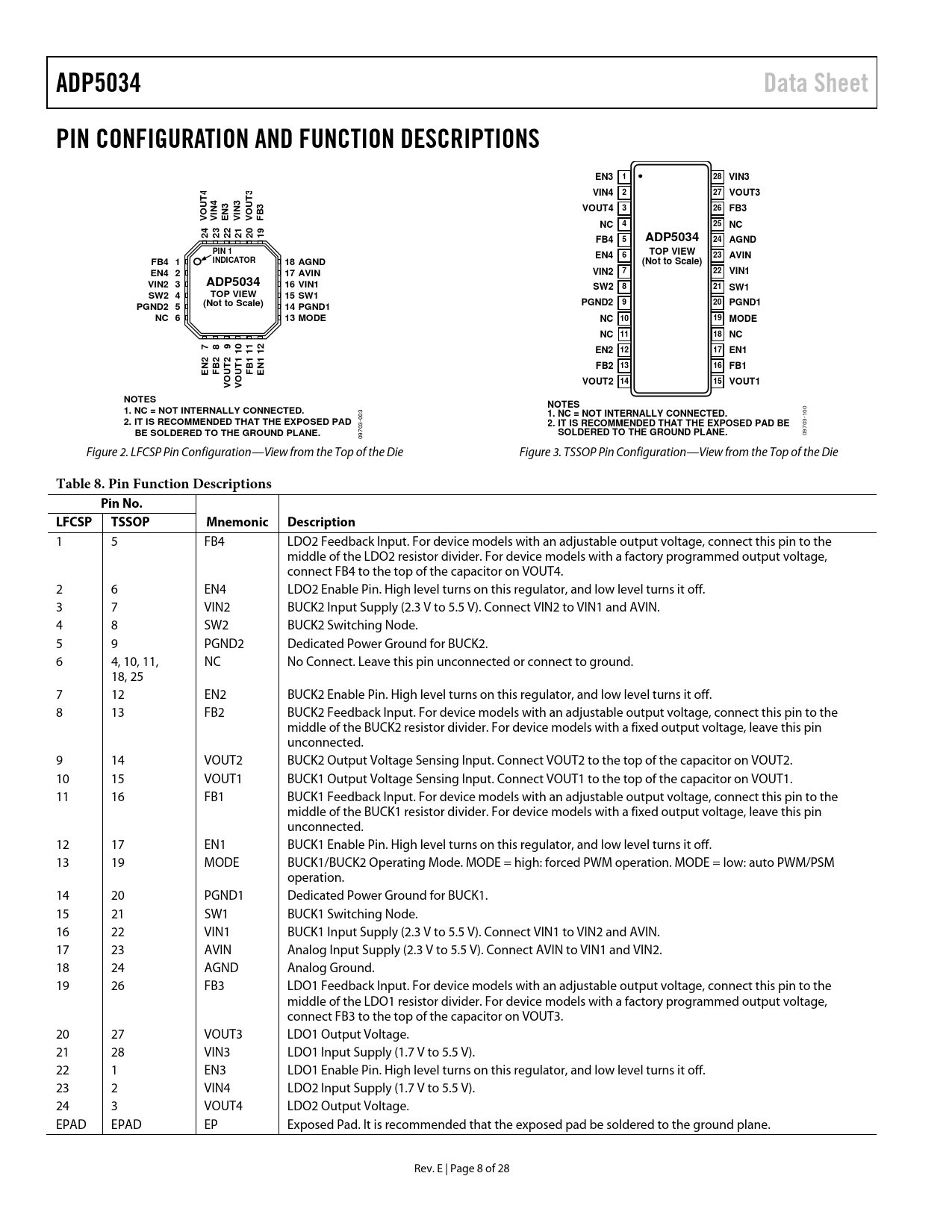

ADP5034. Data Sheet. PIN CONFIGURATION AND FUNCTION DESCRIPTIONS. EN3. 28 VIN3. VIN4. VOUT3. IN4. IN3. VOUT4. FB3. FB4. AGND. PIN 1. EN4. TOP VIEW
ADP5034 Data Sheet PIN CONFIGURATION AND FUNCTION DESCRIPTIONS EN3 28 VIN3 VIN4 VOUT3 IN4 IN3 VOUT4 FB3 FB4 AGND PIN 1 EN4 TOP VIEW
ADP5034 Data Sheet PIN CONFIGURATION AND FUNCTION DESCRIPTIONS EN3 1 28 VIN3 VIN4 2 27 VOUT3 T4 T3 OU IN4 N3 IN3 OU VOUT4 26 B3 3 FB3 V V E V V F NC 4 25 NC 24 23 22 21 20 19 FB4 5 ADP5034 24 AGND PIN 1 EN4 6 TOP VIEW 23 AVIN INDICATOR FB4 1 18 AGND (Not to Scale) EN4 2 17 AVIN VIN2 7 22 VIN1 VIN2 3 ADP5034 16 VIN1 SW2 8 21 SW1 SW2 4 TOP VIEW 15 SW1 PGND2 20 PGND2 9 5 (Not to Scale) 14 PGND1 PGND1 NC 6 13 MODE NC 10 19 MODE NC 11 18 NC 7 8 9 10 11 12 EN2 12 17 EN1 N2 B2 T2 T1 B1 N1 FB2 13 16 FB1 E F F E OU OU V V VOUT2 14 15 VOUT1 NOTES NOTES 1. NC = NOT INTERNALLY CONNECTED. 1. NC = NOT INTERNALLY CONNECTED.
100
2. IT IS RECOMMENDED THAT THE EXPOSED PAD
003
2. IT IS RECOMMENDED THAT THE EXPOSED PAD BE BE SOLDERED TO THE GROUND PLANE. SOLDERED TO THE GROUND PLANE.
09703- 09703- Figure 2. LFCSP Pin Configuration—View from the Top of the Die Figure 3. TSSOP Pin Configuration—View from the Top of the Die
Table 8. Pin Function Descriptions Pin No. LFCSP TSSOP Mnemonic Description
1 5 FB4 LDO2 Feedback Input. For device models with an adjustable output voltage, connect this pin to the middle of the LDO2 resistor divider. For device models with a factory programmed output voltage, connect FB4 to the top of the capacitor on VOUT4. 2 6 EN4 LDO2 Enable Pin. High level turns on this regulator, and low level turns it off. 3 7 VIN2 BUCK2 Input Supply (2.3 V to 5.5 V). Connect VIN2 to VIN1 and AVIN. 4 8 SW2 BUCK2 Switching Node. 5 9 PGND2 Dedicated Power Ground for BUCK2. 6 4, 10, 11, NC No Connect. Leave this pin unconnected or connect to ground. 18, 25 7 12 EN2 BUCK2 Enable Pin. High level turns on this regulator, and low level turns it off. 8 13 FB2 BUCK2 Feedback Input. For device models with an adjustable output voltage, connect this pin to the middle of the BUCK2 resistor divider. For device models with a fixed output voltage, leave this pin unconnected. 9 14 VOUT2 BUCK2 Output Voltage Sensing Input. Connect VOUT2 to the top of the capacitor on VOUT2. 10 15 VOUT1 BUCK1 Output Voltage Sensing Input. Connect VOUT1 to the top of the capacitor on VOUT1. 11 16 FB1 BUCK1 Feedback Input. For device models with an adjustable output voltage, connect this pin to the middle of the BUCK1 resistor divider. For device models with a fixed output voltage, leave this pin unconnected. 12 17 EN1 BUCK1 Enable Pin. High level turns on this regulator, and low level turns it off. 13 19 MODE BUCK1/BUCK2 Operating Mode. MODE = high: forced PWM operation. MODE = low: auto PWM/PSM operation. 14 20 PGND1 Dedicated Power Ground for BUCK1. 15 21 SW1 BUCK1 Switching Node. 16 22 VIN1 BUCK1 Input Supply (2.3 V to 5.5 V). Connect VIN1 to VIN2 and AVIN. 17 23 AVIN Analog Input Supply (2.3 V to 5.5 V). Connect AVIN to VIN1 and VIN2. 18 24 AGND Analog Ground. 19 26 FB3 LDO1 Feedback Input. For device models with an adjustable output voltage, connect this pin to the middle of the LDO1 resistor divider. For device models with a factory programmed output voltage, connect FB3 to the top of the capacitor on VOUT3. 20 27 VOUT3 LDO1 Output Voltage. 21 28 VIN3 LDO1 Input Supply (1.7 V to 5.5 V). 22 1 EN3 LDO1 Enable Pin. High level turns on this regulator, and low level turns it off. 23 2 VIN4 LDO2 Input Supply (1.7 V to 5.5 V). 24 3 VOUT4 LDO2 Output Voltage. EPAD EPAD EP Exposed Pad. It is recommended that the exposed pad be soldered to the ground plane. Rev. E | Page 8 of 28 Document Outline Features Applications General Description Typical Application Circuit Revision History Specifications General Specifications BUCK1 and BUCK2 Specifications LDO1 and LDO2 Specifications Input and Output Capacitor, Recommended Specifications Absolute Maximum Ratings Thermal Resistance ESD Caution Pin Configuration and Function Descriptions Typical Performance Characteristics Theory of Operation Power Management Unit Thermal Protection Undervoltage Lockout Enable/Shutdown BUCK1 and BUCK2 Control Scheme PWM Mode Power Save Mode (PSM) PSM Current Threshold Oscillator/Phasing of Inductor Switching Short-Circuit Protection Soft Start Current Limit 100% Duty Operation Active Pull-Downs LDO1 and LDO2 Applications Information Buck External Component Selection Feedback Resistors Inductor Output Capacitor Input Capacitor LDO External Component Selection Feedback Resistors Output Capacitor Input Bypass Capacitor Input and Output Capacitor Properties Power Dissipation and Thermal Considerations Buck Regulator Power Dissipation LDO Regulator Power Dissipation Junction Temperature PCB Layout Guidelines Typical Application Schematics Bill of Materials Outline Dimensions Ordering Guide
