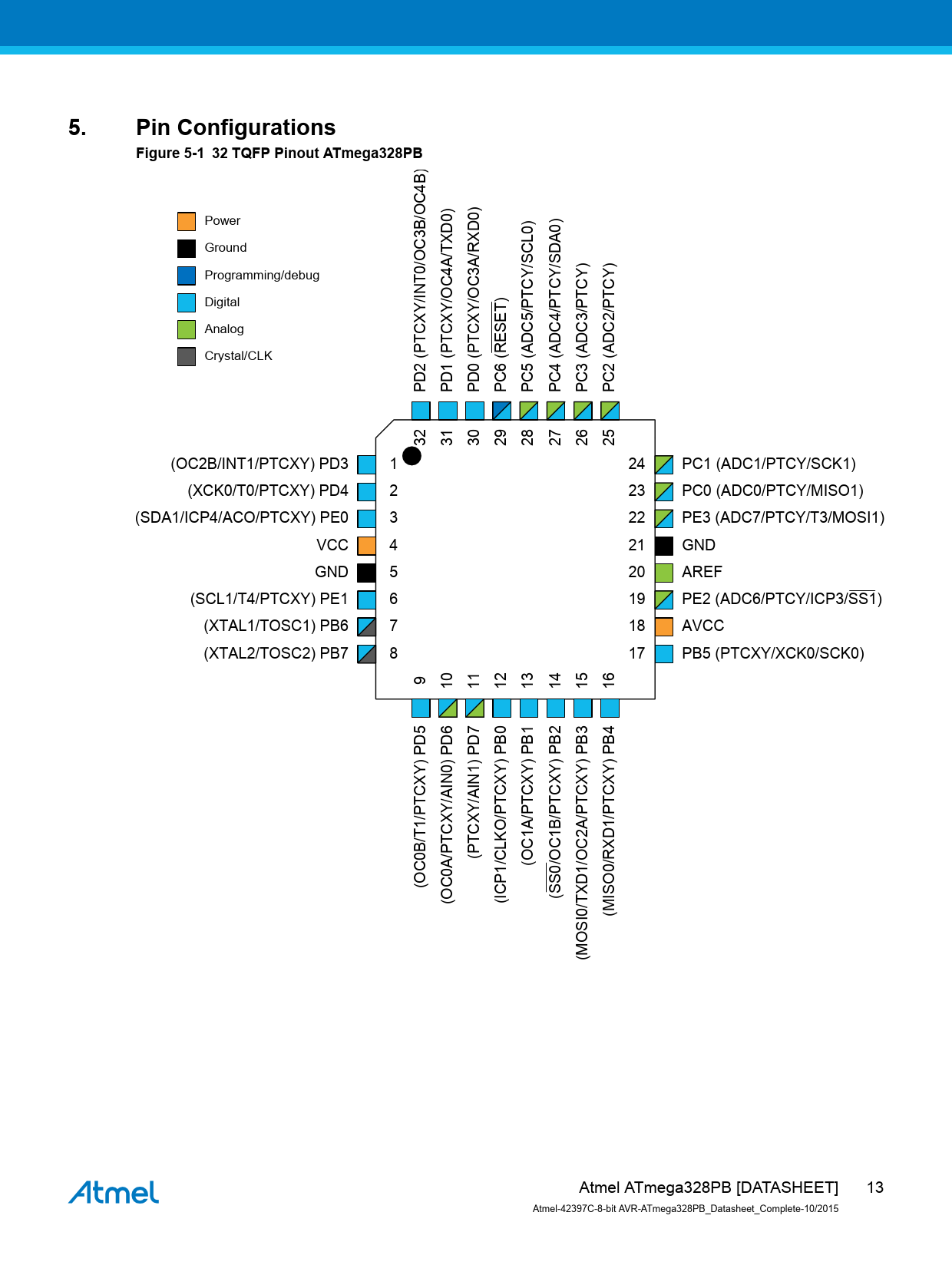

Pages / Page425 / 13 — Pin Configurations Figure 5-1 32 TQFP Pinout ATmega328PB
File Format / SizePDF / 5.8 Mb
5. Pin Configurations Figure 5-1 32 TQFP Pinout ATmega328PB
