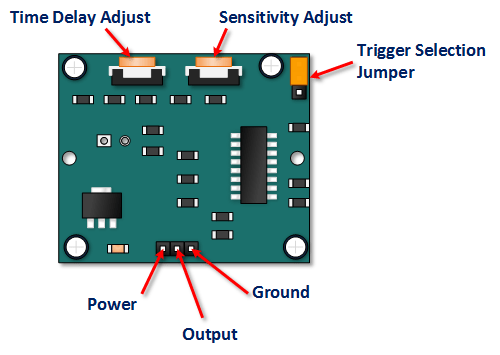

HC-SR501 Pin Outs and Controls
HC-SR501 Pin Outs Controls

The device will detect motion inside a 110 degree cone with a range of 3 to 7 meters.
Important: 3 Seconds Off After Time Delay Completes
The output of this device will go LOW (or Off) for approximately 3 seconds AFTER the time delay completes.   In other words, ALL motion detection is blocked during this three second period.
For Example:
  • Imagine you’re in the single trigger mode (see below) and your time delay is set 5 seconds.
  • The PIR will detect motion and set it high for 5 seconds.
  • After five seconds, the PIR will sets its output low for about 3 seconds.
  • During the three seconds, the PIR will not detect motion.
  • After three seconds, the PIR will detect motion again and detected motion will once again set the output high and the output will remain on as dictated by the Time Delay adjustment and trigger mode selection.
