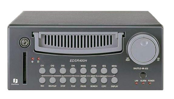

DVR EverFocus EDSR400H
ManufacturerEverFocus
SeriesEDSR100/400/H/M
Part NumberEDSR400H, EDSR-400H
Features
Detailed Description
  • Hard-disk hot-swapping capability
  • On-screen setup menu and system timer
  • RS-232/RS-485 communication port
  • Built-in M-JPEG compression/decompression with configurable quality
  • Compact Flash Card.
  • Audio recording capability
  • Programmed with various time-lapse speeds
  • Time lapse and real time recording
  • Operation status record log
  • Multi-level password protection
  • Pre-Alarm image recording
The EDSR100M and EDSR400M are the full-featured digital video recorders designed specifically for use in mobile applications.
Specifications of EDSR100/400/H/M Series DVR
Model
EDSR100H
EDSR100M
EDSR400H
EDSR400M
 Input
1 camera input (BNC), 1Vp -p/75ohm
4 camera inputs (BNC), 1Vp-p/75ohm
Output
1 BNC video out (1Vp -p/75 ohm) for Main Monitor
1 video out (1Vp -p/75ohm)for looping
1 BNC video out (1Vp-p/75 ohm) for Main Monitor
1 BNC video out (1Vp-p/75 ohm) for CALL Monitor
4 video out (1Vp-p/75ohm) for looping
Video Compression
M-JPEG
Recording Resolution
720×484 (NTSC);
720×576 (PAL)
Compact Flash
Memory
Built-in Compact Flash card slot
Audio Input 1 1 1 1
Output 2 1 2 1
Alarm
Input
1
4
Output
1
Video Display
Full, PIP
Full, PIP, Quad and 2×2 zoom
for Live and Playback
Video Loss Detection
Yes
Ethernet
RJ45 connectors for network communications
Event Log
Yes
Hard Disk Storage
3.5” IDE type, Hot-swappable
2.5” or 3.5” IDE type, Hot-swappable
Recording Mode
Continuous, Time -lapse recording, Schedule or Event Recording
Recording Rate
60/50 fps for NTSC/PAL
Playback Rate
Playback Search
By Date/Time or Event/Segment
Setup
On screen display setup
User Interface
Menu Driven
User Input Device
Front Panel Keypad
Timer
Built-in real time clock
Watch Dog Timer
Yes
RS-232
9-pin female connector
RS-485
RJ11 Connector
Dimension (L×W×H)
320.8 × 215 × 100mm
Operating Temperature
0°C ~ +40°C
0°C ~ +50°C
0°C ~ +40°C
0°C ~ +50°C
Power Consumption
39W
60W
Power Source
AC100~240V
DC 12-24 V
AC100~240V
DC 12-24 V
Operating Shock
8G,11ms (20
per five seconds
maximum)
8G,11ms (20
per five seconds
maximum)
Operating Vibration
5~20Hz, 0.037
inches (double
amplitude)
5~500Hz, 0.75G
(0 to peak)
5~20Hz, 0.037
inches (double
amplitude)
5~500Hz, 0.75G
(0 to peak)
Other Names:
EDSR400H, EDSR400H, EDSR400H, EDSR 400H, EDSR400H EDSR-400H, EDSR400H EDSR-400H
