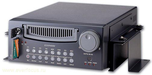

DVR EverFocus EDSR400M
ManufacturerEverFocus
SeriesEDSR100/400/H/M
Part NumberEDSR400M, EDSR-400M
Features
Detailed Description
  • Hard-disk hot-swapping capability
  • On-screen setup menu and system timer
  • RS-232/RS-485 communication port
  • Built-in M-JPEG compression/decompression with configurable quality
  • Compact Flash Card.
  • Audio recording capability
  • Programmed with various time-lapse speeds
  • Time lapse and real time recording
  • Operation status record log
  • Multi-level password protection
  • Pre-Alarm image recording
The EDSR100M and EDSR400M are the full-featured digital video recorders designed specifically for use in mobile applications.
