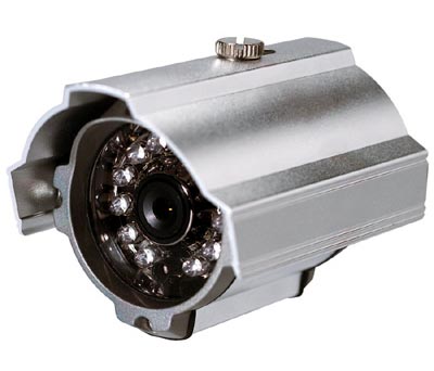

Water-proof camera Huviron SK-2044
ManufacturerHuviron
SeriesSK-2024/2044/2144/2124
Part NumberSK-2044
Features
Detailed Description
  • Water-proof (IP 67)
  • Strong aluminum case (for outdoor use)
  • Automatically LEDs On/Off by lighting
  • Built-in 12pcs of IR LEDs (Option : Built-in 20pcs of IR LED)
  • High Resolution (SK-2144, SK-2044)
Specifications of SK-2024/2044/2144/2124 Series Cameras
Model
SK-2024
SK-2044
SK-2124
SK-2144
CCD Type
1/3" B/W SONY
SUPER HAD CCD
1/4" COLOR SONY
SUPER HAD CCD II
Pixels
270K
410K
270K
Scanning
2:1 Interlace
Sync.
Type
Internal
Resolution
400TV-line
570TV-line
500TV-line
380TV-line
Video Output
1.0 V p-p (Sync. Negative), Termination 75Ω
S/N Ratio
45dB or More
(AGC OFF)
48dB or More
(AGC OFF)
Min. Illumination
0 Lux (F/1.2) - LED ON - 10m range
Day&Night
Electronic Day&Night
Lens Mount
Fixed Focal Board Lens
r (Gamma)
r=0.45 typ.
Shutter Speed
1/60 (1/50)~1/100,000sec
Power Supply
Regulated 12V DC ±10%
Current Consumption
150mA max. (LED OFF)
360mA max. (LED ON)
100mA max. (LED OFF)
350mA max. (LED ON)
Operation Temp.
–10°C ~ 50°C
Preservation Temp.
–20°C ~ 60°C
Dimension
(W × H × D)
67.2 × 69.7 × 92 mm
67.2 × 69.3 × 94 mm
