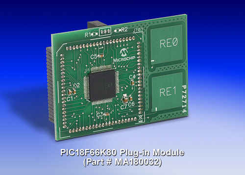

Processor Plug-In Modules are small circuit boards to be used with the various Microchip Development Boards to evaluate various MCU families.
These plug into the main processor socket of the Development Boards so that different microcontrollers can be used for prototyping, demonstration or development --quickly and easily.
Microchip: MA180032 PIC18F66K80 Plug-In Module (PIM)
This processor PIM includes a 64-pin PIC18F66K80 MCU sample. The PIM plugs into PIC18 Explorer Board (DM183032)
