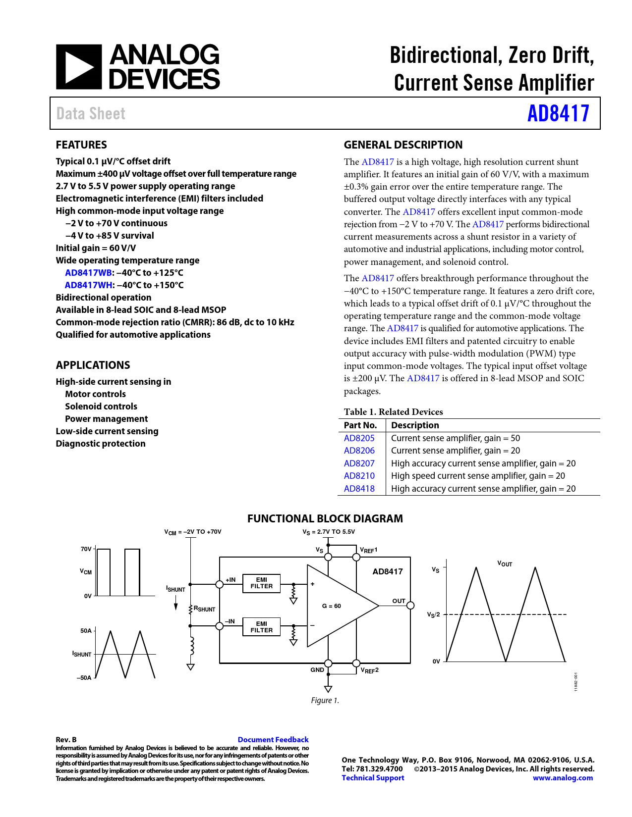

Bidirectional, Zero Drift, Current Sense Amplifier Data Sheet AD8417 FEATURES GENERAL DESCRIPTION Typical 0.1 μV/°C offset drift
The AD8417 is a high voltage, high resolution current shunt
Maximum ±400 μV voltage offset over full temperature range
amplifier. It features an initial gain of 60 V/V, with a maximum
2.7 V to 5.5 V power supply operating range
±0.3% gain error over the entire temperature range. The
Electromagnetic interference (EMI) filters included
buffered output voltage directly interfaces with any typical
High common-mode input voltage range
converter. The AD8417 offers excellent input common-mode
−2 V to +70 V continuous
rejection from −2 V to +70 V. The AD8417 performs bidirectional
−4 V to +85 V survival
current measurements across a shunt resistor in a variety of
Initial gain = 60 V/V
automotive and industrial applications, including motor control,
Wide operating temperature range
power management, and solenoid control.
AD8417WB: −4 0°C to +125°C
The AD8417 offers breakthrough performance throughout the
AD8417WH: −4 0°C to +150°C
−40°C to +150°C temperature range. It features a zero drift core,
Bidirectional operation
which leads to a typical offset drift of 0.1 μV/°C throughout the
Available in 8-lead SOIC and 8-lead MSOP
operating temperature range and the common-mode voltage
Common-mode rejection ratio (CMRR): 86 dB, dc to 10 kHz
range. The AD8417 is qualified for automotive applications. The
Qualified for automotive applications
device includes EMI filters and patented circuitry to enable
output accuracy with pulse-width modulation (PWM) type
APPLICATIONS
input common-mode voltages. The typical input offset voltage
High-side current sensing in
is ±200 μV. The AD8417 is offered in 8-lead MSOP and SOIC
Motor controls
packages.
Solenoid controls Table 1. Related Devices Power management Part No. Description Low-side current sensing
AD8205 Current sense amplifier, gain = 50
Diagnostic protection
AD8206 Current sense amplifier, gain = 20 AD8207 High accuracy current sense amplifier, gain = 20 AD8210 High speed current sense amplifier, gain = 20 AD8418 High accuracy current sense amplifier, gain = 20
FUNCTIONAL BLOCK DIAGRAM VCM = –2V TO +70V VS = 2.7V TO 5.5V 70V V V S REF1 VOUT V V S CM AD8417 +IN EMI + I FILTER SHUNT 0V OUT G = 60 RSHUNT VS/2 –IN EMI 50A FILTER ISHUNT 0V GND VREF2
