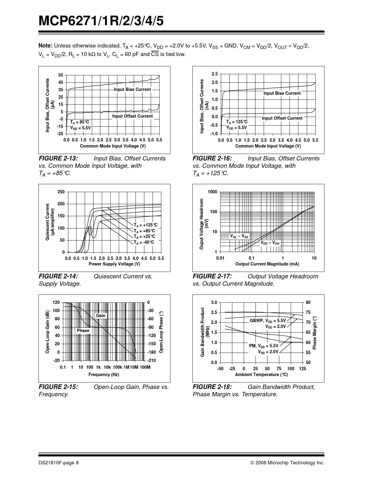

MCP6271/1R/2/3/4/5. Note:. 2.5. ts n. 2.0. rre. Input Bias Current. rren. 1.5. et C. 1.0. fset. (pA. (n 0.5. , Offs. , Of. ias. Input Offset Current. 0.0
MCP6271/1R/2/3/4/5 Note: 2.5 ts n 2.0 rre Input Bias Current rren 1.5 et C 1.0 fset (pA (n 0.5 , Offs , Of ias Input Offset Current 0.0
Unless otherwise indicated, T ≈ A = +25°C, VDD = +2.0V to +5.5V, VSS = GND, VCM = VDD/2, VOUT VDD/2, VL = VDD/2, RL = 10 kΩ to VL, CL = 60 pF and CS is tied low.
55 2.5 ts n 45 ts 2.0 rre 35 u Input Bias Current rren 1.5 Input Bias Current 25 Cu et C ) 1.0 ) 15 fset A (pA (n 0.5 , Offs 5 , Of ias Input Offset Current ias 0.0 B -5 Input Offset Current t T T A = 85°C t B A = 125°C -15 u -0.5 V p VDD = 5.5V Inpu DD = 5.5V In -25 -1.0 0.0 0.5 1.0 1.5 2.0 2.5 3.0 3.5 4.0 4.5 5.0 5.5 0.0 0.5 1.0 1.5 2.0 2.5 3.0 3.5 4.0 4.5 5.0 5.5 Common Mode Input Voltage (V) Common Mode Input Voltage (V) FIGURE 2-13:
Input Bias, Offset Currents
FIGURE 2-16:
Input Bias, Offset Currents vs. Common Mode Input Voltage, with vs. Common Mode Input Voltage, with TA = +85°C. TA = +125°C.
250 1000 t 200 room rren r) e d 100 u a ifi 150 t C pl V) m e He T cen /a 100 A = +125°C ag (m T lt ies A = +85°C o 10 (µA T VOL – VSS Qu A = +25°C t V 50 u TA = -40°C p V u DD – VOH O 0 1 0.0 0.5 1.0 1.5 2.0 2.5 3.0 3.5 4.0 4.5 5.0 5.5 0.01 0.1 1 10 Power Supply Voltage (V) Output Current Magnitude (mA) FIGURE 2-14:
Quiescent Current vs.
FIGURE 2-17:
Output Voltage Headroom Supply Voltage. vs. Output Current Magnitude.
120 0 3.0 80 t 100 -30 B) °) 2.5 75 Gain duc (d 80 -60 e ( o in GBWP, V (°) as Pr 2.0 DD = 5.5V 70 in 60 -90 th ) V Ga Ph DD = 2.0V d rg p Phase p 1.5 65 o 40 o -120 oo (MHz -L -L ndwi a se Ma 20 -150 1.0 60 a en en PM, V h DD = 5.5V in B P Op 0 -180 Op a 0.5 VDD = 2.0V 55 G -20 -210 0.0 50 0. 011 100 1 010 10 020 03 1k 10 04k 1 05 00k 06 1M 10 07M 08 100M -50 -25 0 25 50 75 100 125 E- E+ E+ E+ E+ E+ E+ E+ E+ E+ 1. 1. 1. 1. Fre 1. quenc 1.y (H 1. z) 1. 1. 1. Ambient Temperature (°C) FIGURE 2-15:
Open-Loop Gain, Phase vs.
FIGURE 2-18:
Gain Bandwidth Product, Frequency. Phase Margin vs. Temperature. DS21810F-page 8 © 2008 Microchip Technology Inc. Document Outline 1.0 Electrical Characteristics FIGURE 1-1: Timing Diagram for the Chip Select (CS) pin on the MCP6273 and MCP6275. 1.1 Test Circuits FIGURE 1-2: AC and DC Test Circuit for Most Non-Inverting Gain Conditions. FIGURE 1-3: AC and DC Test Circuit for Most Inverting Gain Conditions. 2.0 Typical Performance Curves FIGURE 2-1: Input Offset Voltage. FIGURE 2-2: Input Bias Current at TA = +85˚C. FIGURE 2-3: Input Offset Voltage vs. Common Mode Input Voltage, with VDD = 2.0V. FIGURE 2-4: Input Offset Voltage Drift. FIGURE 2-5: Input Bias Current at TA = +125˚C. FIGURE 2-6: Input Offset Voltage vs. Common Mode Input Voltage, with VDD = 5.5V. FIGURE 2-7: Common Mode Input Voltage Range Lower Limit vs. Temperature. FIGURE 2-8: Input Offset Voltage vs. Output Voltage. FIGURE 2-9: CMRR, PSRR vs. Frequency. FIGURE 2-10: Common Mode Input Voltage Range Upper Limit vs. Temperature. FIGURE 2-11: Input Bias, Input Offset Currents vs. Temperature. FIGURE 2-12: CMRR, PSRR vs. Temperature. FIGURE 2-13: Input Bias, Offset Currents vs. Common Mode Input Voltage, with TA = +85˚C. FIGURE 2-14: Quiescent Current vs. Supply Voltage. FIGURE 2-15: Open-Loop Gain, Phase vs. Frequency. FIGURE 2-16: Input Bias, Offset Currents vs. Common Mode Input Voltage, with TA = +125˚C. FIGURE 2-17: Output Voltage Headroom vs. Output Current Magnitude. FIGURE 2-18: Gain Bandwidth Product, Phase Margin vs. Temperature. FIGURE 2-19: Maximum Output Voltage Swing vs. Frequency. FIGURE 2-20: Input Noise Voltage Density vs. Frequency. FIGURE 2-21: Output Short Circuit Current vs. Supply Voltage. FIGURE 2-22: Slew Rate vs. Temperature. FIGURE 2-23: Input Noise Voltage Density vs. Common Mode Input Voltage, with f = 1 kHz. FIGURE 2-24: Channel-to-Channel Separation vs. Frequency (MCP6272 and MCP6274). FIGURE 2-25: Quiescent Current vs. Chip Select (CS) Voltage, with VDD = 2.0V (MCP6273 and MCP6275 only). FIGURE 2-26: Large Signal Non-inverting Pulse Response. FIGURE 2-27: Small Signal Non-inverting Pulse Response. FIGURE 2-28: Quiescent Current vs. Chip Select (CS) Voltage, with VDD = 5.5V (MCP6273 and MCP6275 only). FIGURE 2-29: Large Signal Inverting Pulse Response. FIGURE 2-30: Small Signal Inverting Pulse Response. FIGURE 2-31: Chip Select (CS) to Amplifier Output Response Time, with VDD = 2.0V (MCP6273 and MCP6275 only). FIGURE 2-32: Input Current vs. Input Voltage. FIGURE 2-33: Chip Select (CS) to Amplifier Output Response Time, with VDD = 5,5V (MCP6273 and MCP6275 only). FIGURE 2-34: The MCP6271/1R/2/3/4/5 Show no Phase Reversal. 3.0 Pin Descriptions TABLE 3-1: Pin Function Table for Single Op Amps TABLE 3-2: Pin Function Table for Dual and Quad Op Amps 3.1 Analog Outputs 3.2 Analog Inputs 3.3 MCP6275’s VOUTA/VINB+ Pin 3.4 Chip Select Digital Input 3.5 Power Supply Pins 4.0 Application Information 4.1 Rail-to-Rail Inputs FIGURE 4-1: Simplified Analog Input ESD Structures. FIGURE 4-2: Protecting the Analog Inputs. 4.2 Rail-to-Rail Output 4.3 Capacitive Loads FIGURE 4-3: Output Resistor, RISO stabilizes large capacitive loads. FIGURE 4-4: Recommended RISO Values for Capacitive Loads. 4.4 MCP6273/5 Chip Select 4.5 Cascaded Dual Op Amps (MCP6275) FIGURE 4-5: Cascaded Gain Amplifier. 4.6 Unused Amplifiers FIGURE 4-6: Unused Op Amps. 4.7 Supply Bypass 4.8 PCB Surface Leakage FIGURE 4-7: Example Guard Ring Layout for Inverting Gain. 4.9 Application Circuits FIGURE 4-8: Active Full-wave Rectifier. FIGURE 4-9: Non-Inverting Integrator. FIGURE 4-10: Isolating the Load with a Buffer. FIGURE 4-11: Cascaded Gain Circuit Configuration. FIGURE 4-12: Difference Amplifier Circuit. FIGURE 4-13: Integrator Circuit with Active Compensation. FIGURE 4-14: Second Order Multiple Feedback Low-Pass Filter with an Extra Pole- Zero Pair. FIGURE 4-15: Second Order Sallen-Key Low-Pass Filter with an Extra Pole-Zero Pair and Chip Select. FIGURE 4-16: Capacitorless Second Order Low-Pass Filter with Chip Select. 5.0 Design Tools 5.1 SPICE Macro Model 5.2 FilterLab® Software 5.3 Mindi™ Circuit Designer & Simulator 5.4 MAPS (Microchip Advanced Part Selector) 5.5 Analog Demonstration and Evaluation Boards 5.6 Application Notes 6.0 Packaging Information 6.1 Package Marking Information
