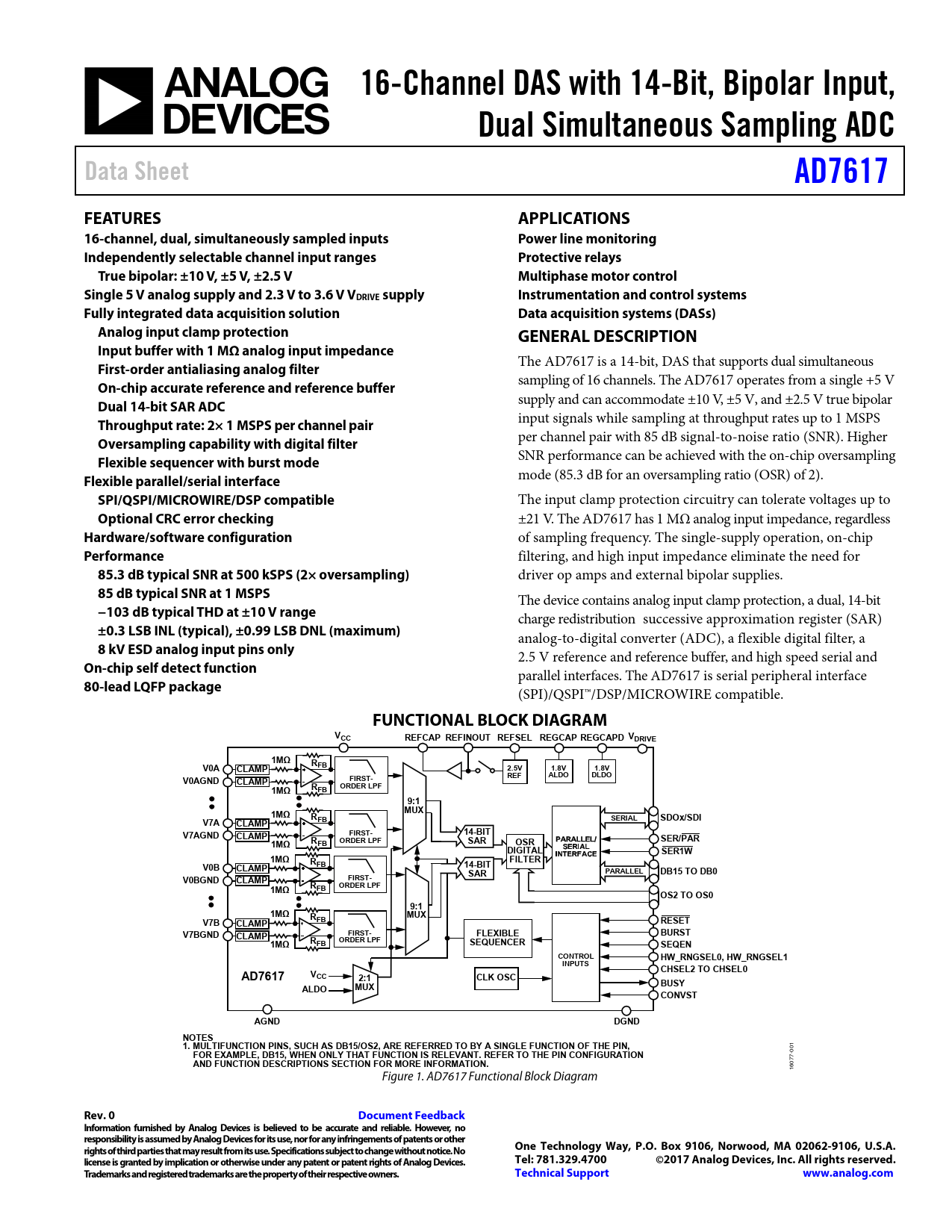

16-Channel DAS with 14-Bit, Bipolar Input, Dual Simultaneous Sampling ADC Data Sheet AD7617 FEATURES APPLICATIONS 16-channel, dual, simultaneously sampled inputs Power line monitoring Independently selectable channel input ranges Protective relays True bipolar: ±10 V, ±5 V, ±2.5 V Multiphase motor control Single 5 V analog supply and 2.3 V to 3.6 V VDRIVE supply Instrumentation and control systems Fully integrated data acquisition solution Data acquisition systems (DASs) Analog input clamp protection GENERAL DESCRIPTION Input buffer with 1 MΩ analog input impedance
The AD7617 is a 14-bit, DAS that supports dual simultaneous
First-order antialiasing analog filter
sampling of 16 channels. The AD7617 operates from a single +5 V
On-chip accurate reference and reference buffer
supply and can accommodate ±10 V, ±5 V, and ±2.5 V true bipolar
Dual 14-bit SAR ADC
input signals while sampling at throughput rates up to 1 MSPS
Throughput rate: 2× 1 MSPS per channel pair
per channel pair with 85 dB signal-to-noise ratio (SNR). Higher
Oversampling capability with digital filter
SNR performance can be achieved with the on-chip oversampling
Flexible sequencer with burst mode
mode (85.3 dB for an oversampling ratio (OSR) of 2).
Flexible parallel/serial interface SPI/QSPI/MICROWIRE/DSP compatible
The input clamp protection circuitry can tolerate voltages up to
Optional CRC error checking
±21 V. The AD7617 has 1 MΩ analog input impedance, regardless
Hardware/software configuration
of sampling frequency. The single-supply operation, on-chip
Performance
filtering, and high input impedance eliminate the need for
85.3 dB typical SNR at 500 kSPS (2× oversampling)
driver op amps and external bipolar supplies.
85 dB typical SNR at 1 MSPS
The device contains analog input clamp protection, a dual, 14-bit
−103 dB typical THD at ±10 V range
charge redistribution successive approximation register (SAR)
±0.3 LSB INL (typical), ±0.99 LSB DNL (maximum)
analog-to-digital converter (ADC), a flexible digital filter, a
8 kV ESD analog input pins only
2.5 V reference and reference buffer, and high speed serial and
On-chip self detect function
parallel interfaces. The AD7617 is serial peripheral interface
80-lead LQFP package
(SPI)/QSPI™/DSP/MICROWIRE compatible.
FUNCTIONAL BLOCK DIAGRAM VCC REFCAP REFINOUT REFSEL REGCAP REGCAPD VDRIVE 1MΩ R V0A FB CLAMP 2.5V 1.8V 1.8V REF ALDO DLDO V0AGND FIRST- CLAMP 1MΩ RFB ORDER LPF 9:1 MUX 1MΩ R SERIAL FB SDOx/SDI V7A CLAMP V7AGND FIRST- 14-BIT CLAMP ORDER LPF SER/PAR SAR OSR 1MΩ RFB DIGITAL SER1W 1MΩ R FILTER FB V0B 14-BIT CLAMP SAR PARALLEL DB15 TO DB0 FIRST- V0BGND CLAMP 1MΩ RFB ORDER LPF OS2 TO OS0 9:1 1MΩ R MUX FB V7B RESET CLAMP FIRST- V7BGND FLEXIBLE BURST CLAMP 1MΩ RFB ORDER LPF SEQUENCER SEQEN CONTROL HW_RNGSEL0, HW_RNGSEL1 INPUTS CHSEL2 TO CHSEL0 AD7617 VCC 2:1 CLK OSC BUSY ALDO MUX CONVST AGND DGND NOTES
