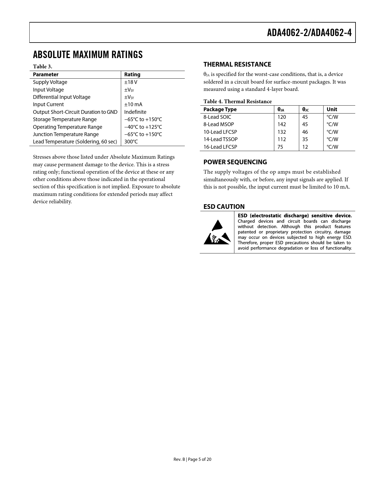

ADA4062-2/ADA4062-4. ABSOLUTE MAXIMUM RATINGS. THERMAL RESISTANCE. Table 3. Parameter Rating. Table 4. Thermal Resistance
ADA4062-2/ADA4062-4 ABSOLUTE MAXIMUM RATINGS THERMAL RESISTANCE Table 3 Parameter Rating Table 4 Thermal Resistance
ADA4062-2/ADA4062-4 ABSOLUTE MAXIMUM RATINGS THERMAL RESISTANCE Table 3. Parameter Rating
θJA is specified for the worst-case conditions, that is, a device Supply Voltage ±18 V soldered in a circuit board for surface-mount packages. It was Input Voltage ±VSY measured using a standard 4-layer board. Differential Input Voltage ±VSY
Input Current ±10 mA
Package Type θ
Output Short-Circuit Duration to GND Indefinite
JA θJC Unit
Storage Temperature Range −65°C to +150°C 8-Lead SOIC 120 45 °C/W Operating Temperature Range −40°C to +125°C 8-Lead MSOP 142 45 °C/W Junction Temperature Range −65°C to +150°C 10-Lead LFCSP 132 46 °C/W Lead Temperature (Soldering, 60 sec) 300°C 14-Lead TSSOP 112 35 °C/W 16-Lead LFCSP 75 12 °C/W Stresses above those listed under Absolute Maximum Ratings may cause permanent damage to the device. This is a stress
POWER SEQUENCING
rating only; functional operation of the device at these or any The supply voltages of the op amps must be established other conditions above those indicated in the operational simultaneously with, or before, any input signals are applied. If section of this specification is not implied. Exposure to absolute this is not possible, the input current must be limited to 10 mA. maximum rating conditions for extended periods may affect device reliability.
