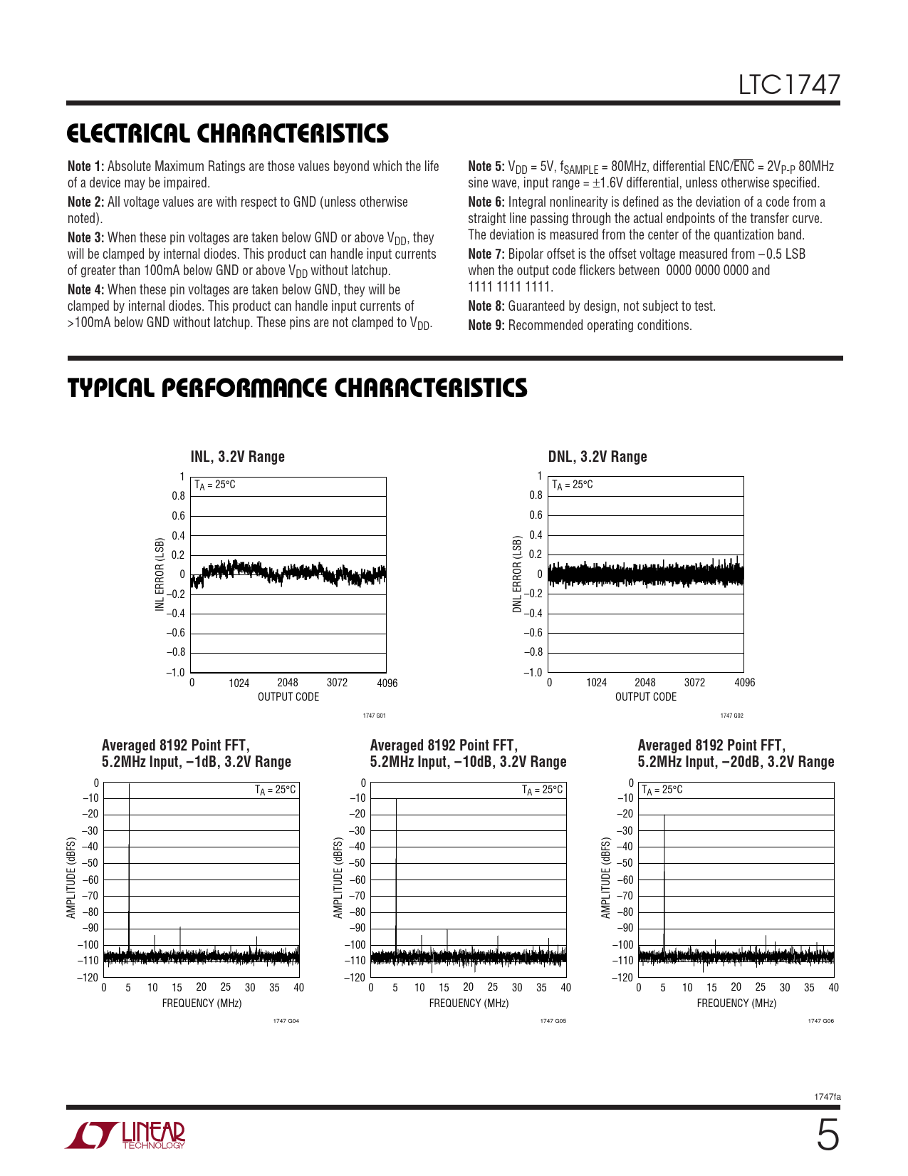

ELECTRICAL CHARACTERISTICS. Note 1:. Note 5:. Note 2:. Note 6:. Note 3:. Note 7:. Note 4:. Note 8:. Note 9:
ELECTRICAL CHARACTERISTICS Note 1: Note 5: Note 2: Note 6: Note 3: Note 7: Note 4: Note 8: Note 9:
LTC1747
Absolute Maximum Ratings are those values beyond which the life
Note 5:
VDD = 5V, fSAMPLE = 80MHz, differential ENC/ENC = 2VP-P 80MHz of a device may be impaired. sine wave, input range = ±1.6V differential, unless otherwise specified.
Note 2:
All voltage values are with respect to GND (unless otherwise
Note 6:
Integral nonlinearity is defined as the deviation of a code from a noted). straight line passing through the actual endpoints of the transfer curve.
Note 3:
When these pin voltages are taken below GND or above V The deviation is measured from the center of the quantization band. DD, they will be clamped by internal diodes. This product can handle input currents
Note 7:
Bipolar offset is the offset voltage measured from – 0.5 LSB of greater than 100mA below GND or above VDD without latchup. when the output code flickers between 0000 0000 0000 and
Note 4:
When these pin voltages are taken below GND, they will be 1111 1111 1111. clamped by internal diodes. This product can handle input currents of
Note 8:
Guaranteed by design, not subject to test. >100mA below GND without latchup. These pins are not clamped to VDD.
Note 9:
Recommended operating conditions.
W U TYPICAL PERFOR A CE CHARACTERISTICS INL, 3.2V Range DNL, 3.2V Range
1 1 TA = 25°C TA = 25°C 0.8 0.8 0.6 0.6 0.4 0.4 0.2 0.2 0 0 –0.2 –0.2 INL ERROR (LSB) –0.4 DNL ERROR (LSB) –0.4 –0.6 –0.6 –0.8 –0.8 –1.0 –1.0 0 1024 2048 3072 4096 0 1024 2048 3072 4096 OUTPUT CODE OUTPUT CODE 1747 G01 1747 G02
Averaged 8192 Point FFT, Averaged 8192 Point FFT, Averaged 8192 Point FFT, 5.2MHz Input, –1dB, 3.2V Range 5.2MHz Input, –10dB, 3.2V Range 5.2MHz Input, –20dB, 3.2V Range
0 0 0 TA = 25°C TA = 25°C TA = 25°C –10 –10 –10 –20 –20 –20 –30 –30 –30 –40 –40 –40 –50 –50 –50 –60 –60 –60 –70 –70 –70 AMPLITUDE (dBFS) –80 AMPLITUDE (dBFS) –80 AMPLITUDE (dBFS) –80 –90 –90 –90 –100 –100 –100 –110 –110 –110 –120 –120 –120 0 5 10 15 20 25 30 35 40 0 5 10 15 20 25 30 35 40 0 5 10 15 20 25 30 35 40 FREQUENCY (MHz) FREQUENCY (MHz) FREQUENCY (MHz) 1747 G04 1747 G05 1747 G06 1747fa 5
