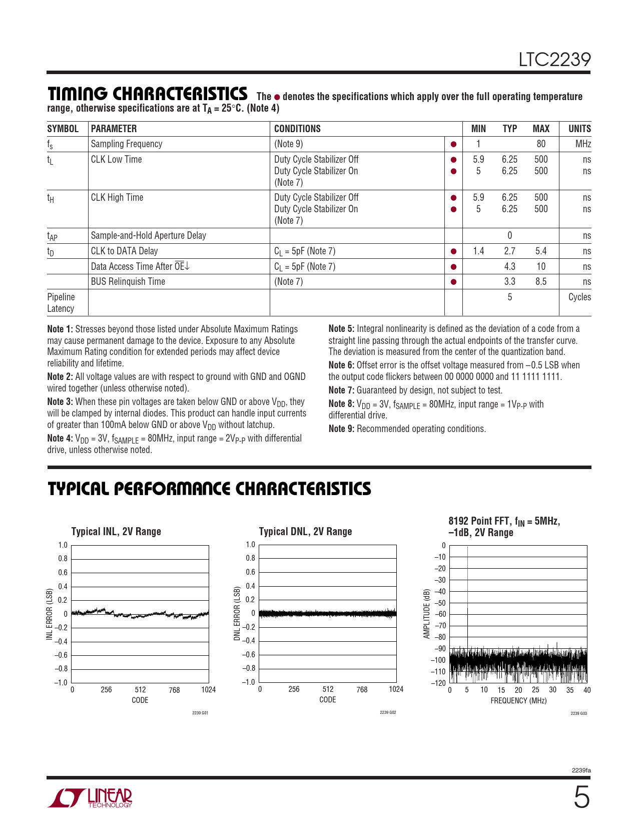

W U. TI I G CHARACTERISTICS The. denotes the specifications which apply over the full operating temperature
W U TI I G CHARACTERISTICS The denotes the specifications which apply over the full operating temperature
LTC2239
C. (Note 4) SYMBOL PARAMETER CONDITIONS MIN TYP MAX UNITS
fs Sampling Frequency (Note 9) ● 1 80 MHz tL CLK Low Time Duty Cycle Stabilizer Off ● 5.9 6.25 500 ns Duty Cycle Stabilizer On ● 5 6.25 500 ns (Note 7) tH CLK High Time Duty Cycle Stabilizer Off ● 5.9 6.25 500 ns Duty Cycle Stabilizer On ● 5 6.25 500 ns (Note 7) tAP Sample-and-Hold Aperture Delay 0 ns tD CLK to DATA Delay CL = 5pF (Note 7) ● 1.4 2.7 5.4 ns Data Access Time After OE↓ CL = 5pF (Note 7) ● 4.3 10 ns BUS Relinquish Time (Note 7) ● 3.3 8.5 ns Pipeline 5 Cycles Latency
Note 1:
Note 5:
Integral nonlinearity is defined as the deviation of a code from a may cause permanent damage to the device. Exposure to any Absolute straight line passing through the actual endpoints of the transfer curve. Maximum Rating condition for extended periods may affect device The deviation is measured from the center of the quantization band. reliability and lifetime.
Note 6:
Offset error is the offset voltage measured from –0.5 LSB when
Note 2:
All voltage values are with respect to ground with GND and OGND the output code flickers between 00 0000 0000 and 11 1111 1111. wired together (unless otherwise noted).
Note 7:
Guaranteed by design, not subject to test.
Note 3:
When these pin voltages are taken below GND or above VDD, they
Note 8:
VDD = 3V, fSAMPLE = 80MHz, input range = 1VP-P with will be clamped by internal diodes. This product can handle input currents differential drive. of greater than 100mA below GND or above VDD without latchup.
Note 9:
Recommended operating conditions.
Note 4:
VDD = 3V, fSAMPLE = 80MHz, input range = 2VP-P with differential drive, unless otherwise noted.
W U TYPICAL PERFOR A CE CHARACTERISTICS 8192 Point FFT, fIN = 5MHz, Typical INL, 2V Range Typical DNL, 2V Range –1dB, 2V Range
1.0 1.0 0 0.8 0.8 –10 –20 0.6 0.6 –30 0.4 0.4 –40 0.2 0.2 –50 0 0 –60 –0.2 –0.2 –70 INL ERROR (LSB) AMPLITUDE (dB) –80 –0.4 DNL ERROR (LSB) –0.4 –90 –0.6 –0.6 –100 –0.8 –0.8 –110 –1.0 –1.0 –120 0 256 512 768 1024 0 256 512 768 1024 0 5 10 15 20 25 30 35 40 CODE CODE FREQUENCY (MHz) 2239 G01 2239 G02 2239 G03 2239fa 5
