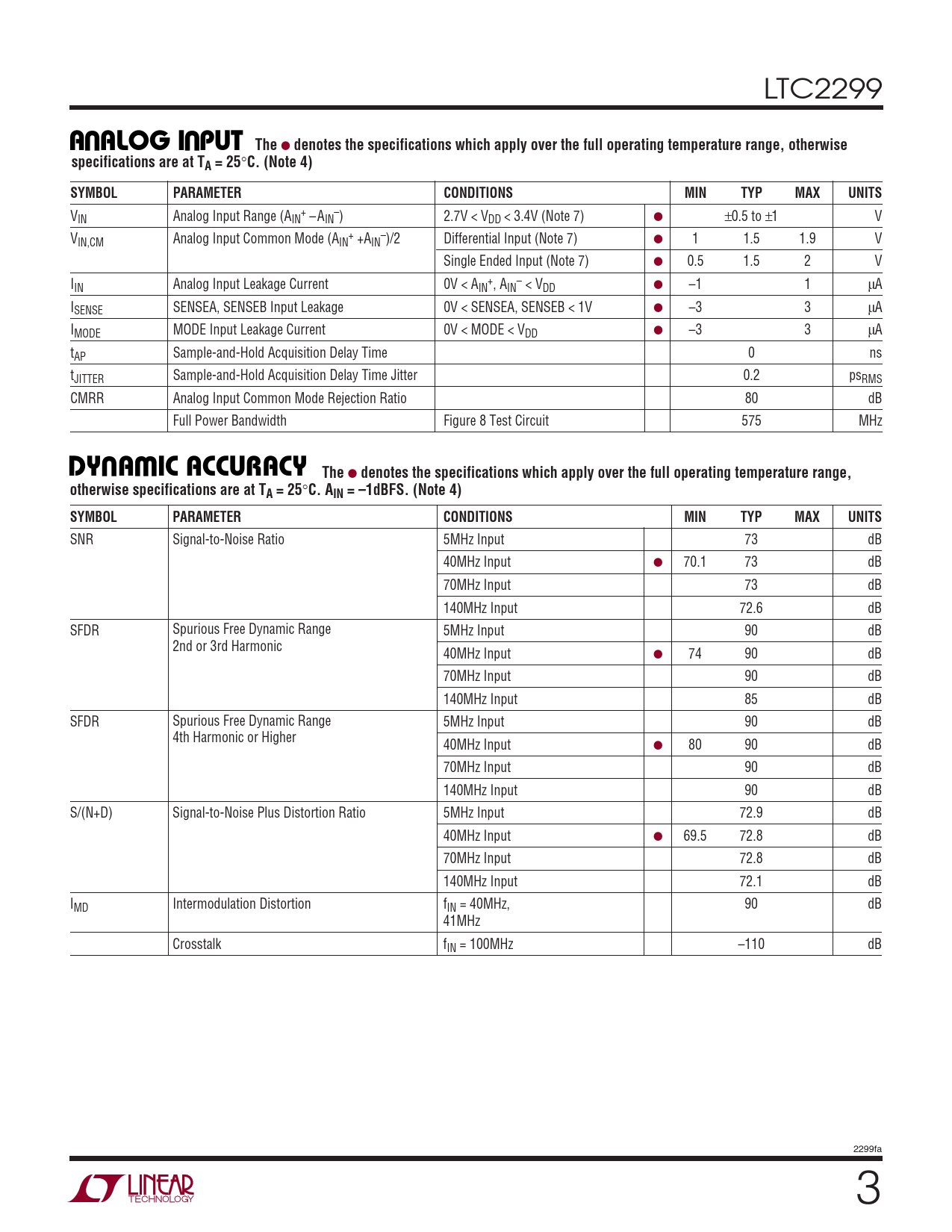

DescriptionDual 14-Bit, 80Msps Low Power 3V ADC
Pages / Page24 / 3 — A ALOG I PUT The. denotes the specifications which apply over the full …
File Format / SizePDF / 730 Kb
A ALOG I PUT The. denotes the specifications which apply over the full operating temperature range, otherwise
A ALOG I PUT The denotes the specifications which apply over the full operating temperature range, otherwise
LTC2299
U U A ALOG I PUT The
C. (Note 4) SYMBOL PARAMETER CONDITIONS MIN TYP MAX UNITS
V + – IN Analog Input Range (AIN –AIN ) 2.7V < VDD < 3.4V (Note 7) ● ±0.5 to ±1 V V + – IN,CM Analog Input Common Mode (AIN +AIN )/2 Differential Input (Note 7) ● 1 1.5 1.9 V Single Ended Input (Note 7) ● 0.5 1.5 2 V I + – IN Analog Input Leakage Current 0V < AIN , AIN < VDD ● –1 1 µA ISENSE SENSEA, SENSEB Input Leakage 0V < SENSEA, SENSEB < 1V ● –3 3 µA IMODE MODE Input Leakage Current 0V < MODE < VDD ● –3 3 µA tAP Sample-and-Hold Acquisition Delay Time 0 ns tJITTER Sample-and-Hold Acquisition Delay Time Jitter 0.2 psRMS CMRR Analog Input Common Mode Rejection Ratio 80 dB Full Power Bandwidth Figure 8 Test Circuit 575 MHz
U W DY A IC ACCURACY The
C. AIN = –1dBFS. (Note 4) SYMBOL PARAMETER CONDITIONS MIN TYP MAX UNITS
SNR Signal-to-Noise Ratio 5MHz Input 73 dB 40MHz Input ● 70.1 73 dB 70MHz Input 73 dB 140MHz Input 72.6 dB SFDR Spurious Free Dynamic Range 5MHz Input 90 dB 2nd or 3rd Harmonic 40MHz Input ● 74 90 dB 70MHz Input 90 dB 140MHz Input 85 dB SFDR Spurious Free Dynamic Range 5MHz Input 90 dB 4th Harmonic or Higher 40MHz Input ● 80 90 dB 70MHz Input 90 dB 140MHz Input 90 dB S/(N+D) Signal-to-Noise Plus Distortion Ratio 5MHz Input 72.9 dB 40MHz Input ● 69.5 72.8 dB 70MHz Input 72.8 dB 140MHz Input 72.1 dB IMD Intermodulation Distortion fIN = 40MHz, 90 dB 41MHz Crosstalk fIN = 100MHz –110 dB 2299fa 3
