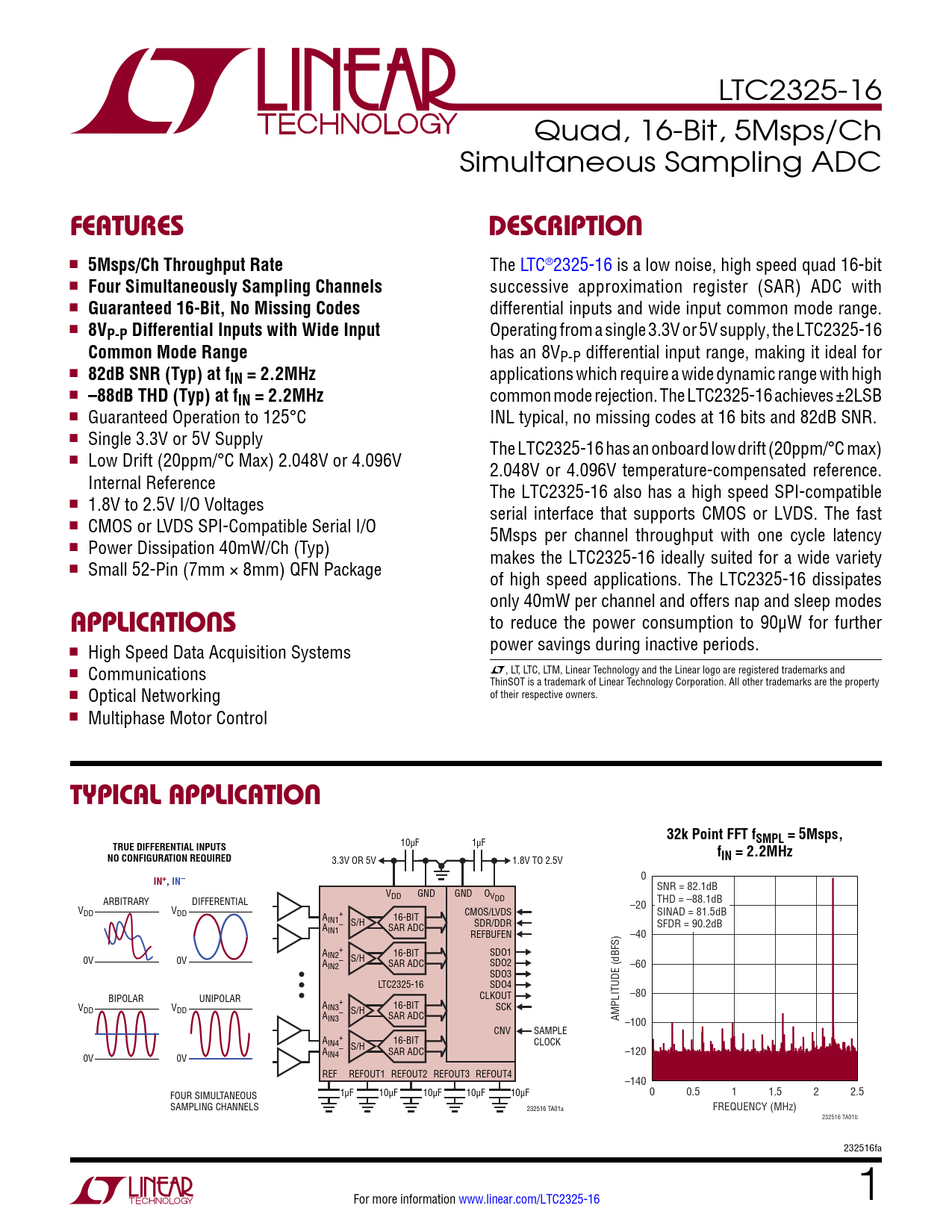

TYPICAL APPLICATION 32k Point FFT fSMPL = 5Msps, TRUE DIFFERENTIAL INPUTS
10µF 1µF
f NO CONFIGURATION REQUIRED IN = 2.2MHz
3.3V OR 5V 1.8V TO 2.5V
IN+, IN–
0 SNR = 82.1dB VDD GND GND O ARBITRARY DIFFERENTIAL VDD THD = –88.1dB V –20 DD VDD A + CMOS/LVDS SINAD = 81.5dB IN1 A – S/H 16-BIT SDR/DDR SFDR = 90.2dB IN1 SAR ADC REFBUFEN –40 A + 16-BIT SDO1 0V 0V IN2 A – S/H IN2 SAR ADC SDO2 –60 SDO3 LTC2325-16 SDO4 BIPOLAR UNIPOLAR CLKOUT –80 + VDD VDD AIN3 SCK A – S/H 16-BIT IN3 SAR ADC AMPLITUDE (dBFS) –100 CNV SAMPLE A + IN4 CLOCK A – S/H 16-BIT SAR ADC –120 0V 0V IN4 REF REFOUT1 REFOUT2 REFOUT3 REFOUT4 –140 FOUR SIMULTANEOUS 1µF 10µF 10µF 10µF 10µF 0 0.5 1 1.5 2 2.5 SAMPLING CHANNELS 232516 TA01a FREQUENCY (MHz) 232516 TA01b 232516fa For more information www.linear.com/LTC2325-16 1 Document Outline Features Applications Typical Application Description Absolute Maximum Ratings Order Information Pin Configuration Electrical Characteristics Converter Characteristics Digital Inputs And Digital Outputs Power Requirements ADC Timing Characteristics Typical Performance Characteristics Pin Functions Functional Block Diagram Timing Diagram Applications Information Package Description Typical Application Related Parts
