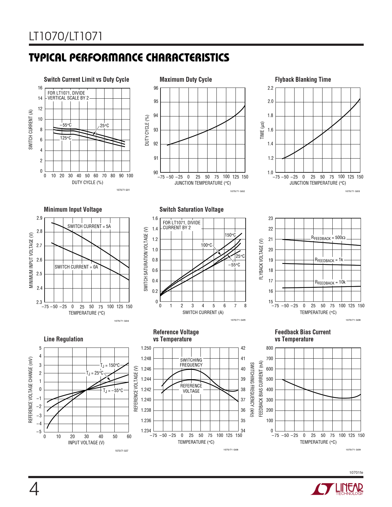

TYPICAL PERFORMANCE CHARACTERISTICS. Switch Current Limit vs Duty Cycle. Maximum Duty Cycle. Flyback Blanking Time
TYPICAL PERFORMANCE CHARACTERISTICS Switch Current Limit vs Duty Cycle Maximum Duty Cycle Flyback Blanking Time
LT1070/LT1071
W U TYPICAL PERFORMANCE CHARACTERISTICS Switch Current Limit vs Duty Cycle Maximum Duty Cycle Flyback Blanking Time
16 96 2.2 FOR LT1071, DIVIDE 14 VERTICAL SCALE BY 2 95 2.0 12 94 1.8 10 – 55°C 25°C µs) 8 93 1.6 TIME ( 6 125°C DUTY CYCLE (%) 92 1.4 SWITCH CURRENT (A) 4 91 1.2 2 0 90 1.0 0 10 20 30 40 50 60 70 80 90 100 –75 – 50 – 25 0 25 50 75 100 125 150 –75 – 50 – 25 0 25 50 75 100 125 150 DUTY CYCLE (%) JUNCTION TEMPERATURE (°C) JUNCTION TEMPERATURE (°C) 1070/71 G01 1070/71 G02 1070/71 G03
Minimum Input Voltage Switch Saturation Voltage
2.9 1.6 23 FOR LT1071, DIVIDE SWITCH CURRENT = 5A 1.4 CURRENT BY 2 22 2.8 150°C 1.2 21 RFEEDBACK = 500Ω 2.7 100°C 1.0 20 25°C 2.6 0.8 19 RFEEDBACK = 1k SWITCH CURRENT = 0A – 55°C 0.6 18 2.5 FLYBACK VOLTAGE (V) 0.4 17 RFEEDBACK = 10k MINIMUM INPUT VOLTAGE (V) 2.4 SWITCH SATURATION VOLTAGE (V) 0.2 16 2.3 0 15 –75 – 50 – 25 0 25 50 75 100 125 150 0 1 2 3 4 5 6 7 8 – 75 – 50 – 25 0 25 50 75 100 125 150 TEMPERATURE (°C) SWITCH CURRENT (A) TEMPERATURE (°C) 1070/71 G05 1070/71 G04 1070/71 G06
Reference Voltage Feedback Bias Current Line Regulation vs Temperature vs Temperature
5 1.250 42 800 4 1.248 41 700 SWITCHING SWITCHING FREQUENCY (kHz) 3 TJ = 150°C FREQUENCY 1.246 40 600 2 TJ = 25°C 1.244 39 500 1 REFERENCE 0 T 1.242 38 400 J = – 55°C V0LTAGE –1 1.240 37 300 – 2 REFERENCE VOLTAGE (V) 1.238 36 200 – 3 FEEDBACK BIAS CURRENT (nA) REFERENCE VOLTAGE CHANGE (mV) 1.236 35 100 – 4 – 5 1.234 34 0 0 10 20 30 40 50 60 – 75 – 50 – 25 0 25 50 75 100 125 150 – 75 – 50 – 25 0 25 50 75 100 125 150 INPUT VOLTAGE (V) TEMPERATURE (°C) TEMPERATURE (°C) 1070/71 G08 1070/71 G07 1070/71 G09 10701fe 4
