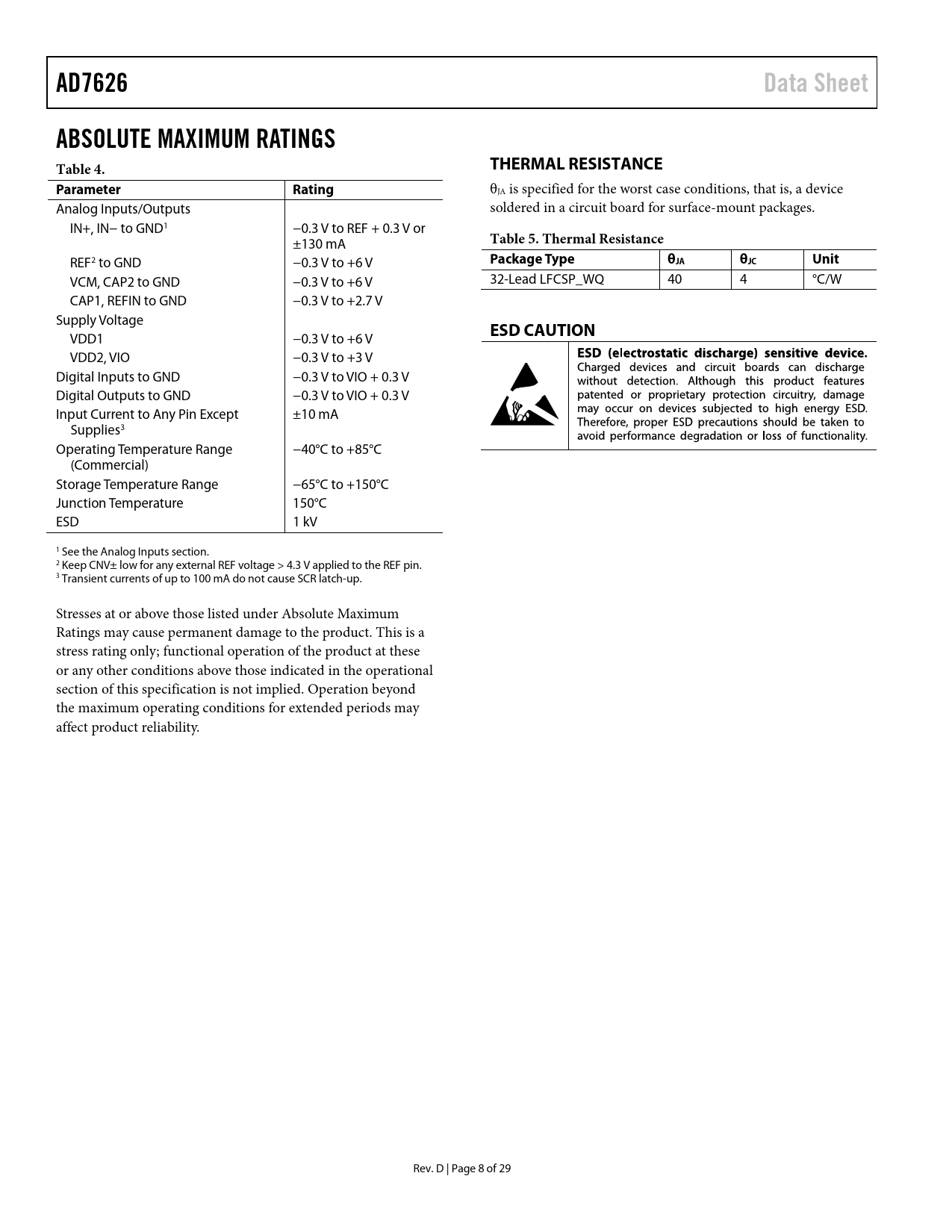

AD7626. Data Sheet. ABSOLUTE MAXIMUM RATINGS Table 4. THERMAL RESISTANCE. Parameter. Rating. Table 5. Thermal Resistance
AD7626 Data Sheet ABSOLUTE MAXIMUM RATINGS Table 4 THERMAL RESISTANCE Parameter Rating Table 5 Thermal Resistance
link to page 18
AD7626 Data Sheet ABSOLUTE MAXIMUM RATINGS Table 4. THERMAL RESISTANCE Parameter Rating
θJA is specified for the worst case conditions, that is, a device Analog Inputs/Outputs soldered in a circuit board for surface-mount packages. IN+, IN− to GND1 −0.3 V to REF + 0.3 V or ±130 mA
REF2 to GND −0.3 V to +6 V
Package Type θJA θJC Unit
VCM, CAP2 to GND −0.3 V to +6 V 32-Lead LFCSP_WQ 40 4 °C/W CAP1, REFIN to GND −0.3 V to +2.7 V Supply Voltage
