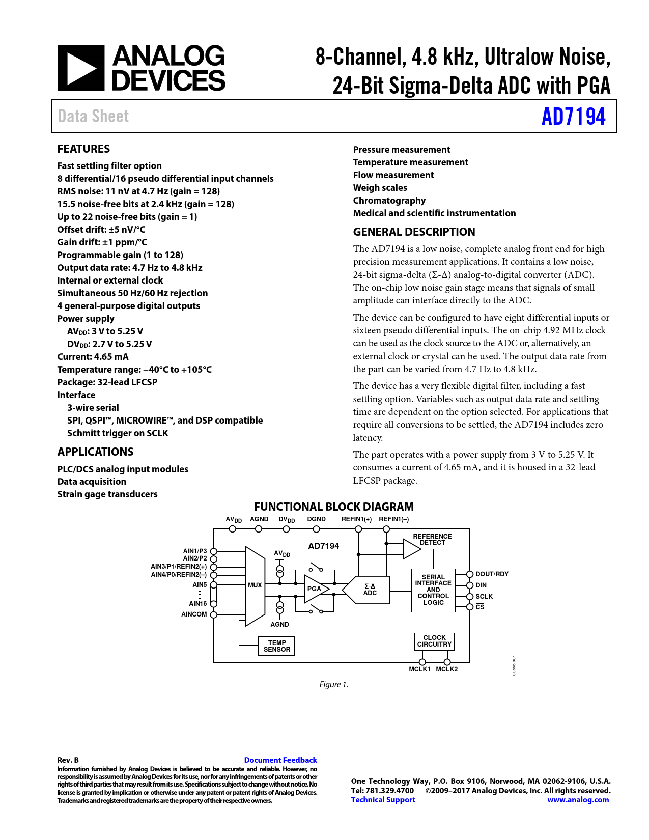

8-Channel, 4.8 kHz, Ultralow Noise,. 24-Bit Sigma-Delta ADC with PGA. Data Sheet. AD7194. FEATURES. Pressure measurement
Datasheet AD7194 Analog Devices, Revision: B
8-Channel, 4.8 kHz, Ultralow Noise, 24-Bit Sigma-Delta ADC with PGA Data Sheet AD7194 FEATURES Pressure measurement Fast settling filter option Temperature measurement 8 differential/16 pseudo differential input channels Flow measurement RMS noise: 11 nV at 4.7 Hz (gain = 128) Weigh scales 15.5 noise-free bits at 2.4 kHz (gain = 128) Chromatography Up to 22 noise-free bits (gain = 1) Medical and scientific instrumentation Offset drift: ±5 nV/°C GENERAL DESCRIPTION Gain drift: ±1 ppm/°C
The AD7194 is a low noise, complete analog front end for high
Programmable gain (1 to 128)
precision measurement applications. It contains a low noise,
Output data rate: 4.7 Hz to 4.8 kHz
24-bit sigma-delta (Σ-Δ) analog-to-digital converter (ADC).
Internal or external clock Simultaneous 50 Hz/60 Hz rejection
The on-chip low noise gain stage means that signals of small
4 general-purpose digital outputs
amplitude can interface directly to the ADC.
Power supply
The device can be configured to have eight differential inputs or
AVDD: 3 V to 5.25 V
sixteen pseudo differential inputs. The on-chip 4.92 MHz clock
DVDD: 2.7 V to 5.25 V
can be used as the clock source to the ADC or, alternatively, an
Current: 4.65 mA
external clock or crystal can be used. The output data rate from
Temperature range: −40°C to +105°C
the part can be varied from 4.7 Hz to 4.8 kHz.
Package: 32-lead LFCSP
The device has a very flexible digital filter, including a fast
Interface
settling option. Variables such as output data rate and settling
3-wire serial
time are dependent on the option selected. For applications that
SPI, QSPI™, MICROWIRE™, and DSP compatible
require al conversions to be settled, the AD7194 includes zero
Schmitt trigger on SCLK
latency.
APPLICATIONS
The part operates with a power supply from 3 V to 5.25 V. It
PLC/DCS analog input modules
consumes a current of 4.65 mA, and it is housed in a 32-lead
Data acquisition
LFCSP package.
Strain gage transducers FUNCTIONAL BLOCK DIAGRAM AV DV DD AGND DD DGND REFIN1(+) REFIN1(–) REFERENCE AD7194 DETECT AIN1/P3 AVDD AIN2/P2 AIN3/P1/REFIN2(+) AIN4/P0/REFIN2(–) SERIAL DOUT/RDY INTERFACE AIN5 MUX DIN Σ-Δ PGA AND ADC CONTROL SCLK LOGIC AIN16 CS AINCOM AGND CLOCK TEMP CIRCUITRY SENSOR
