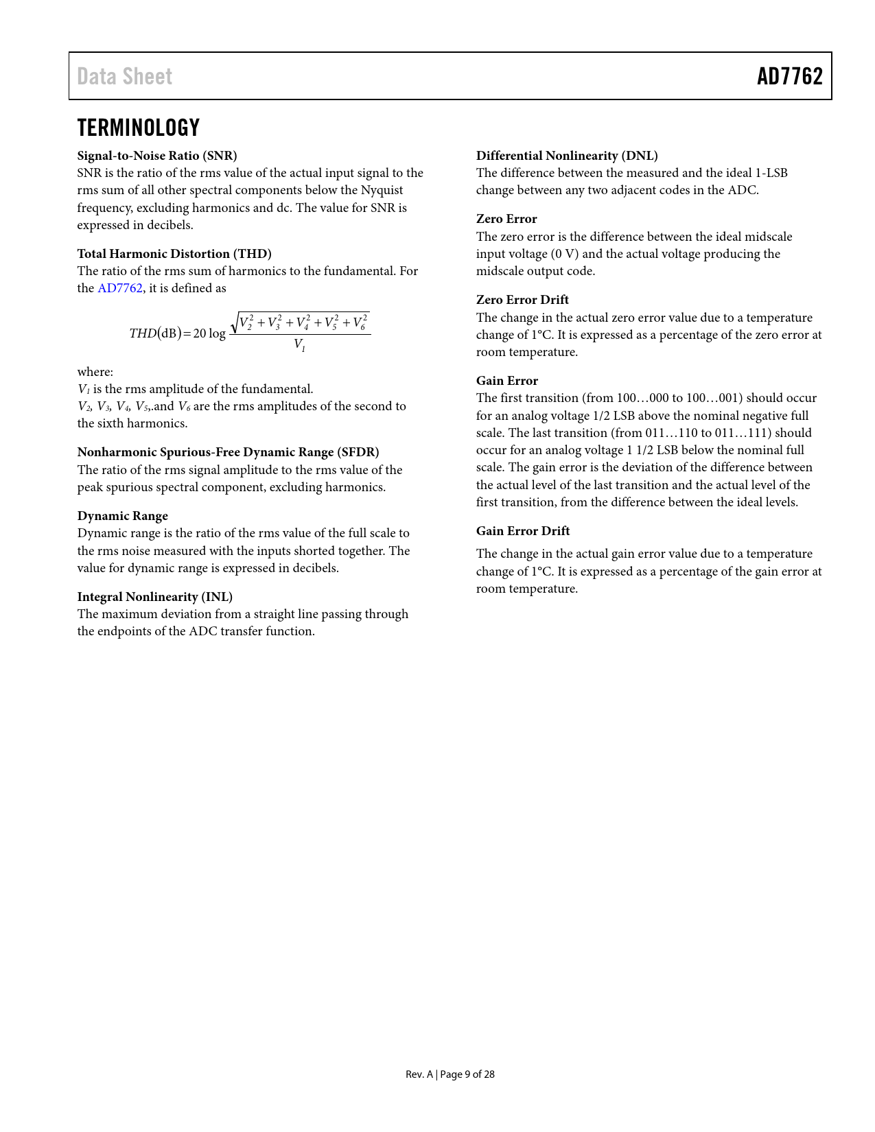

Data Sheet. AD7762. TERMINOLOGY Signal-to-Noise Ratio (SNR). Differential Nonlinearity (DNL). Zero Error
Data Sheet AD7762 TERMINOLOGY Signal-to-Noise Ratio (SNR) Differential Nonlinearity (DNL) Zero Error
SNR is the ratio of the rms value of the actual input signal to the The difference between the measured and the ideal 1-LSB rms sum of all other spectral components below the Nyquist change between any two adjacent codes in the ADC. frequency, excluding harmonics and dc. The value for SNR is expressed in decibels.
Zero Error
The zero error is the difference between the ideal midscale
Total Harmonic Distortion (THD)
input voltage (0 V) and the actual voltage producing the The ratio of the rms sum of harmonics to the fundamental. For midscale output code. the AD7762, it is defined as
Zero Error Drift
2 2 2 2 2 + + + + The change in the actual zero error value due to a temperature THD(dB) 2 V 3 V 4 V 5 V 6 V = 20 log change of 1°C. It is expressed as a percentage of the zero error at 1 V room temperature. where: V
Gain Error
1 is the rms amplitude of the fundamental. V The first transition (from 100…000 to 100…001) should occur 2, V3, V4, V5,.and V6 are the rms amplitudes of the second to the sixth harmonics. for an analog voltage 1/2 LSB above the nominal negative ful scale. The last transition (from 011…110 to 011…111) should
Nonharmonic Spurious-Free Dynamic Range (SFDR)
occur for an analog voltage 1 1/2 LSB below the nominal full The ratio of the rms signal amplitude to the rms value of the scale. The gain error is the deviation of the difference between peak spurious spectral component, excluding harmonics. the actual level of the last transition and the actual level of the first transition, from the difference between the ideal levels.
Dynamic Range
Dynamic range is the ratio of the rms value of the full scale to
Gain Error Drift
the rms noise measured with the inputs shorted together. The The change in the actual gain error value due to a temperature value for dynamic range is expressed in decibels. change of 1°C. It is expressed as a percentage of the gain error at
Integral Nonlinearity (INL)
room temperature. The maximum deviation from a straight line passing through the endpoints of the ADC transfer function.
