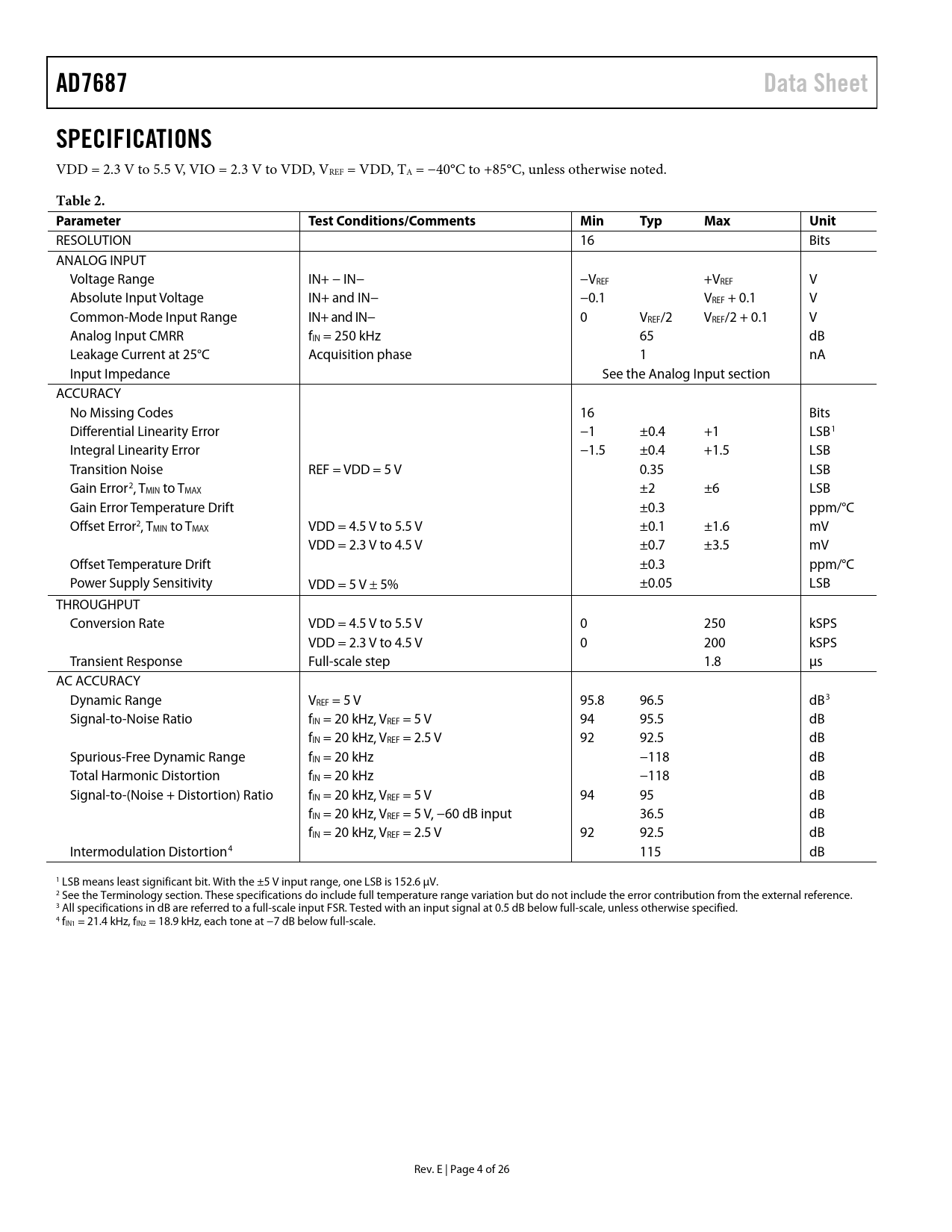

AD7687 Data Sheet SPECIFICATIONS
VDD = 2.3 V to 5.5 V, VIO = 2.3 V to VDD, VREF = VDD, TA = −40°C to +85°C, unless otherwise noted.
Table 2. Parameter Test Conditions/Comments Min Typ Max Unit
RESOLUTION 16 Bits ANALOG INPUT Voltage Range IN+ − IN− −VREF +VREF V Absolute Input Voltage IN+ and IN− −0.1 VREF + 0.1 V Common-Mode Input Range IN+ and IN− 0 VREF/2 VREF/2 + 0.1 V Analog Input CMRR fIN = 250 kHz 65 dB Leakage Current at 25°C Acquisition phase 1 nA Input Impedance See the Analog Input section ACCURACY No Missing Codes 16 Bits Differential Linearity Error −1 ±0.4 +1 LSB1 Integral Linearity Error −1.5 ±0.4 +1.5 LSB Transition Noise REF = VDD = 5 V 0.35 LSB Gain Error2, TMIN to TMAX ±2 ±6 LSB Gain Error Temperature Drift ±0.3 ppm/°C Offset Error2, TMIN to TMAX VDD = 4.5 V to 5.5 V ±0.1 ±1.6 mV VDD = 2.3 V to 4.5 V ±0.7 ±3.5 mV Offset Temperature Drift ±0.3 ppm/°C Power Supply Sensitivity VDD = 5 V ± 5% ±0.05 LSB THROUGHPUT Conversion Rate VDD = 4.5 V to 5.5 V 0 250 kSPS VDD = 2.3 V to 4.5 V 0 200 kSPS Transient Response Full-scale step 1.8 µs AC ACCURACY Dynamic Range VREF = 5 V 95.8 96.5 dB3 Signal-to-Noise Ratio fIN = 20 kHz, VREF = 5 V 94 95.5 dB fIN = 20 kHz, VREF = 2.5 V 92 92.5 dB Spurious-Free Dynamic Range fIN = 20 kHz −118 dB Total Harmonic Distortion fIN = 20 kHz −118 dB Signal-to-(Noise + Distortion) Ratio fIN = 20 kHz, VREF = 5 V 94 95 dB fIN = 20 kHz, VREF = 5 V, −60 dB input 36.5 dB fIN = 20 kHz, VREF = 2.5 V 92 92.5 dB Intermodulation Distortion4 115 dB 1 LSB means least significant bit. With the ±5 V input range, one LSB is 152.6 µV. 2 See the Terminology section. These specifications do include full temperature range variation but do not include the error contribution from the external reference. 3 All specifications in dB are referred to a full-scale input FSR. Tested with an input signal at 0.5 dB below full-scale, unless otherwise specified. 4 fIN1 = 21.4 kHz, fIN2 = 18.9 kHz, each tone at −7 dB below full-scale. Rev. E | Page 4 of 26 Document Outline FEATURES APPLICATIONS TYPICAL APPLICATION CIRCUIT GENERAL DESCRIPTION TABLE OF CONTENTS REVISION HISTORY SPECIFICATIONS TIMING SPECIFICATIONS Timing Diagrams ABSOLUTE MAXIMUM RATINGS THERMAL RESISTANCE ESD CAUTION PIN CONFIGURATIONS AND FUNCTION DESCRIPTIONS TERMINOLOGY TYPICAL PERFORMANCE CHARACTERISTICS THEORY OF OPERATION CIRCUIT INFORMATION CONVERTER OPERATION Transfer Functions TYPICAL CONNECTION DIAGRAM ANALOG INPUT DRIVER AMPLIFIER CHOICE SINGLE-TO-DIFFERENTIAL DRIVER VOLTAGE REFERENCE INPUT POWER SUPPLY SUPPLYING THE ADC FROM THE REFERENCE DIGITAL INTERFACE CS\ MODE, 3-WIRE WITHOUT BUSY INDICATOR CS\ MODE, 3-WIRE WITH BUSY INDICATOR CS\ MODE, 4-WIRE WITHOUT BUSY INDICATOR CS\ MODE, 4-WIRE WITH BUSY INDICATOR CHAIN MODE WITHOUT BUSY INDICATOR CHAIN MODE WITH BUSY INDICATOR APPLICATIONS INFORMATION LAYOUT EVALUATING THE PERFORMANCE OF THE AD7687 OUTLINE DIMENSIONS ORDERING GUIDE
