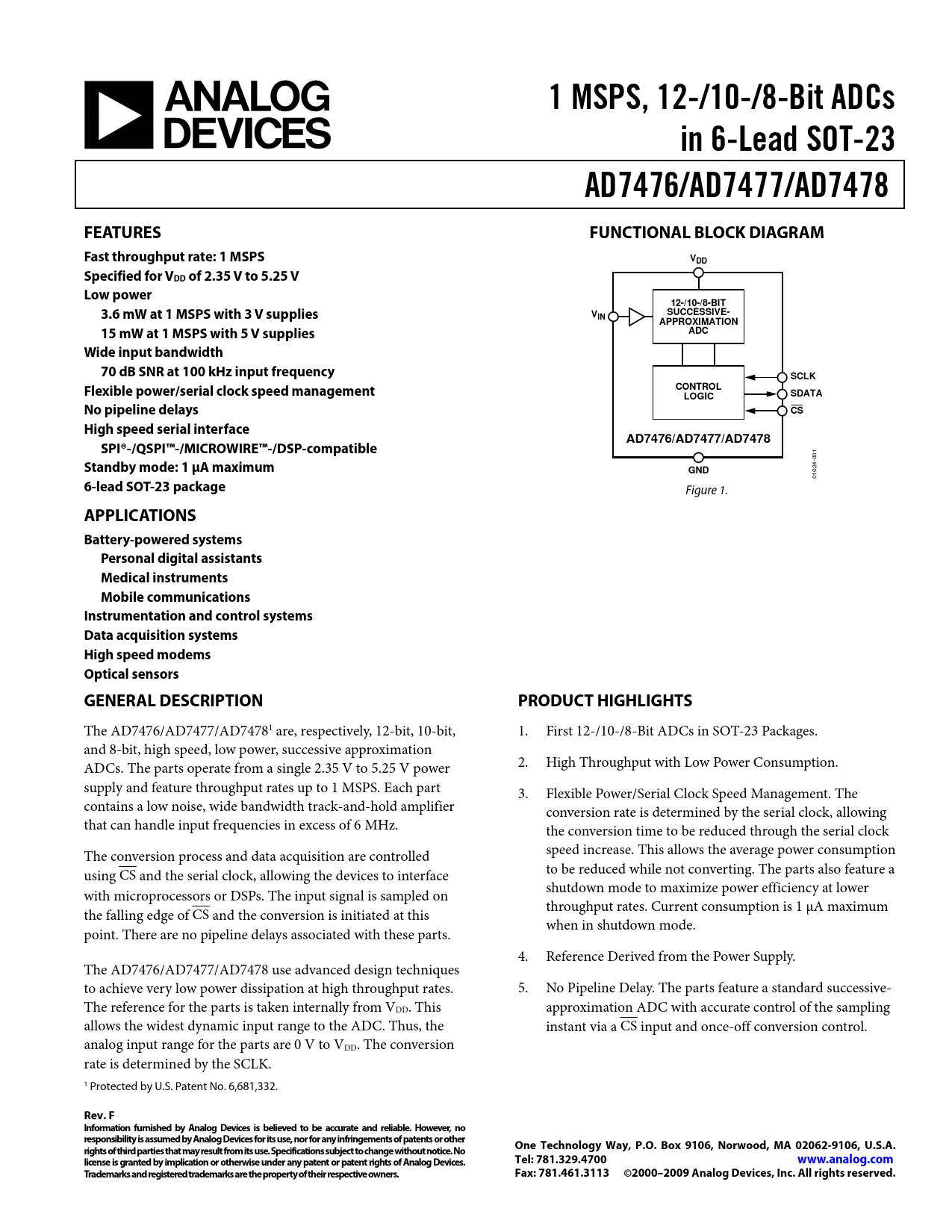

1 MSPS, 12-/10-/8-Bit ADCs in 6-Lead SOT-23 AD7476/AD7477/AD7478 FEATURES FUNCTIONAL BLOCK DIAGRAM Fast throughput rate: 1 MSPS VDD Specified for VDD of 2.35 V to 5.25 V Low power 12-/10-/8-BIT 3.6 mW at 1 MSPS with 3 V supplies SUCCESSIVE- VIN APPROXIMATION 15 mW at 1 MSPS with 5 V supplies ADC Wide input bandwidth 70 dB SNR at 100 kHz input frequency SCLK Flexible power/serial clock speed management CONTROL LOGIC SDATA No pipeline delays CS High speed serial interface AD7476/AD7477/AD7478 SPI®-/QSPI™-/MICROWIRE™-/DSP-compatible
1 -00
Standby mode: 1 μA maximum
024
GND
01
6-lead SOT-23 package
Figure 1.
APPLICATIONS Battery-powered systems Personal digital assistants Medical instruments Mobile communications Instrumentation and control systems Data acquisition systems High speed modems Optical sensors GENERAL DESCRIPTION PRODUCT HIGHLIGHTS
The AD7476/AD7477/AD74781 are, respectively, 12-bit, 10-bit, 1. First 12-/10-/8-Bit ADCs in SOT-23 Packages. and 8-bit, high speed, low power, successive approximation ADCs. The parts operate from a single 2.35 V to 5.25 V power 2. High Throughput with Low Power Consumption. supply and feature throughput rates up to 1 MSPS. Each part 3. Flexible Power/Serial Clock Speed Management. The contains a low noise, wide bandwidth track-and-hold amplifier conversion rate is determined by the serial clock, allowing that can handle input frequencies in excess of 6 MHz. the conversion time to be reduced through the serial clock The conversion process and data acquisition are controlled speed increase. This allows the average power consumption to be reduced while not converting. The parts also feature a using CS and the serial clock, allowing the devices to interface shutdown mode to maximize power efficiency at lower with microprocessors or DSPs. The input signal is sampled on throughput rates. Current consumption is 1 μA maximum the falling edge of CS and the conversion is initiated at this when in shutdown mode. point. There are no pipeline delays associated with these parts. 4. Reference Derived from the Power Supply. The AD7476/AD7477/AD7478 use advanced design techniques to achieve very low power dissipation at high throughput rates. 5. No Pipeline Delay. The parts feature a standard successive- The reference for the parts is taken internally from VDD. This approximation ADC with accurate control of the sampling allows the widest dynamic input range to the ADC. Thus, the instant via a CS input and once-off conversion control. analog input range for the parts are 0 V to VDD. The conversion rate is determined by the SCLK. 1 Protected by U.S. Patent No. 6,681,332.
