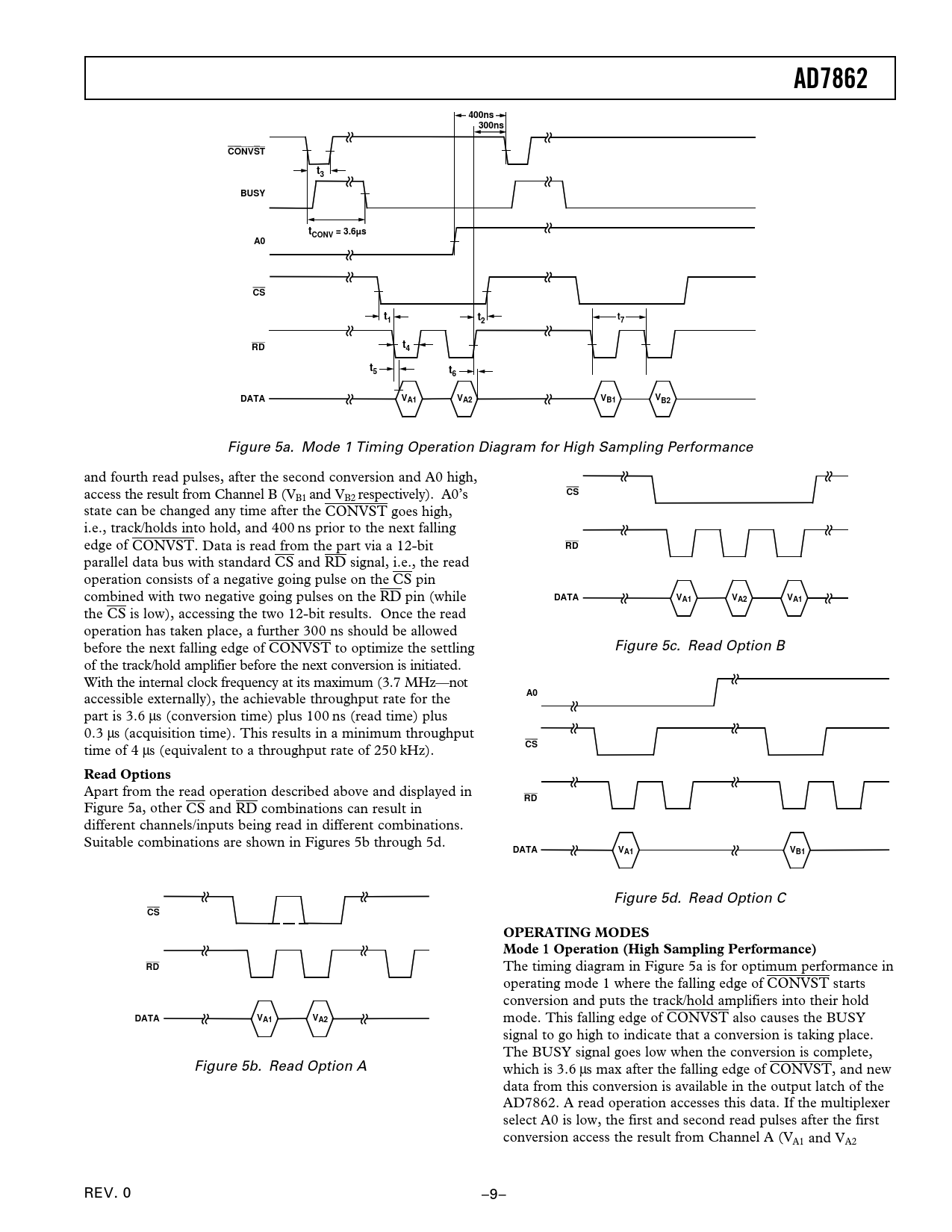

AD7862. 400ns. 300ns. CONVST. BUSY. tCONV = 3.6µs. DATA. VA1. VA2. VB1. VB2. Read Options
AD7862 400ns 300ns CONVST BUSY tCONV = 3.6µs DATA VA1 VA2 VB1 VB2 Read Options
AD7862 400ns 300ns CONVST t3 BUSY tCONV = 3.6µs A0 CS t t 1 t2 7 t RD 4 t5 t6 DATA VA1 VA2 VB1 VB2
Figure 5a. Mode 1 Timing Operation Diagram for High Sampling Performance and fourth read pulses, after the second conversion and A0 high, access the result from Channel B (V
CS
B1 and VB2 respectively). A0’s state can be changed any time after the CONVST goes high, i.e., track/holds into hold, and 400 ns prior to the next falling edge of CONVST. Data is read from the part via a 12-bit
RD
parallel data bus with standard CS and RD signal, i.e., the read operation consists of a negative going pulse on the CS pin combined with two negative going pulses on the RD pin (while
DATA VA1 VA2 VA1
the CS is low), accessing the two 12-bit results. Once the read operation has taken place, a further 300 ns should be allowed before the next falling edge of CONVST to optimize the settling Figure 5c. Read Option B of the track/hold amplifier before the next conversion is initiated. With the internal clock frequency at its maximum (3.7 MHz—not
A0
accessible externally), the achievable throughput rate for the part is 3.6 µs (conversion time) plus 100 ns (read time) plus 0.3 µs (acquisition time). This results in a minimum throughput
CS
time of 4 µs (equivalent to a throughput rate of 250 kHz).
Read Options
Apart from the read operation described above and displayed in
RD
Figure 5a, other CS and RD combinations can result in different channels/inputs being read in different combinations. Suitable combinations are shown in Figures 5b through 5d.
DATA VA1 VB1
Figure 5d. Read Option C
CS OPERATING MODES Mode 1 Operation (High Sampling Performance) RD
The timing diagram in Figure 5a is for optimum performance in operating mode 1 where the falling edge of CONVST starts conversion and puts the track/hold amplifiers into their hold
DATA VA1 VA2
mode. This falling edge of CONVST also causes the BUSY signal to go high to indicate that a conversion is taking place. The BUSY signal goes low when the conversion is complete, Figure 5b. Read Option A which is 3.6 µs max after the falling edge of CONVST, and new data from this conversion is available in the output latch of the AD7862. A read operation accesses this data. If the multiplexer select A0 is low, the first and second read pulses after the first conversion access the result from Channel A (VA1 and VA2 REV. 0 –9–
