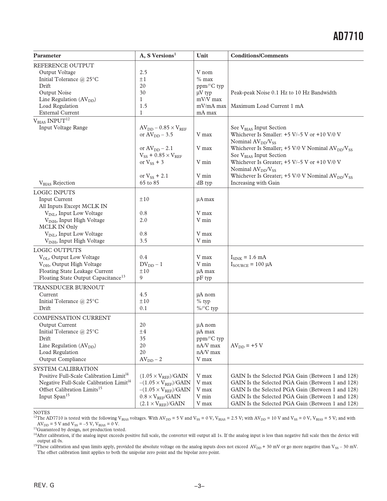

DescriptionCMOS, 24-Bit Signal Conditioning ADC with Current Source
Pages / Page33 / 4 — AD7710. Parameter. A, S Versions1. Unit. Conditions/Comments
RevisionG
File Format / SizePDF / 322 Kb
AD7710 Parameter A, S Versions1 Unit Conditions/Comments
REFERENCE OUTPUT Output Voltage 2.5 V nom Initial Tolerance @ 25°C ±1 % max Drift 20 ppm/°C typ Output Noise 30 µV typ Peak-peak Noise 0.1 Hz to 10 Hz Bandwidth Line Regulation (AVDD) 1 mV/V max Load Regulation 1.5 mV/mA max Maximum Load Current 1 mA External Current 1 mA max VBIAS INPUT12 Input Voltage Range AVDD – 0.85 × VREF See VBIAS Input Section or AVDD – 3.5 V max Whichever Is Smaller: +5 V/–5 V or +10 V/0 V Nominal AVDD/VSS or AVDD – 2.1 V max Whichever Is Smaller; +5 V/0 V Nominal AVDD/VSS VSS + 0.85 × VREF See VBIAS Input Section or VSS + 3 V min Whichever Is Greater; +5 V/–5 V or +10 V/0 V Nominal AVDD/VSS or VSS + 2.1 V min Whichever Is Greater; +5 V/0 V Nominal AVDD/VSS VBIAS Rejection 65 to 85 dB typ Increasing with Gain LOGIC INPUTS Input Current ±10 µΑ max All Inputs Except MCLK IN VINL, Input Low Voltage 0.8 V max VINH, Input High Voltage 2.0 V min MCLK IN Only VINL, Input Low Voltage 0.8 V max VINH, Input High Voltage 3.5 V min LOGIC OUTPUTS VOL, Output Low Voltage 0.4 V max ISINK = 1.6 mA VOH, Output High Voltage DVDD – 1 V min ISOURCE = 100 µA Floating State Leakage Current ±10 µA max Floating State Output Capacitance13 9 pF typ TRANSDUCER BURNOUT Current 4.5 µA nom Initial Tolerance @ 25°C ±10 % typ Drift 0.1 %/°C typ COMPENSATION CURRENT Output Current 20 µA nom Initial Tolerance @ 25°C ±4 µA max Drift 35 ppm/°C typ Line Regulation (AVDD) 20 nA/V max AVDD = +5 V Load Regulation 20 nA/V max Output Compliance AVDD – 2 V max SYSTEM CALIBRATION Positive Full-Scale Calibration Limitl4 (1.05 × VREF)/GAIN V max GAIN Is the Selected PGA Gain (Between 1 and 128) Negative Full-Scale Calibration Limitl4 –(1.05 × VREF)/GAIN V max GAIN Is the Selected PGA Gain (Between 1 and 128) Offset Calibration Limits15 –(1.05 × VREF)/GAIN V max GAIN Is the Selected PGA Gain (Between 1 and 128) Input Span15 0.8 × VREF/GAIN V min GAIN Is the Selected PGA Gain (Between 1 and 128) (2.1 × VREF)/GAIN V max GAIN Is the Selected PGA Gain (Between 1 and 128) NOTES 12The AD7710 is tested with the following VBIAS voltages. With AVDD = 5 V and VSS = 0 V, VBIAS = 2.5 V; with AVDD = 10 V and VSS = 0 V, VBIAS = 5 V; and with AVDD = 5 V and VSS = –5 V, VBIAS = 0 V. 13Guaranteed by design, not production tested. 14After calibration, if the analog input exceeds positive full scale, the converter will output all 1s. If the analog input is less than negative full scale then the device will output all 0s. 15These calibration and span limits apply, provided the absolute voltage on the analog inputs does not exceed AVDD + 30 mV or go more negative than VSS – 30 mV. The offset calibration limit applies to both the unipolar zero point and the bipolar zero point. REV. G –3– Document Outline FEATURES APPLICATIONS FUNCTIONAL BLOCK DIAGRAM GENERAL DESCRIPTION PRODUCT HIGHLIGHTS SPECIFICATIONS ABSOLUTE MAXIMUM RATINGS TIMING CHARACTERISTICS ORDERING GUIDE PIN CONFIGURATION PIN FUNCTION DESCRIPTIONS Terminology Integral Nonlinearity Positive Full-Scale Error Unipolar Offset Error Bipolar Zero Error Bipolar Negative Full-Scale Error Positive Full-Scale Overrange Negative Full-Scale Overrange Offset Calibration Range Full-Scale Calibration Range Input Span CONTROL REGISTER (24 BITS) PGA GAIN CHANNEL SELECTION Power-Down Word Length Output Compensation Current Burn-Out Current Bipolar/Unipolar Selection (Both Inputs) FILTER SELECTION (FS11–FS0) CIRCUIT DESCRIPTION THEORY OF OPERATION Input Sample Rate DIGITAL FILTERING Filter Characteristics Post Filtering Antialias Considerations ANALOG INPUT FUNCTIONS Analog Input Ranges Burnout Current Output Compensation Current Bipolar/Unipolar Inputs REFERENCE INPUT/OUTPUT VBIAS Input USING THE AD7710 SYSTEM DESIGN CONSIDERATIONS Clocking System Synchronization Accuracy Autocalibration Self-Calibration System Calibration System Offset Calibration Background Calibration Span and Offset Limits POWER-UP AND CALIBRATION Drift Considerations POWER SUPPLIES AND GROUNDING DIGITAL INTERFACE Self-Clocking Mode Read Operation Write Operation External Clocking Mode Read Operation Write Operation SIMPLIFYING THE EXTERNAL CLOCKING MODE INTERFACE MICROCOMPUTER/MICROPROCESSOR INTERFACING AD7710 to 8XC51 Interface AD7710 to 68HC11 Interface APPLICATIONS OUTLINE DIMENSIONS Revision History
