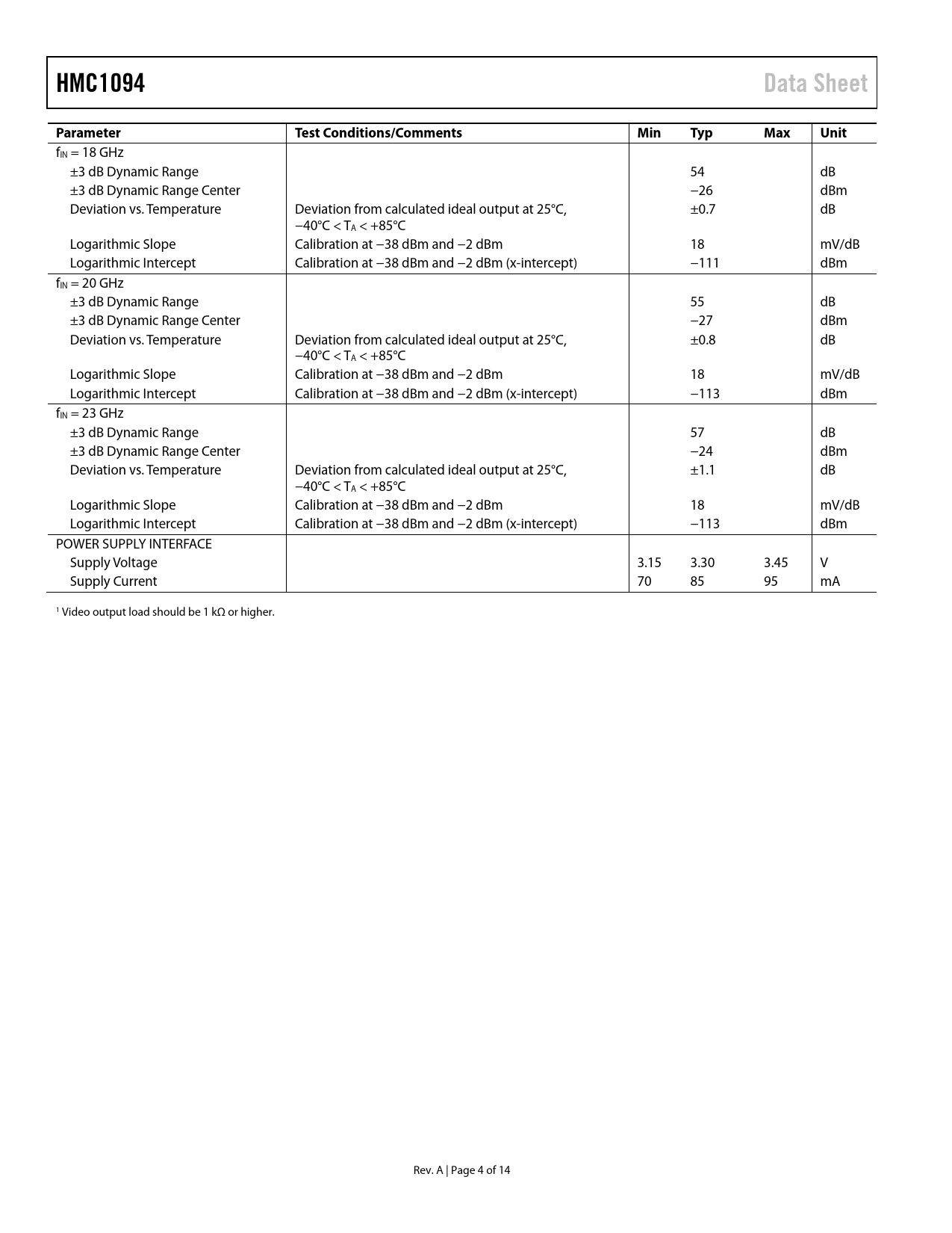

HMC1094. Data Sheet. Parameter. Test Conditions/Comments. Min. Typ. Max. Unit
HMC1094 Data Sheet Parameter Test Conditions/Comments Min Typ Max Unit
fIN = 18 GHz ±3 dB Dynamic Range 54 dB ±3 dB Dynamic Range Center −26 dBm Deviation vs. Temperature Deviation from calculated ideal output at 25°C, ±0.7 dB −40°C < TA < +85°C Logarithmic Slope Calibration at −38 dBm and −2 dBm 18 mV/dB Logarithmic Intercept Calibration at −38 dBm and −2 dBm (x-intercept) −111 dBm fIN = 20 GHz ±3 dB Dynamic Range 55 dB ±3 dB Dynamic Range Center −27 dBm Deviation vs. Temperature Deviation from calculated ideal output at 25°C, ±0.8 dB −40°C < TA < +85°C Logarithmic Slope Calibration at −38 dBm and −2 dBm 18 mV/dB Logarithmic Intercept Calibration at −38 dBm and −2 dBm (x-intercept) −113 dBm fIN = 23 GHz ±3 dB Dynamic Range 57 dB ±3 dB Dynamic Range Center −24 dBm Deviation vs. Temperature Deviation from calculated ideal output at 25°C, ±1.1 dB −40°C < TA < +85°C Logarithmic Slope Calibration at −38 dBm and −2 dBm 18 mV/dB Logarithmic Intercept Calibration at −38 dBm and −2 dBm (x-intercept) −113 dBm POWER SUPPLY INTERFACE Supply Voltage 3.15 3.30 3.45 V Supply Current 70 85 95 mA 1 Video output load should be 1 kΩ or higher. Rev. A | Page 4 of 14 Document Outline FEATURES APPLICATIONS FUNCTIONAL BLOCK DIAGRAM GENERAL DESCRIPTION TABLE OF CONTENTS REVISION HISTORY SPECIFICATIONS ABSOLUTE MAXIMUM RATINGS ESD CAUTION PIN CONFIGURATION AND FUNCTION DESCRIPTIONS INTERFACE SCHEMATICS TYPICAL PERFORMANCE CHARACTERISTICS APPLICATION AND EVALUATION PRINTED CIRCUIT BOARD (PCB) SCHEMATIC EVALUATION PCB BILL OF MATERIALS FOR EVALUATION PCB PACKAGING AND ORDERING INFORMATION OUTLINE DIMENSIONS ORDERING GUIDE
