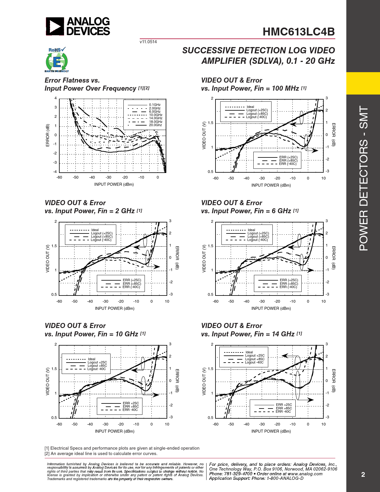

HMC613LC4B. SUCCESSIVE DETECTION LOG VIDEO. AMPLIFIER (SDLVA), 0.1 - 20 GHz. Error Flatness vs. VIDEO OUT & Error
HMC613LC4B SUCCESSIVE DETECTION LOG VIDEO AMPLIFIER (SDLVA), 0.1 - 20 GHz Error Flatness vs VIDEO OUT & Error
HMC613LC4B
v11.0514
SUCCESSIVE DETECTION LOG VIDEO AMPLIFIER (SDLVA), 0.1 - 20 GHz Error Flatness vs. VIDEO OUT & Error Input Power Over Frequency [1][2] vs. Input Power, Fin = 100 MHz [1]
4 2 3 0.1GHz 3 2.0GHz Ideal 6.0GHz Logout (+25C) 2 Logout (+85C) T 2 10.0GHz 14.0GHz Logout (-40C) 18.0GHz 1.5 1 ERROR M 1 20.0Ghz (V) (dB) S 0 OUT 0 (dB) - -1 ERROR 1 -1 VIDEO -2 RS ERR (+25C) -2 -3 ERR (+85C) ERR (-40C) O T -4 0.5 -3 -60 -50 -40 -30 -20 -10 0 -60 -50 -40 -30 -20 -10 0 10 C INPUT POWER (dBm) INPUT POWER (dBm) E T E
VIDEO OUT & Error VIDEO OUT & Error
D
vs. Input Power, Fin = 2 GHz [1] vs. Input Power, Fin = 6 GHz [1]
R 2 3 2 3 E Ideal Ideal Logout (+25C) 2 Logout (+25C) 2 Logout (+85C) Logout (+85C) W Logout (-40C) Logout (-40C) ERROR ERROR O 1.5 1 1.5 1 (V) (V) P OUT 0 OUT 0 (dB) (dB) 1 -1 VIDEO 1 -1 VIDEO ERR (+25C) -2 ERR (+25C) ERR (+85C) -2 ERR (+85C) ERR (-40C) ERR (-40C) 0.5 -3 0.5 -3 -60 -50 -40 -30 -20 -10 0 10 -60 -50 -40 -30 -20 -10 0 10 INPUT POWER (dBm) INPUT POWER (dBm)
VIDEO OUT & Error VIDEO OUT & Error vs. Input Power, Fin = 10 GHz [1] vs. Input Power, Fin = 14 GHz [1]
2 3 2 3 Ideal 2 Logout +25C 2 Ideal Logout +85C Logout +25C Logout -40C Logout +85C 1.5 Logout -40C 1 ERROR 1.5 1 ERROR (V) (V) OUT 0 OUT 0 (dB) (dB) 1 -1 VIDEO 1 -1 VIDEO ERR +25C -2 ERR +85C ERR +25C -2 ERR -40C ERR +85C ERR -40C 0.5 -3 0.5 -3 -60 -50 -40 -30 -20 -10 0 10 -60 -50 -40 -30 -20 -10 0 10 INPUT POWER (dBm) INPUT POWER (dBm) [1] Electrical Specs and performance plots are given at single-ended operation [2] An average ideal line is used to calculate error curves. I F nf o or r p mati r o in cfe ur , d nish e e l d iv b e y r A y a nalo n g d t Devi o p ces i la s c bele o ieve rd d t e o rbs e : H acc iutrtatite e M and ic reli rao bl w e. a H v o e C wever o , nrp o For price, delivery, and to place orders: Analog Devices, Inc., responsibility is assumed by Analog Devices for its use, nor for any infringements of patents or other oration, 2 Elizabeth Drive, Chelmsford, MA 01824 One Technology Way, P.O. Box 9106, Norwood, MA 02062-9106 Phone: 978-250-3343 Fax: 978-250-3373 O rights of third parties that may result from its use. Specifications subject to change without notice. No rd Phoe n r O e: 7 n- 81-li 3 n 2 e a 9-4 t w 70 ww 0 • O . rdh e itt r o it nle i . n co e a m license is granted by implication or otherwise under any patent or patent rights of Analog Devices. t www.analog.com
