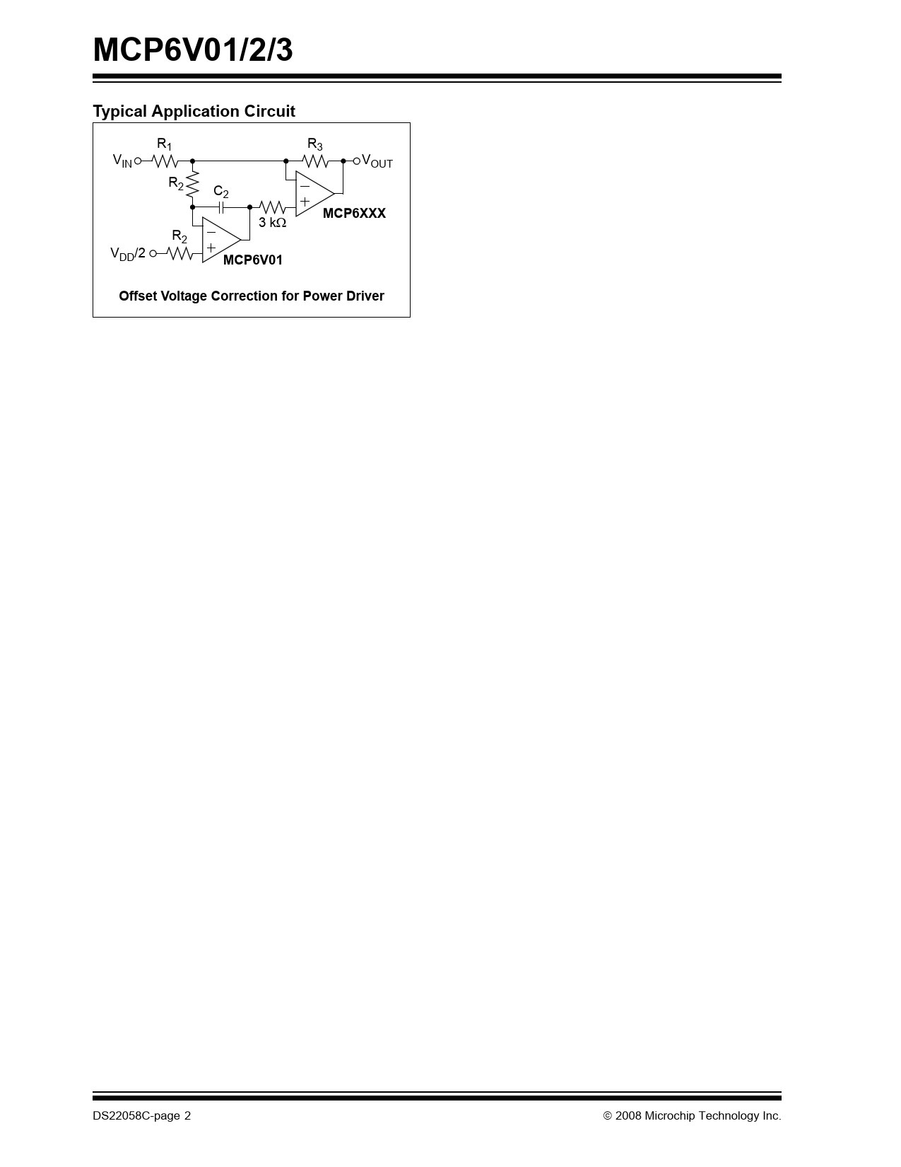

MCP6V01/2/3. Typical Application Circuit. MCP6XXX. MCP6V01. Offset Voltage Correction for Power Driver
MCP6V01/2/3 Typical Application Circuit MCP6XXX MCP6V01 Offset Voltage Correction for Power Driver
R1 R3 VIN VOUT R2 C2
MCP6XXX
3 kΩ R2 VDD/2
