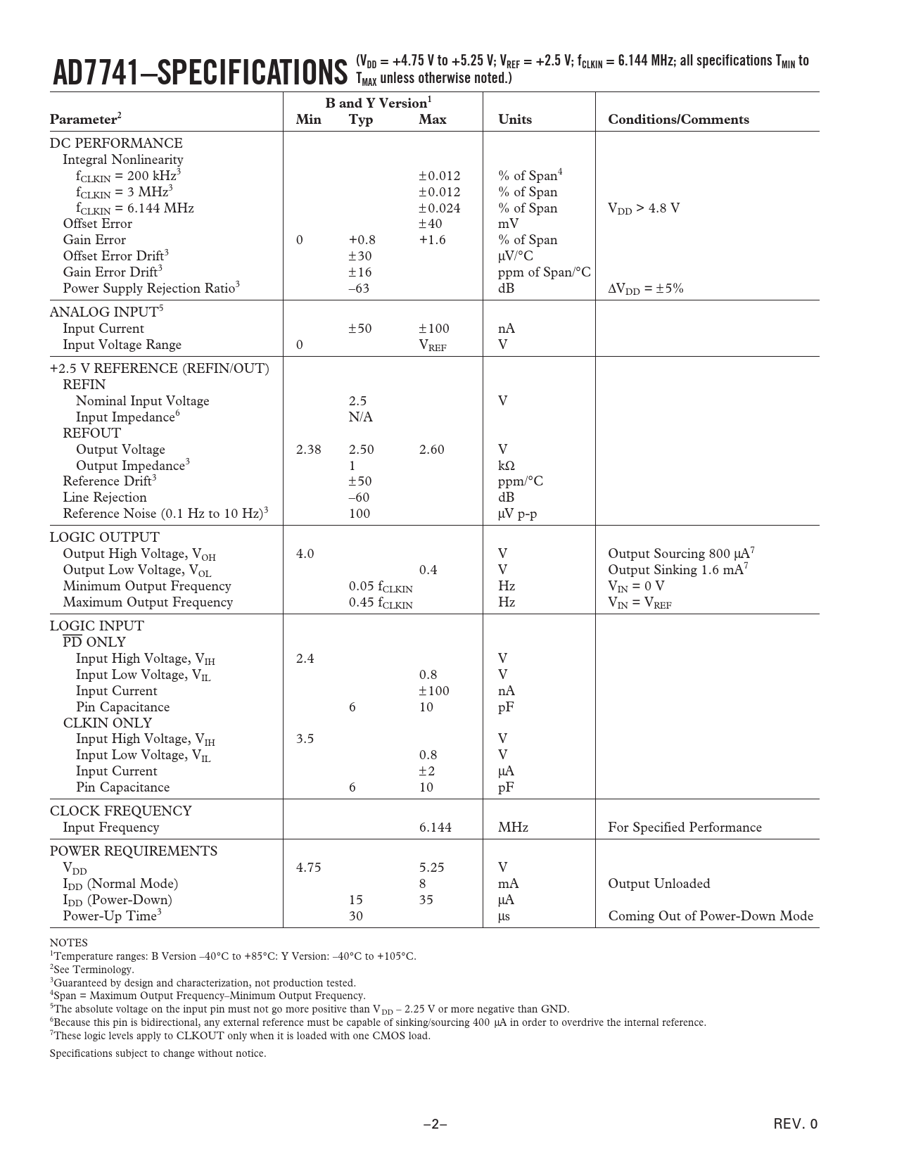

AD7741–SPECIFICATIONS (VDD = +4.75 V to +5.25 V; VREF = +2.5 V; fCLKIN = 6.144 MHz; all specifications TMIN to
AD7741–SPECIFICATIONS (VDD = +4.75 V to +5.25 V; VREF = +2.5 V; fCLKIN = 6.144 MHz; all specifications TMIN to TMAX unless otherwise noted.) B and Y Version1 Parameter2 Min Typ Max Units Conditions/Comments
