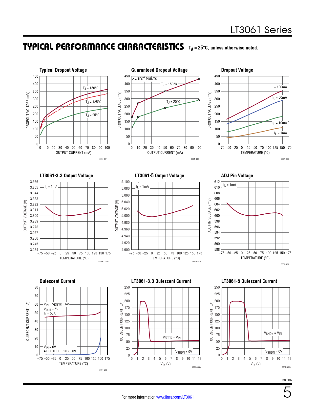

TYPICAL PERFORMANCE CHARACTERISTICS TA = 25°C, unless otherwise noted. Typical Dropout Voltage. Guaranteed Dropout Voltage
TYPICAL PERFORMANCE CHARACTERISTICS TA = 25°C, unless otherwise noted Typical Dropout Voltage Guaranteed Dropout Voltage
LT3061 Series
TYPICAL PERFORMANCE CHARACTERISTICS TA = 25°C, unless otherwise noted. Typical Dropout Voltage Guaranteed Dropout Voltage Dropout Voltage
450 450 450 = TEST POINTS 400 400 TJ = 150°C 400 T I J = 150°C L = 100mA 350 350 350 300 300 300 IL = 50mA TJ = 125°C TJ = 25°C TAGE (mV) 250 TAGE (mV) 250 TAGE (mV) 250 200 T 200 200 J = 25°C 150 150 150 IL = 10mA DROPOUT VOL 100 DROPOUT VOL 100 DROPOUT VOL 100 IL = 1mA 50 50 50 0 0 0 0 10 20 30 40 50 60 70 80 90 100 0 10 20 30 40 50 60 70 80 90 100 –75 –50 –25 0 25 50 75 100 125 150 175 OUTPUT CURRENT (mA) OUTPUT CURRENT (mA) TEMPERATURE (°C) 3061 G01 3061 G02 3061 G03
LT3061-3.3 Output Voltage LT3061-5 Output Voltage ADJ Pin Voltage
3.366 5.100 612 I I 3.355 L = 1mA IL = 1mA 610 L = 1mA 5.080 3.344 608 5.060 3.333 606 5.040 3.322 604 3.311 5.020 602 TAGE (V) TAGE (V) TAGE (mV) 3.300 5.000 600 3.289 598 4.980 3.278 596 OUTPUT VOL 4.960 OUTPUT VOL ADJ PIN VOL 3.267 594 4.940 3.256 592 3.245 4.920 590 3.234 4.900 588 –75 –50 –25 0 25 50 75 100 125 150 175 –75 –50 –25 0 25 50 75 100 125 150 175 –75 –50 –25 0 25 50 75 100 125 150 175 TEMPERATURE (°C) TEMPERATURE (°C) TEMPERATURE (°C) LT3061 G03a LT3061 G03b 3061 G04
Quiescent Current LT3061-3.3 Quiescent Current LT3061-5 Quiescent Current
80 250 250 70 225 225 200 200 60 VIN = VSHDN = 6V V 175 175 OUT = 5V 50 IL = 5µA 150 150 40 125 125 30 100 100 75 VSHDN = VIN 75 V QUIESCENT CURRENT (µA) 20 SHDN = VIN QUIESCENT CURRENT (µA) 50 QUIESCENT CURRENT (µA) 50 10 VIN = 6V 25 25 ALL OTHER PINS = 0V VSHDN = 0V VSHDN = 0V 0 0 0 –75 –50 –25 0 25 50 75 100 125 150 175 0 1 2 3 4 5 6 7 8 9 10 11 12 0 1 2 3 4 5 6 7 8 9 10 11 12 TEMPERATURE (°C) VIN (V) VIN (V) 3061 G05a 3061 G05b 3061 G05 3061fb For more information www.linear.com/LT3061 5
