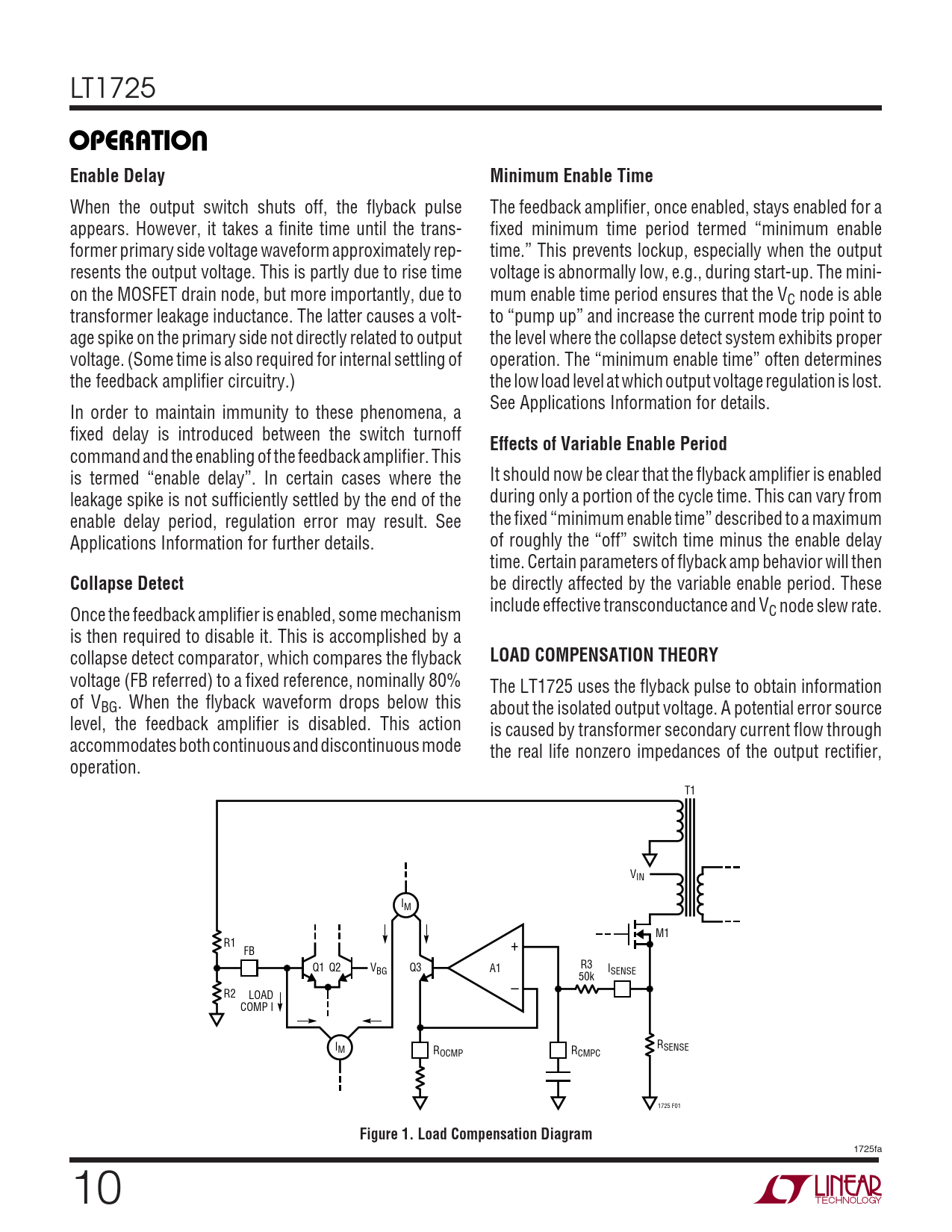

LOAD COMPENSATION THEORY
voltage (FB referred) to a fixed reference, nominally 80% The LT1725 uses the flyback pulse to obtain information of VBG. When the flyback waveform drops below this about the isolated output voltage. A potential error source level, the feedback amplifier is disabled. This action is caused by transformer secondary current flow through accommodates both continuous and discontinuous mode the real life nonzero impedances of the output rectifier, operation. T1 VIN IM M1 R1 + FB R3 Q1 Q2 VBG Q3 A1 ISENSE 50k R2 – LOAD COMP I I R M R SENSE OCMP RCMPC 1725 F01
Figure 1. Load Compensation Diagram
