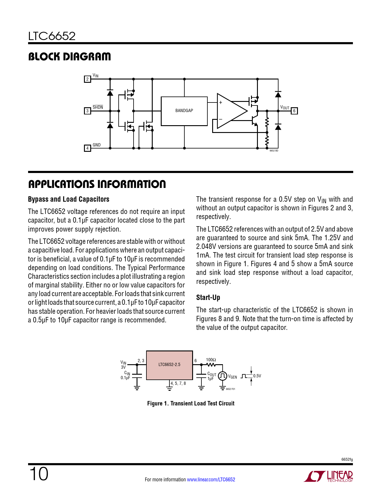

block DiagraM
VIN 2 + SHDN VOUT 3 BANDGAP 6 – GND 4 6652 BD
applications inForMation Bypass and Load Capacitors
The transient response for a 0.5V step on VIN with and The LTC6652 voltage references do not require an input without an output capacitor is shown in Figures 2 and 3, capacitor, but a 0.1µF capacitor located close to the part respectively. improves power supply rejection. The LTC6652 references with an output of 2.5V and above The LTC6652 voltage references are stable with or without are guaranteed to source and sink 5mA. The 1.25V and a capacitive load. For applications where an output capaci- 2.048V versions are guaranteed to source 5mA and sink tor is beneficial, a value of 0.1µF to 10µF is recommended 1mA. The test circuit for transient load step response is depending on load conditions. The Typical Performance shown in Figure 1. Figures 4 and 5 show a 5mA source Characteristics section includes a plot illustrating a region and sink load step response without a load capacitor, of marginal stability. Either no or low value capacitors for respectively. any load current are acceptable. For loads that sink current
Start-Up
or light loads that source current, a 0.1µF to 10µF capacitor has stable operation. For heavier loads that source current The start-up characteristic of the LTC6652 is shown in a 0.5µF to 10µF capacitor range is recommended. Figures 8 and 9. Note that the turn-on time is affected by the value of the output capacitor. V 2, 3 6 100Ω IN LTC6652-2.5 3V CIN COUT 0.1µF 1µF VGEN 0.5V 4, 5, 7, 8 6652 F01
Figure 1. Transient Load Test Circuit
