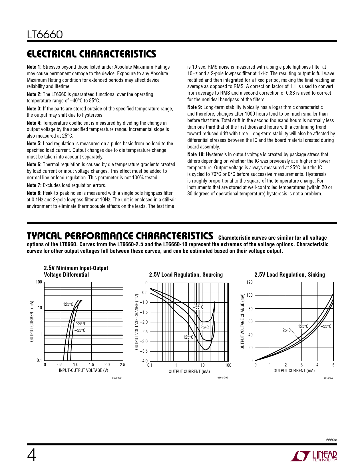

ELECTRICAL CHARACTERISTICS Note 1:. Note 2:. Note 3:. Note 9:. Note 4:. Note 5:. Note 10:. Note 6:. Note 7:. Note 8:
ELECTRICAL CHARACTERISTICS Note 1: Note 2: Note 3: Note 9: Note 4: Note 5: Note 10: Note 6: Note 7: Note 8:
LT6660
Stresses beyond those listed under Absolute Maximum Ratings is 10 sec. RMS noise is measured with a single pole highpass filter at may cause permanent damage to the device. Exposure to any Absolute 10Hz and a 2-pole lowpass filter at 1kHz. The resulting output is full wave Maximum Rating condition for extended periods may affect device rectified and then integrated for a fixed period, making the final reading an reliability and lifetime. average as opposed to RMS. A correction factor of 1.1 is used to convert
Note 2:
The LT6660 is guaranteed functional over the operating from average to RMS and a second correction of 0.88 is used to correct temperature range of –40°C to 85°C. for the nonideal bandpass of the filters.
Note 3:
If the parts are stored outside of the specified temperature range,
Note 9:
Long-term stability typically has a logarithmic characteristic the output may shift due to hysteresis. and therefore, changes after 1000 hours tend to be much smaller than
Note 4:
Temperature coefficient is measured by dividing the change in before that time. Total drift in the second thousand hours is normally less output voltage by the specified temperature range. Incremental slope is than one third that of the first thousand hours with a continuing trend also measured at 25°C. toward reduced drift with time. Long-term stability will also be affected by differential stresses between the IC and the board material created during
Note 5:
Load regulation is measured on a pulse basis from no load to the board assembly. specified load current. Output changes due to die temperature change must be taken into account separately.
Note 10:
Hysteresis in output voltage is created by package stress that differs depending on whether the IC was previously at a higher or lower
Note 6:
Thermal regulation is caused by die temperature gradients created temperature. Output voltage is always measured at 25°C, but the IC by load current or input voltage changes. This effect must be added to is cycled to 70°C or 0°C before successive measurements. Hysteresis normal line or load regulation. This parameter is not 100% tested. is roughly proportional to the square of the temperature change. For
Note 7:
Excludes load regulation errors. instruments that are stored at well-controlled temperatures (within 20 or
Note 8:
Peak-to-peak noise is measured with a single pole highpass filter 30 degrees of operational temperature) hysteresis is not a problem. at 0.1Hz and 2-pole lowpass filter at 10Hz. The unit is enclosed in a still-air environment to eliminate thermocouple effects on the leads. The test time
W U TYPICAL PERFOR A CE CHARACTERISTICS Characteristic curves are similar for all voltage options of the LT6660. Curves from the LT6660-2.5 and the LT6660-10 represent the extremes of the voltage options. Characteristic curves for other output voltages fall between these curves, and can be estimated based on their voltage output. 2.5V Minimum Input-Output Voltage Differential 2.5V Load Regulation, Sourcing 2.5V Load Regulation, Sinking
100 0 120 –0.5 100 –1.0 125°C 10 –55°C 80 –1.5 –2.0 60 25°C 25 125 °C °C –55°C –55°C 25°C –2.5 1 40 125°C OUTPUT CURRENT (mA) –3.0 OUTPUT VOLTAGE CHANGE (mV) OUTPUT VOLTAGE CHANGE (mV) 20 –3.5 0.1 –4.0 0 0 0.5 1.0 1.5 2.0 2.5 0.1 1 10 100 0 1 2 3 4 5 INPUT-OUTPUT VOLTAGE (V) OUTPUT CURRENT (mA) OUTPUT CURRENT (mA) 6660 G01 6660 G02 6660 G03 6660fa 4
