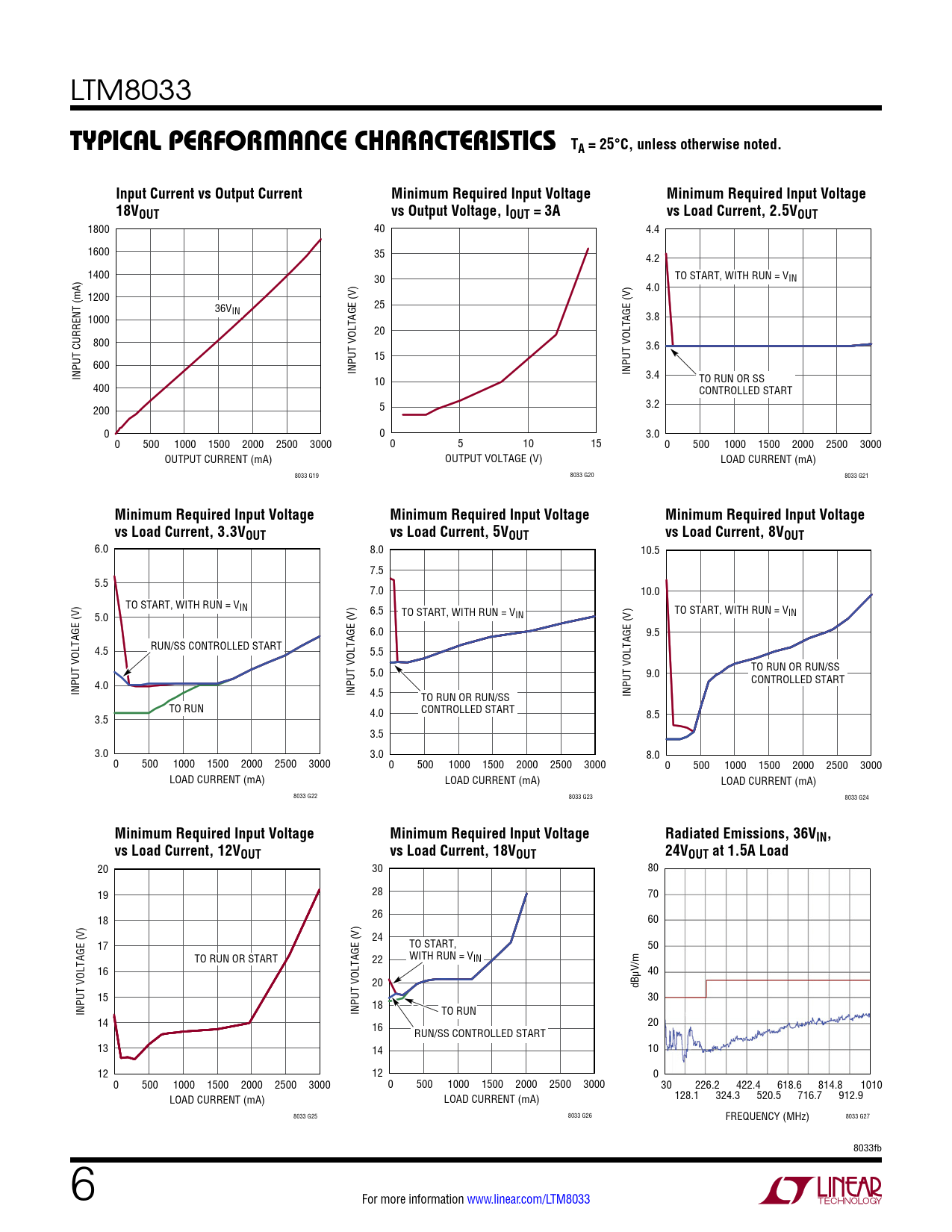

TYPICAL PERFORMANCE CHARACTERISTICS TA = 25°C, unless otherwise noted. Input Current vs Output Current
TYPICAL PERFORMANCE CHARACTERISTICS TA = 25°C, unless otherwise noted Input Current vs Output Current
LTM8033
TYPICAL PERFORMANCE CHARACTERISTICS TA = 25°C, unless otherwise noted. Input Current vs Output Current Minimum Required Input Voltage Minimum Required Input Voltage 18VOUT vs Output Voltage, IOUT = 3A vs Load Current, 2.5VOUT
1800 40 4.4 1600 35 4.2 1400 30 TO START, WITH RUN = VIN 4.0 1200 36V 25 IN 1000 3.8 20 800 3.6 15 600 INPUT CURRENT (mA) INPUT VOLTAGE (V) INPUT VOLTAGE (V) 3.4 TO RUN OR SS 400 10 CONTROLLED START 200 5 3.2 0 0 3.0 0 500 1000 1500 2000 2500 3000 0 5 10 15 0 500 1000 1500 2000 2500 3000 OUTPUT CURRENT (mA) OUTPUT VOLTAGE (V) LOAD CURRENT (mA) 8033 G19 8033 G20 8033 G21
Minimum Required Input Voltage Minimum Required Input Voltage Minimum Required Input Voltage vs Load Current, 3.3VOUT vs Load Current, 5VOUT vs Load Current, 8VOUT
6.0 8.0 10.5 7.5 5.5 7.0 10.0 TO START, WITH RUN = VIN TO START, WITH RUN = V 5.0 6.5 TO START, WITH RUN = VIN IN 6.0 9.5 4.5 RUN/SS CONTROLLED START 5.5 5.0 9.0 TO RUN OR RUN/SS CONTROLLED START INPUT VOLTAGE (V) 4.0 INPUT VOLTAGE (V) 4.5 TO RUN OR RUN/SS INPUT VOLTAGE (V) TO RUN CONTROLLED START 3.5 4.0 8.5 3.5 3.0 3.0 8.0 0 500 1000 1500 2000 2500 3000 0 500 1000 1500 2000 2500 3000 0 500 1000 1500 2000 2500 3000 LOAD CURRENT (mA) LOAD CURRENT (mA) LOAD CURRENT (mA) 8033 G22 8033 G23 8033 G24
Minimum Required Input Voltage Minimum Required Input Voltage Radiated Emissions, 36VIN, vs Load Current, 12VOUT vs Load Current, 18VOUT 24VOUT at 1.5A Load
20 30 80 19 28 70 18 26 60 24 17 TO START, 50 TO RUN OR START 22 WITH RUN = VIN 16 40 20 dBµV/m 15 30 INPUT VOLTAGE (V) INPUT VOLTAGE (V) 18 TO RUN 14 16 20 RUN/SS CONTROLLED START 13 14 10 12 12 0 0 500 1000 1500 2000 2500 3000 0 500 1000 1500 2000 2500 3000 30 226.2 422.4 618.6 814.8 1010 LOAD CURRENT (mA) LOAD CURRENT (mA) 128.1 324.3 520.5 716.7 912.9 8033 G25 8033 G26 FREQUENCY (MHz) 8033 G27 8033fb 6 For more information www.linear.com/LTM8033 Document Outline Features Applications Description Typical Application Absolute Maximum Ratings Pin Configuration Order Information Electrical Characteristics Typical Performance Characteristics Pin Functions Block Diagram Operation Applications Information Typical Applications Package Description Package Photographs Revision History Typical Application Related Parts
