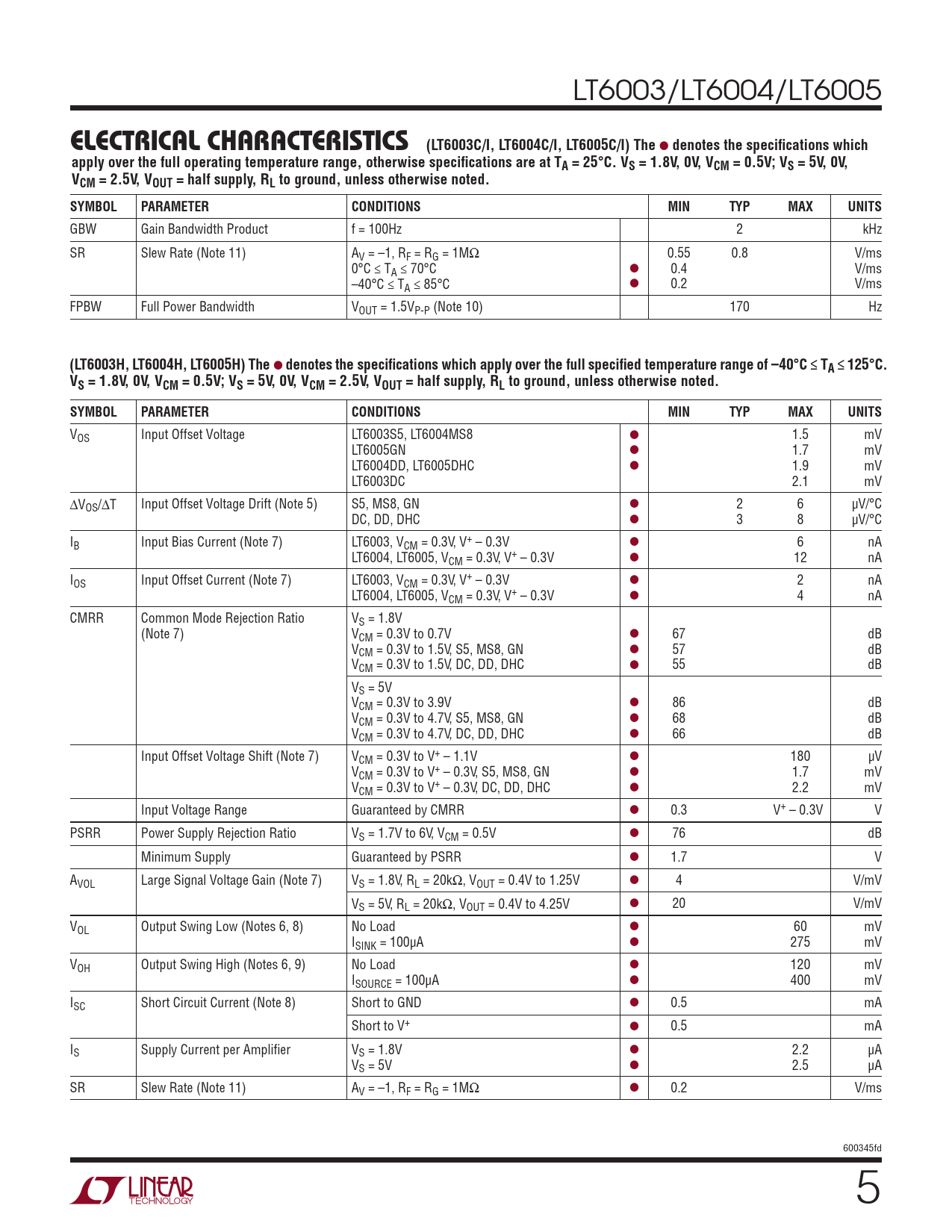

Pages / Page20 / 5 — ELECTRICAL CHARACTERISTICS. (LT6003C/I, LT6004C/I, LT6005C/I) The. …
ELECTRICAL CHARACTERISTICS. (LT6003C/I, LT6004C/I, LT6005C/I) The. denotes the specifications which
ELECTRICAL CHARACTERISTICS (LT6003C/I, LT6004C/I, LT6005C/I) The denotes the specifications which
LT6003/LT6004/LT6005
l
denotes the specifications which apply over the full operating temperature range, otherwise specifications are at TA = 25°C. VS = 1.8V, 0V, VCM = 0.5V; VS = 5V, 0V, VCM = 2.5V, VOUT = half supply, RL to ground, unless otherwise noted. SYMBOL PARAMETER CONDITIONS MIN TYP MAX UNITS
GBW Gain Bandwidth Product f = 100Hz 2 kHz SR Slew Rate (Note 11) AV = –1, RF = RG = 1MΩ 0.55 0.8 V/ms 0°C ≤ TA ≤ 70°C l 0.4 V/ms –40°C ≤ TA ≤ 85°C l 0.2 V/ms FPBW Full Power Bandwidth VOUT = 1.5VP-P (Note 10) 170 Hz
(LT6003H, LT6004H, LT6005H) The
l
denotes the specifications which apply over the full specified temperature range of –40°C ≤ TA ≤ 125°C. VS = 1.8V, 0V, VCM = 0.5V; VS = 5V, 0V, VCM = 2.5V, VOUT = half supply, RL to ground, unless otherwise noted. SYMBOL PARAMETER CONDITIONS MIN TYP MAX UNITS
VOS Input Offset Voltage LT6003S5, LT6004MS8 l 1.5 mV LT6005GN l 1.7 mV LT6004DD, LT6005DHC l 1.9 mV LT6003DC 2.1 mV ΔVOS/ΔT Input Offset Voltage Drift (Note 5) S5, MS8, GN l 2 6 µV/°C DC, DD, DHC l 3 8 µV/°C IB Input Bias Current (Note 7) LT6003, VCM = 0.3V, V+ – 0.3V l 6 nA LT6004, LT6005, VCM = 0.3V, V+ – 0.3V l 12 nA IOS Input Offset Current (Note 7) LT6003, VCM = 0.3V, V+ – 0.3V l 2 nA LT6004, LT6005, VCM = 0.3V, V+ – 0.3V l 4 nA CMRR Common Mode Rejection Ratio VS = 1.8V (Note 7) VCM = 0.3V to 0.7V l 67 dB VCM = 0.3V to 1.5V, S5, MS8, GN l 57 dB VCM = 0.3V to 1.5V, DC, DD, DHC l 55 dB VS = 5V VCM = 0.3V to 3.9V l 86 dB VCM = 0.3V to 4.7V, S5, MS8, GN l 68 dB VCM = 0.3V to 4.7V, DC, DD, DHC l 66 dB Input Offset Voltage Shift (Note 7) VCM = 0.3V to V+ – 1.1V l 180 µV VCM = 0.3V to V+ – 0.3V, S5, MS8, GN l 1.7 mV VCM = 0.3V to V+ – 0.3V, DC, DD, DHC l 2.2 mV Input Voltage Range Guaranteed by CMRR l 0.3 V+ – 0.3V V PSRR Power Supply Rejection Ratio VS = 1.7V to 6V, VCM = 0.5V l 76 dB Minimum Supply Guaranteed by PSRR l 1.7 V AVOL Large Signal Voltage Gain (Note 7) VS = 1.8V, RL = 20kΩ, VOUT = 0.4V to 1.25V l 4 V/mV VS = 5V, RL = 20kΩ, VOUT = 0.4V to 4.25V l 20 V/mV VOL Output Swing Low (Notes 6, 8) No Load l 60 mV ISINK = 100µA l 275 mV VOH Output Swing High (Notes 6, 9) No Load l 120 mV ISOURCE = 100µA l 400 mV ISC Short Circuit Current (Note 8) Short to GND l 0.5 mA Short to V+ l 0.5 mA IS Supply Current per Amplifier VS = 1.8V l 2.2 µA VS = 5V l 2.5 µA SR Slew Rate (Note 11) AV = –1, RF = RG = 1MΩ l 0.2 V/ms 600345fd 5
