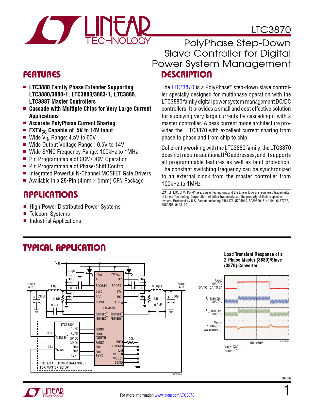

LTC3870 PolyPhase Step-Down Slave Controller for Digital Power System Management
FeaTures DescripTion
n
LTC3880 Family Phase Extender Supporting
The LTC®3870 is a PolyPhase® step-down slave control-
LTC3880/3880-1, LTC3883/3883-1, LTC3886,
ler specially designed for multiphase operation with the
LTC3887 Master Controllers
LTC3880 family digital power system management DC/DC n
Cascade with Multiple Chips for Very Large Current
controllers. It provides a small and cost effective solution
Applications
for supplying very large currents by cascading it with a n
Accurate PolyPhase Current Sharing
master controller. A peak current mode architecture pro- n
EXTVCC Capable of 5V to 14V Input
vides the LTC3870 with excellent current sharing from n Wide VIN Range: 4.5V to 60V phase to phase and from chip to chip. n Wide Output Voltage Range : 0.5V to 14V Coherently working with the LTC3880 family, the LTC3870 n Wide SYNC Frequency Range: 100kHz to 1MHz does not require additional I2C addresses, and it supports n Pin Programmable of CCM/DCM Operation all programmable features as well as fault protection. n Pin Programmable of Phase-Shift Control The constant switching frequency can be synchronized n Integrated Powerful N-Channel MOSFET Gate Drivers to an external clock from the master controller from n Available in a 28-Pin (4mm × 5mm) QFN Package 100kHz to 1MHz.

Typical applicaTion Load Transient Response of a 2-Phase Master (3880)/Slave
VIN
(3870) Converter
