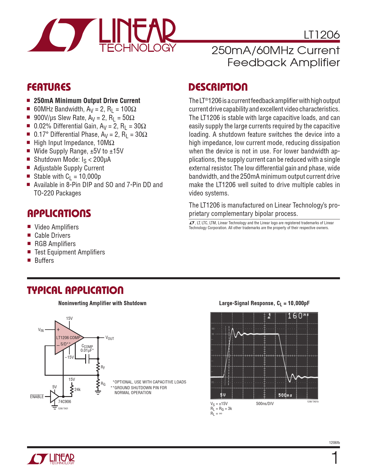

LT1206 250mA/60MHz Current Feedback Amplifier
FeaTures DescripTion
n
250mA Minimum Output Drive Current
The LT®1206 is a current feedback amplifier with high output n 60MHz Bandwidth, AV = 2, RL = 100Ω current drive capability and excellent video characteristics. n 900V/µs Slew Rate, AV = 2, RL = 50Ω The LT1206 is stable with large capacitive loads, and can n 0.02% Differential Gain, AV = 2, RL = 30Ω easily supply the large currents required by the capacitive n 0.17° Differential Phase, AV = 2, RL = 30Ω loading. A shutdown feature switches the device into a n High Input Impedance, 10MΩ high impedance, low current mode, reducing dissipation n Wide Supply Range, ±5V to ±15V when the device is not in use. For lower bandwidth ap- n Shutdown Mode: IS < 200µA plications, the supply current can be reduced with a single n Adjustable Supply Current external resistor. The low differential gain and phase, wide n Stable with CL = 10,000p bandwidth, and the 250mA minimum output current drive n Available in 8-Pin DIP and SO and 7-Pin DD and make the LT1206 well suited to drive multiple cables in TO-220 Packages video systems. The LT1206 is manufactured on Linear Technology’s pro-
applicaTions
prietary complementary bipolar process. L, LT, LTC, LTM, Linear Technology and the Linear logo are registered trademarks of Linear n Video Amplifiers Technology Corporation. All other trademarks are the property of their respective owners. n Cable Drivers n RGB Amplifiers n Test Equipment Amplifiers n Buffers
Typical applicaTion Noninverting Amplifier with Shutdown Large-Signal Response, CL = 10,000pF
15V VIN + LT1206 COMP VOUT – S/D** CCOMP 0.01µF* –15V RF 15V R OPTIONAL, USE WITH CAPACITIVE LOADS * G 5V 24k GROUND SHUTDOWN PIN FOR **NORMAL OPERATION ENABLE 74C906 VS = ±15V 500ns/DIV 1206 TA01b 1206 TA01 RL = RG = 3k RL = ∞ 1206fb 1 Document Outline Features Applications Description Typical Application Absolute Maximum Ratings Pin Configuration Order Information Electrical Characteristics Small-Signal Bandwidth Typical Performance Characteristics Simplified Schematic Applications Information Package Description Revision History Related Parts
