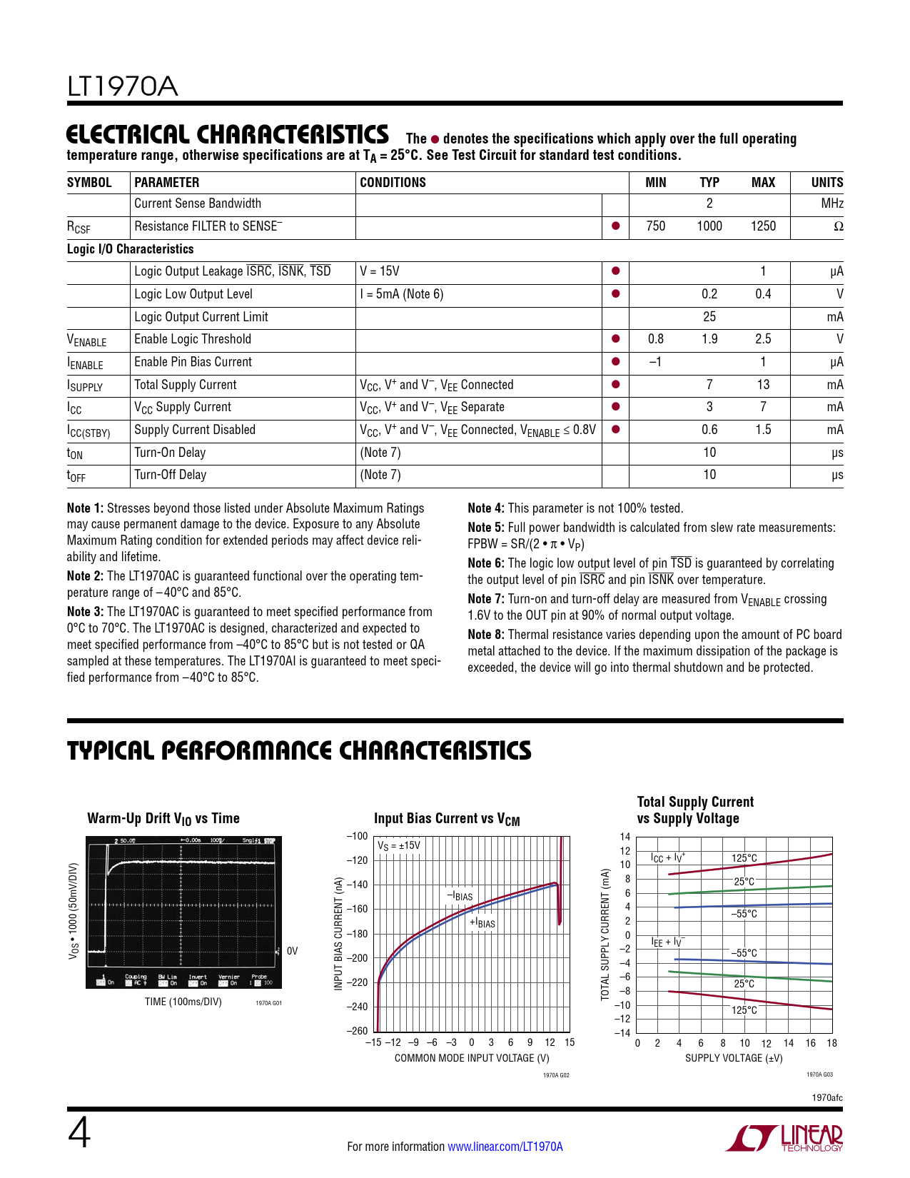

elecTrical characTerisTics. The. denotes the specifications which apply over the full operating
elecTrical characTerisTics The denotes the specifications which apply over the full operating
LT1970A
l
denotes the specifications which apply over the full operating temperature range, otherwise specifications are at TA = 25°C. See Test Circuit for standard test conditions. SYMBOL PARAMETER CONDITIONS MIN TYP MAX UNITS
Current Sense Bandwidth 2 MHz RCSF Resistance FILTER to SENSE– l 750 1000 1250 Ω
Logic I/O Characteristics
Logic Output Leakage ISRC, ISNK, TSD V = 15V l 1 µA Logic Low Output Level I = 5mA (Note 6) l 0.2 0.4 V Logic Output Current Limit 25 mA VENABLE Enable Logic Threshold l 0.8 1.9 2.5 V IENABLE Enable Pin Bias Current l –1 1 µA ISUPPLY Total Supply Current VCC, V+ and V–, VEE Connected l 7 13 mA ICC VCC Supply Current VCC, V+ and V–, VEE Separate l 3 7 mA ICC(STBY) Supply Current Disabled VCC, V+ and V–, VEE Connected, VENABLE ≤ 0.8V l 0.6 1.5 mA tON Turn-On Delay (Note 7) 10 µs tOFF Turn-Off Delay (Note 7) 10 µs

Typical perForMance characTerisTics Total Supply Current Warm-Up Drift VIO vs Time Input Bias Current vs VCM vs Supply Voltage
–100 14 VS = ±15V 12 + –120 I 125°C 10 CC + IV –140 8 25°C –IBIAS 6 –160 4 –55°C +IBIAS 2 • 1000 (50mV/DIV) –180 0 I – EE + IV 0V –2 V OS –200 –55°C –4 –6 INPUT BIAS CURRENT (nA) –220 25°C –8 TIME (100ms/DIV) TOTAL SUPPLY CURRENT (mA) 1970A G01 –240 –10 125°C –12 –260 –14 –15 –12 –9 –6 –3 0 3 6 9 12 15 0 2 4 6 8 10 12 14 16 18 COMMON MODE INPUT VOLTAGE (V) SUPPLY VOLTAGE (±V) 1970A G02 1970A G03 1970afc 4 For more information www.linear.com/LT1970A Document Outline Features Applications Description Typical Application Absolute Maximum Ratings Pin Configuration Order Information Electrical Characteristics Typical Performance Characteristics Pin Functions Block Diagram And Test Circuit Applications Information Package Description Applications Information Related Parts
