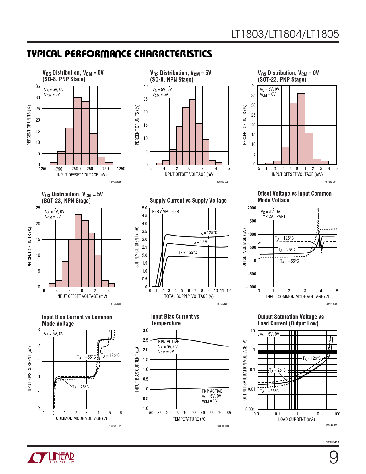

Pages / Page20 / 9 — TYPICAL PERFOR A CE CHARACTERISTICS. VOS Distribution, VCM = 0V. VOS …
File Format / SizePDF / 411 Kb
TYPICAL PERFOR A CE CHARACTERISTICS. VOS Distribution, VCM = 0V. VOS Distribution, VCM = 5V. (SO-8, PNP Stage)
TYPICAL PERFOR A CE CHARACTERISTICS VOS Distribution, VCM = 0V VOS Distribution, VCM = 5V (SO-8, PNP Stage)
LT1803/LT1804/LT1805
W U TYPICAL PERFOR A CE CHARACTERISTICS VOS Distribution, VCM = 0V VOS Distribution, VCM = 5V VOS Distribution, VCM = 0V (SO-8, PNP Stage) (SO-8, NPN Stage) (SOT-23, PNP Stage)
35 30 40 VS = 5V, 0V VS = 5V, 0V VS = 5V, 0V VCM = 0V VCM = 5V 35 VCM = 0V 30 25 30 25 20 25 20 15 20 15 15 10 PERCENT OF UNITS (%) 10 PERCENT OF UNITS (%) PERCENT OF UNITS (%) 10 5 5 5 0 0 0 –1250 –750 –250 0 250 750 1250 –6 –4 –2 0 2 4 6 – 5 – 4 – 3 – 2 –1 0 1 2 3 4 5 INPUT OFFSET VOLTAGE (µV) INPUT OFFSET VOLTAGE (mV) INPUT OFFSET VOLTAGE (mV) 180345 G01 180345 G02 180345 G03
V Offset Voltage vs Input Common OS Distribution, VCM = 5V (SOT-23, NPN Stage) Supply Current vs Supply Voltage Mode Voltage
25 5.0 2000 V PER AMPLIFIER V S = 5V, 0V S = 5V, 0V V 4.5 TYPICAL PART CM = 5V 1500 20 4.0 3.5 TA = 125°C µV) 1000 15 3.0 TA = 125°C TA = 25°C 2.5 500 T T A = 25°C 10 2.0 A = –55°C 0 T 1.5 A = –55°C PERCENT OF UNITS (%) SUPPLY CURRENT (mA) OFFSET VOLTAGE ( 5 1.0 –500 0.5 0 0 –1000 –6 –4 –2 0 2 4 6 0 1 2 3 4 5 6 7 8 9 10 11 12 0 1 2 3 4 5 INPUT OFFSET VOLTAGE (mV) TOTAL SUPPLY VOLTAGE (V) INPUT COMMON MODE VOLTAGE (V) 180345 G04 180345 G05 180345 G06
