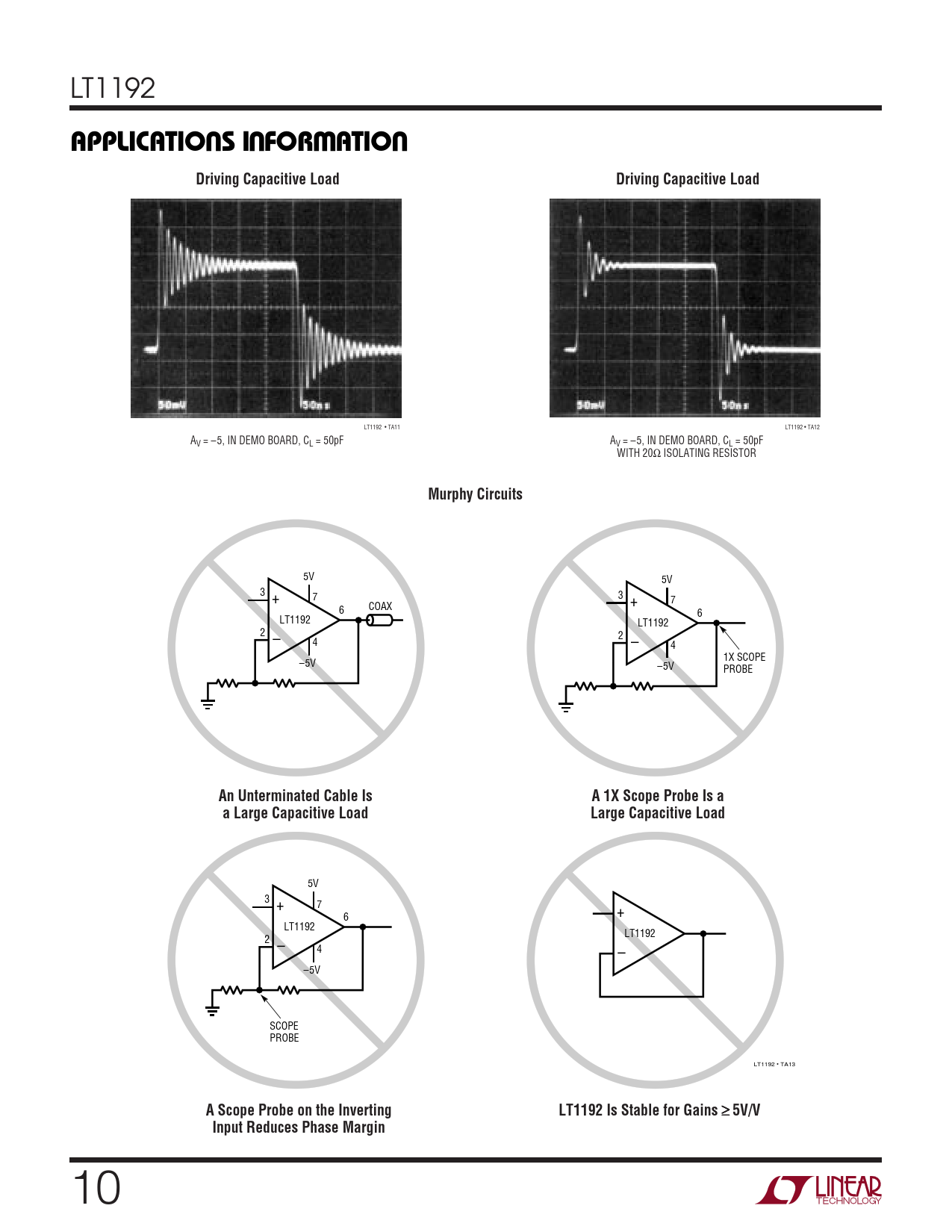

U U W U APPLICATIO S I FOR ATIO Driving Capacitive Load Driving Capacitive Load
LT1192 • TA11 LT1192 • TA12 AV = –5, IN DEMO BOARD, CL = 50pF AV = –5, IN DEMO BOARD, CL = 50pF WITH 20Ω ISOLATING RESISTOR
Murphy Circuits
5V 5V 3 7 3 + + 7 COAX 6 6 LT1192 LT1192 2 2 – 4 – 4 1X SCOPE –5V –5V PROBE
An Unterminated Cable Is A 1X Scope Probe Is a a Large Capacitive Load Large Capacitive Load
5V 3 + 7 + 6 LT1192 LT1192 2 – 4 – –5V SCOPE PROBE LT1192 • TA13
A Scope Probe on the Inverting LT1192 Is Stable for Gains
5V/V Input Reduces Phase Margin
