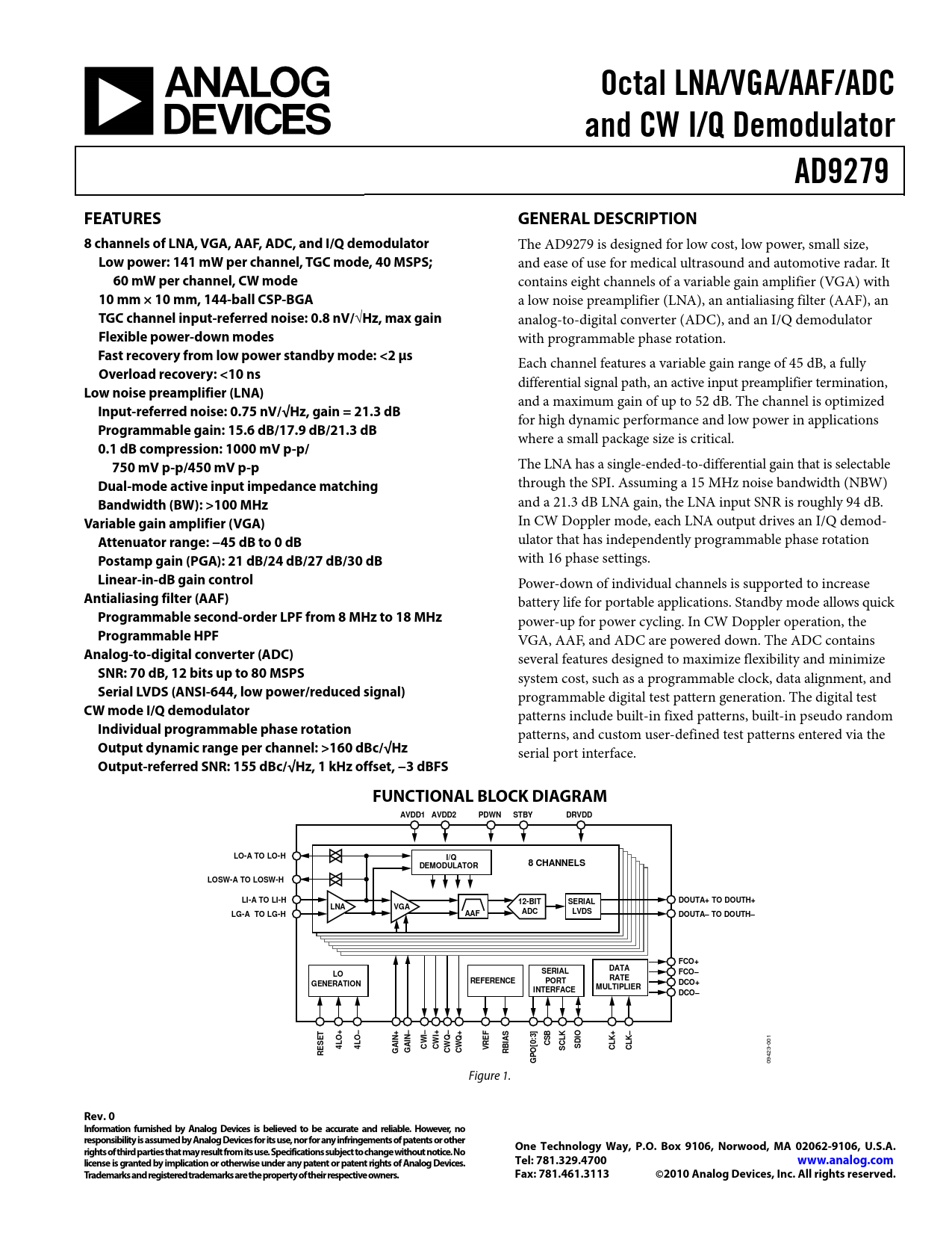

Octal LNA/VGA/AAF/ADC and CW I/Q Demodulator AD9279 FEATURES GENERAL DESCRIPTION 8 channels of LNA, VGA, AAF, ADC, and I/Q demodulator
The AD9279 is designed for low cost, low power, small size,
Low power: 141 mW per channel, TGC mode, 40 MSPS;
and ease of use for medical ultrasound and automotive radar. It
60 mW per channel, CW mode
contains eight channels of a variable gain amplifier (VGA) with
10 mm × 10 mm, 144-ball CSP-BGA
a low noise preamplifier (LNA), an antialiasing filter (AAF), an
TGC channel input-referred noise: 0.8 nV/√Hz, max gain
analog-to-digital converter (ADC), and an I/Q demodulator
Flexible power-down modes
with programmable phase rotation.
Fast recovery from low power standby mode: <2 μs
Each channel features a variable gain range of 45 dB, a fully
Overload recovery: <10 ns
differential signal path, an active input preamplifier termination,
Low noise preamplifier (LNA)
and a maximum gain of up to 52 dB. The channel is optimized
Input-referred noise: 0.75 nV/√Hz, gain = 21.3 dB
for high dynamic performance and low power in applications
Programmable gain: 15.6 dB/17.9 dB/21.3 dB
where a small package size is critical.
0.1 dB compression: 1000 mV p-p/ 750 mV p-p/450 mV p-p
The LNA has a single-ended-to-differential gain that is selectable
Dual-mode active input impedance matching
through the SPI. Assuming a 15 MHz noise bandwidth (NBW)
Bandwidth (BW): >100 MHz
and a 21.3 dB LNA gain, the LNA input SNR is roughly 94 dB.
Variable gain amplifier (VGA)
In CW Doppler mode, each LNA output drives an I/Q demod-
Attenuator range: −45 dB to 0 dB
ulator that has independently programmable phase rotation
Postamp gain (PGA): 21 dB/24 dB/27 dB/30 dB
with 16 phase settings.
Linear-in-dB gain control
Power-down of individual channels is supported to increase
Antialiasing filter (AAF)
battery life for portable applications. Standby mode allows quick
Programmable second-order LPF from 8 MHz to 18 MHz
power-up for power cycling. In CW Doppler operation, the
Programmable HPF
VGA, AAF, and ADC are powered down. The ADC contains
Analog-to-digital converter (ADC)
several features designed to maximize flexibility and minimize
SNR: 70 dB, 12 bits up to 80 MSPS
system cost, such as a programmable clock, data alignment, and
Serial LVDS (ANSI-644, low power/reduced signal)
programmable digital test pattern generation. The digital test
CW mode I/Q demodulator
patterns include built-in fixed patterns, built-in pseudo random
Individual programmable phase rotation
patterns, and custom user-defined test patterns entered via the
Output dynamic range per channel: >160 dBc/√Hz
serial port interface.
Output-referred SNR: 155 dBc/√Hz, 1 kHz offset, −3 dBFS FUNCTIONAL BLOCK DIAGRAM AVDD1 AVDD2 PDWN STBY DRVDD LO-A TO LO-H I/Q DEMODULATOR 8 CHANNELS LOSW-A TO LOSW-H LI-A TO LI-H 12-BIT SERIAL DOUTA+ TO DOUTH+ LNA VGA LG-A TO LG-H AAF ADC LVDS DOUTA– TO DOUTH– FCO+ SERIAL DATA LO FCO– REFERENCE PORT RATE GENERATION DCO+ INTERFACE MULTIPLIER DCO– T + + ] + I– I+ B K IO E O O Q Q EF :3 L K– IN IN
