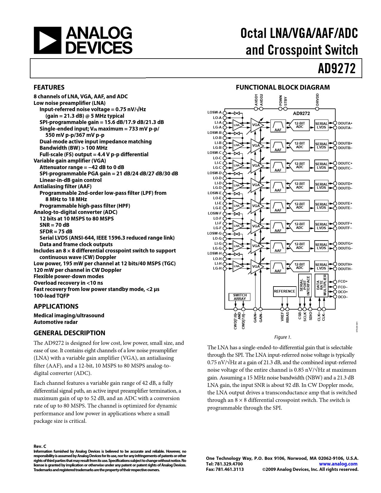

Octal LNA/VGA/AAF/ADC. and Crosspoint Switch. AD9272. FEATURES. FUNCTIONAL BLOCK DIAGRAM. 8 channels of LNA, VGA, AAF, and ADC. DD1
Datasheet AD9272 Analog Devices, Revision: C
Octal LNA/VGA/AAF/ADC and Crosspoint Switch AD9272 FEATURES FUNCTIONAL BLOCK DIAGRAM 8 channels of LNA, VGA, AAF, and ADC N Y DD DD1 DD2 B V Low noise preamplifier (LNA) AV AV PDW ST DR Input-referred noise voltage = 0.75 nV/√Hz LOSW-A AD9272 (gain = 21.3 dB) @ 5 MHz typical LO-A SPI-programmable gain = 15.6 dB/17.9 dB/21.3 dB LI-A 12-BIT DOUTA+ LNA SERIAL VGA Single-ended input; V LG-A ADC LVDS DOUTA– IN maximum = 733 mV p-p/ AAF LOSW-B 550 mV p-p/367 mV p-p LO-B Dual-mode active input impedance matching LI-B 12-BIT DOUTB+ LNA SERIAL VGA Bandwidth (BW) > 100 MHz LG-B ADC LVDS DOUTB– AAF Full-scale (FS) output = 4.4 V p-p differential LOSW-C LO-C Variable gain amplifier (VGA) LI-C 12-BIT SERIAL DOUTC+ Attenuator range = −42 dB to 0 dB LNA VGA LG-C ADC LVDS DOUTC– AAF SPI-programmable PGA gain = 21 dB/24 dB/27 dB/30 dB LOSW-D Linear-in-dB gain control LO-D LI-D 12-BIT VGA SERIAL DOUTD+ Antialiasing filter (AAF) LNA LG-D ADC LVDS DOUTD– AAF Programmable 2nd-order low-pass filter (LPF) from LOSW-E 8 MHz to 18 MHz LO-E LI-E DOUTE+ Programmable high-pass filter (HPF) 12-BIT LNA SERIAL VGA LG-E ADC LVDS DOUTE– Analog-to-digital converter (ADC) AAF LOSW-F 12 bits at 10 MSPS to 80 MSPS LO-F SNR = 70 dB LI-F 12-BIT DOUTF+ LNA SERIAL LG-F VGA ADC LVDS DOUTF– SFDR = 75 dB AAF LOSW-G Serial LVDS (ANSI-644, IEEE 1596.3 reduced range link) LO-G Data and frame clock outputs LI-G 12-BIT DOUTG+ LNA SERIAL VGA LG-G ADC LVDS DOUTG– Includes an 8 × 8 differential crosspoint switch to support AAF LOSW-H continuous wave (CW) Doppler LO-H Low power, 195 mW per channel at 12 bits/40 MSPS (TGC) LI-H 12-BIT DOUTH+ LNA SERIAL VGA ADC 120 mW per channel in CW Doppler LG-H LVDS DOUTH– AAF Flexible power-down modes R L Overload recovery in <10 ns A T A E LIE FCO+ R ACE T RF IP FCO– Fast recovery from low power standby mode, <2 μs SERI PO E DAT RA LT REFERENCE U DCO+ 100-lead TQFP INT SWITCH M DCO– ARRAY APPLICATIONS + + F B K O Medical imaging/ultrasound 0] 0]– E IN IN AS L K+ K AND CS 7: 7: VR SDI SC CL CL Automotive radar GA GA RBI D[ D[

07 Figure 1. The AD9272 is designed for low cost, low power, small size, and The LNA has a single-ended-to-differential gain that is selectable ease of use. It contains eight channels of a low noise preamplifier through the SPI. The LNA input-referred noise voltage is typically (LNA) with a variable gain amplifier (VGA), an antialiasing 0.75 nV/√Hz at a gain of 21.3 dB, and the combined input-referred filter (AAF), and a 12-bit, 10 MSPS to 80 MSPS analog-to- noise voltage of the entire channel is 0.85 nV/√Hz at maximum digital converter (ADC). gain. Assuming a 15 MHz noise bandwidth (NBW) and a 21.3 dB Each channel features a variable gain range of 42 dB, a fully LNA gain, the input SNR is about 92 dB. In CW Doppler mode, differential signal path, an active input preamplifier termination, a the LNA output drives a transconductance amp that is switched maximum gain of up to 52 dB, and an ADC with a conversion through an 8 × 8 differential crosspoint switch. The switch is rate of up to 80 MSPS. The channel is optimized for dynamic programmable through the SPI. performance and low power in applications where a small package size is critical.
